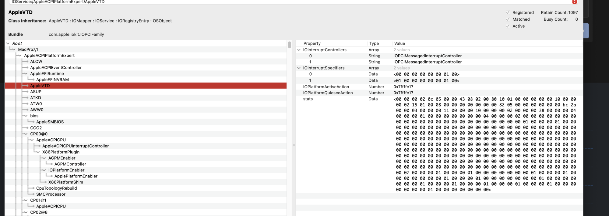

Does AppleVTD shows in IOReg?

AppleVTD does show on IOReg. I haven't tried to see what mode its working on under Linux. I did boot into windows to check if the card was recognized and it was recognized as an ethernet controller. I'll look into how to verify if its in Ethernet mode.

I absolutely have AppleVTD enabled, I also have SIP completely disabled.

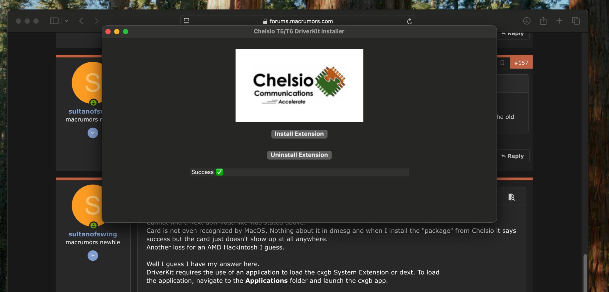

Well this Chelsio T6225-CR I purchased is turning out to be a bust.
Cannot find a kext download like was stated above.

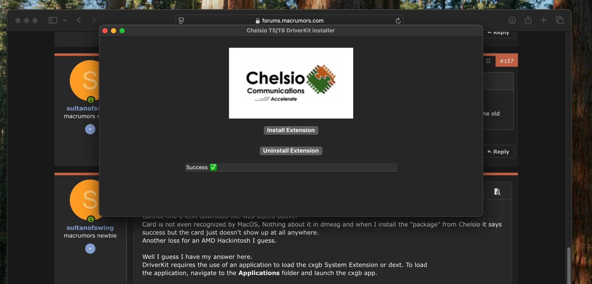

Card is not even recognized by MacOS, Nothing about it in dmesg and when I install the "package" from Chelsio it says success but the card just doesn't show up at all anywhere.
Another loss for an AMD Hackintosh I guess.
Well I guess I have my answer here.
DriverKit requires the use of an application to load the cxgb System Extension or dext. To load
the application, navigate to the Applications folder and launch the cxgb app.
Not sure what else to do as I have ran the app and the extension never shows up in S/L/E

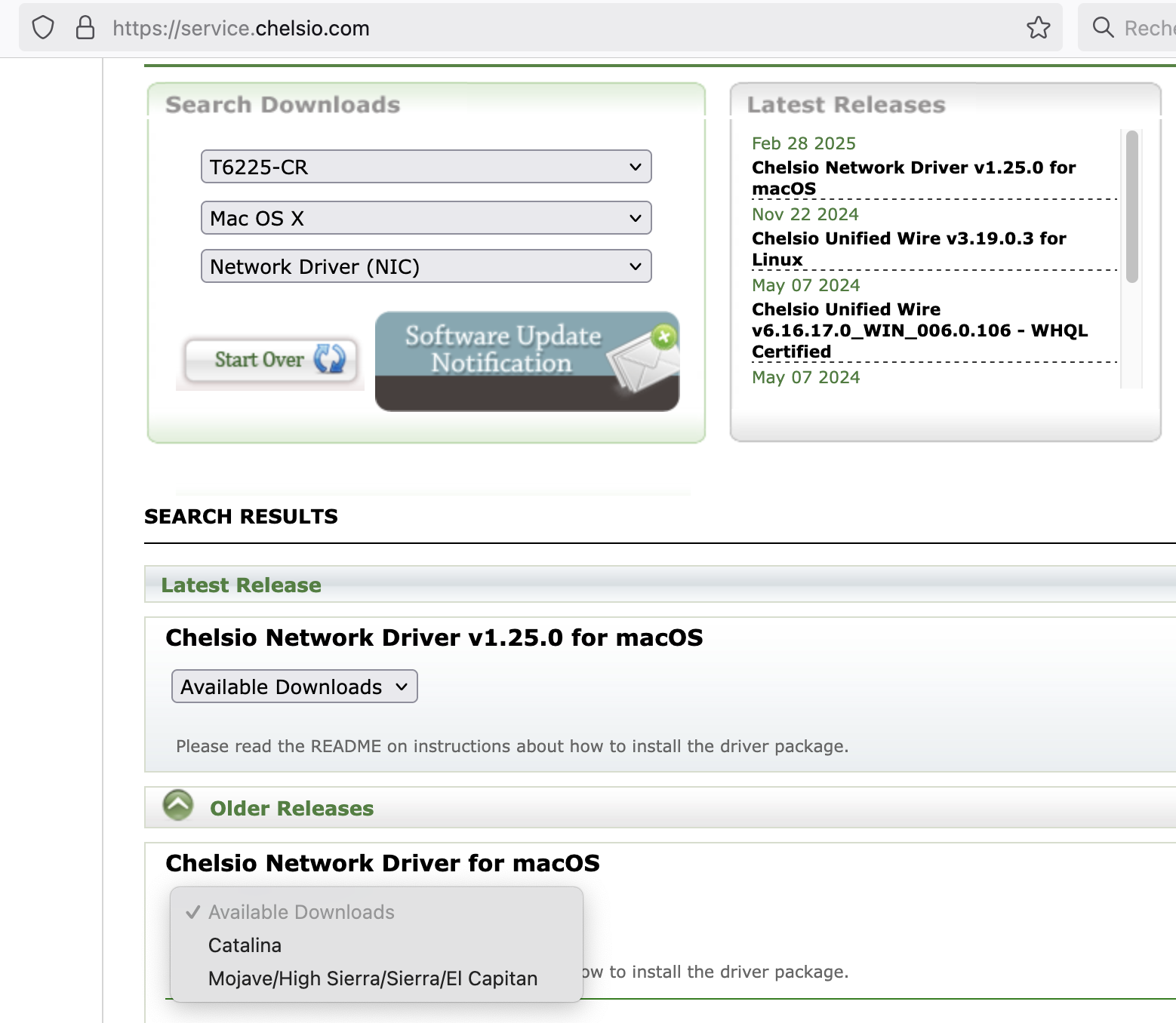

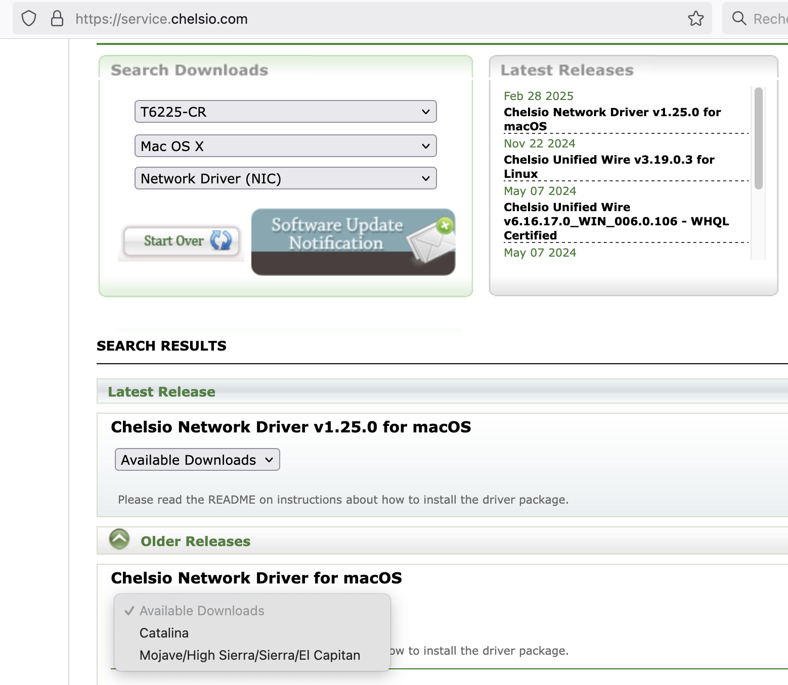

Click on "Older Releases" to find the Catalina driver, which is a KEXT. Its signature has long expired, so I suggest to extract the .kext from the package and place it in your EFI folder so it is loaded by OpenCore "from under" and bypasses macOS checks.

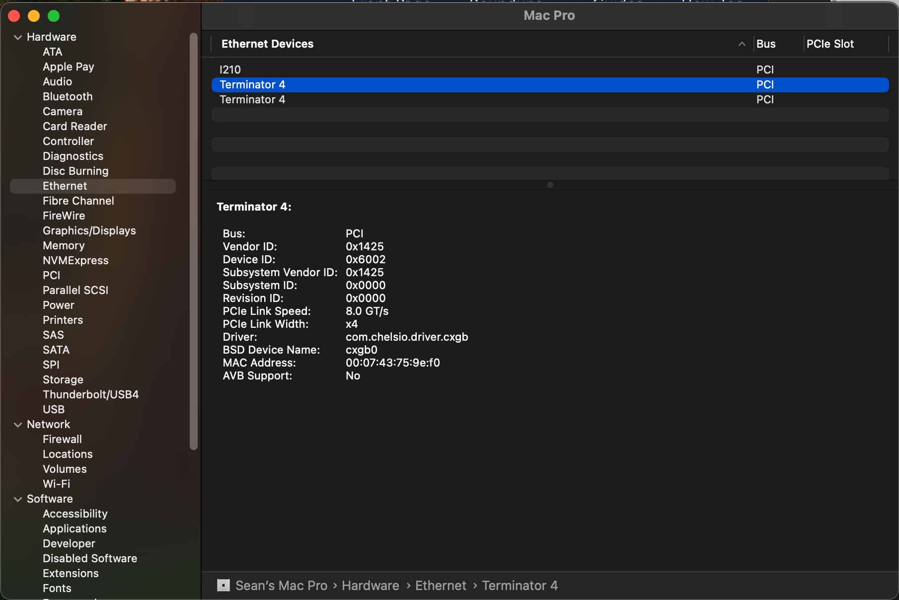

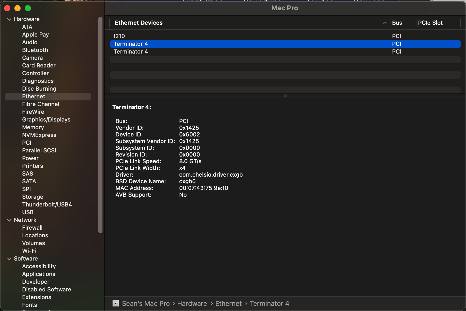

Edit- Got home and got in installed and card is detected, I have it in a 4x slot but still plenty enough to max out the 25gbps connection as it does when I use RDMA in Windows.
