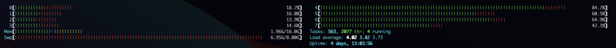

I work on 13", M1, 2020 MacbookPro with 512GB SSD and 16GB DDR4
RAM usage 2GB / SWAP usage 7GB
For some reason hardware is using SSD all the time.
Regardless of how durable the SSD chips are used by Apple, this is a deliberate reduction in SSD lifespan.
What is the purpose of carving an SSD by SWAP, with enough free RAM on board ?
For this statement to be true, you have to demonstrate that any noteworthy lifespan reduction is actually taking place. Even most extreme user reports so far would place expected SSD lifespan at over 10 years, which would be far beyond average life of consumer storage media.
Besides, Apple must be confident that endurance is not a problem with their SSDs. If these machines start dying in bulk three years down the road, they will be hit with an extremely costly class action lawsuit.
You are right, but it cannot be denied that ssd usage is greater and there is one more issue, the speed of access to data from SWAP. I assume that the problem is application that is not native and translated by Rosetta ..
So we have two problems, data access speed and SSD usage.
I don't think that's deliberate, looks like a bug to me.
Currently I have all my work stuff up and running (Safari, Firefox, Sublime Text, two instances of Ruby Mine, MariaDB, Puma, Terminal, Signal and Spotify), with 12 GB used out of 16, memory pressure in green and 91 MB of swap.
Does it mean that you are experiencing performance issues of any kind?
I think there is little doubt that these new Macs use swap differently (more aggressively) than Intel Macs, but there still are so many unclear things… does high swap usage means that things are being actively paged out or is swap simply accumulated? Is it a bug? What are the actual VM statistics?
Next time you se this high swap use, please run vm_stat in the terminal. It could offer some insight.
