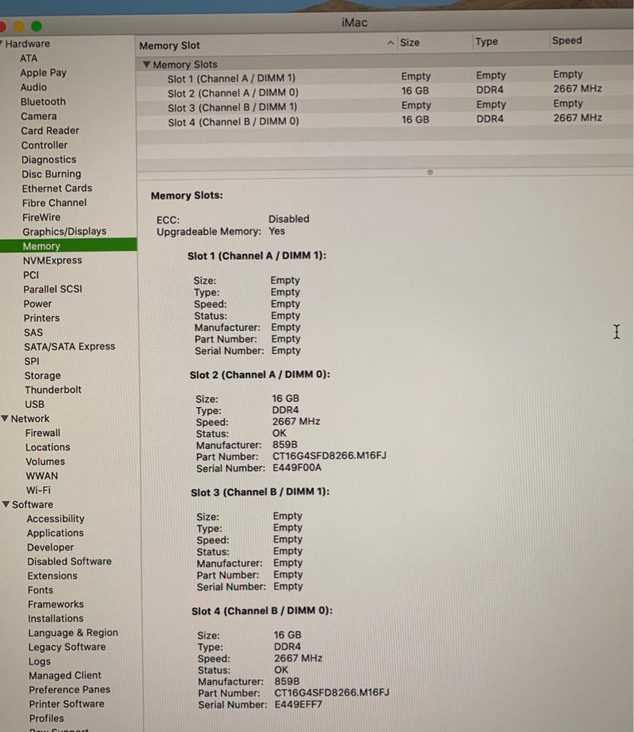

Hi all. I read through this and I’m looking for some advice too. Not sure why I’m sweating these details...but I am :)
i have the tier 3 base config ... I took out the 2 x 4 GB sticks and replaced them with 2 x 16 GB sticks from OWC ... I am seeing the 2667 number and my report shows the RAM in slots 2 and 4 and 2 slots are open.
I teach and spend most of my time in Zoom, screenflow, word, keynote and chrome apps ... whats your advice ? Keep it this way ? Add the Apple RAM back in the 9to5 Mac way ?
thanks

I feel your pain. Your question about the T2 is beyond my level of knowledge, but a few of us have run benchmarks confirming a performance penalty when running both Apple OEM RAM and 3rd party RAM, and which seem to be independent of the particular brand of 3rd party RAM.
Indeed. Just to clarify for others on here. My initial Geekbench test figures ( multicore and singlecore )with the stock 8GB RAM was similar to when I installed the additional 32GB Crucial memory using the 9to5 Mac method totaling 40GB.
However, once I removed the stock 8GB and paired the two 16GB crucial memory modules totaling 32GB my Geekbench scores increased significantly.
Reactions: DrRadon

Interesting. Thanks for sharing this. I wouldn't have though that it would be THAT particular about about RAM. I received my second pair of Crucial RAM yesterday and tried it with the original Apple RAM. I got the same result as the first batch of Crucial I tried with Apple RAM. I'm now using four sticks of Crucial for 32GB at 2667. I did configure it though so that the first pair that I received is in DIMM 0 and the second in DIMM 2. This restored dual channel (vs. Crucial in channel A and Apple in B) and the performance is now as expected.

I have the new i7 8-core model. Came with 8GB. 32GB (2x16) added.
When installed in the order 4-16-4-16 or 16-4-16-4 the system reports 2166MHz memory speed. Geekbench 5 results are 1270 for single-core and 8400 for multi-core.
When installed in the order 16-16-4-4- the system reports 2400MHz memory speed (!). However multi-core Geekbench results drop to 6930 (approx 17% drop). So although the reported speed is higher (although still not 2666MHz), it must be dual-channel memory access that disappears.
With just the 2 x 16GB (Corsair Vengeance 2666MHz) the system reports 2667MHz memory speed and multi-core Geekbench goes to its highest figure of 8900.
What channels should they be in if it's just the 2 x16 ? 1&3 or 2&4 ? does it matter?

I bought 2x16GB Crucial CT2K16G4S266M initially meant for a 2019 iMac. I swapped the iMac for the i7 2020 version since it was released during my return period.
Sadly the RAM runs at 2133MHz on the 2020 iMac when running together with the original Apple RAM Hynix HMA851S6DJR6N. They ran on the expected speed on the 2019 iMac though. Let me know if you have any better luck @DrRadon.
Is there a free version of Geekbench or do you have to buy a license @Limeybastid?
I used the free version to check my figures.
In regards to your installation of the memory, did try using the 9to5 Mac method ? That will be probably get your ram clock speed back to normal but remove the dual channel capability like we’ve discovered.

Just installed OWC 32GB and I also get 2133mhz when leaving in the Apple ram. So what is everyone’s final decision who isn’t buying new ram? My assumption is it’s better to have 40gb at 2133 than just the 32GB at 2666 and putting the Apple memory in a drawer. Thoughts?
That will be my situation. I ordered 16gb with it...but I already have sx16 =32GB RAM from OWC that arrived the other day.
Seems like it may be best for now to just leave the 2x16gb but I'm not sure...I've never owned an imac before.

Original slots 2 and 4 are now occupied with just the Crucial 16GB dimms all else empty.

To clarify what I meant about "batches" - the RAM I am using is all Crucial but bought at different times. They have different part numbers and so are different in some way. They are each just what Crucial was selling at that time. And the 2020 iMac is particular between them.
But putting the respective pairs in Slots 1 + 2 and 3 + 4 (rather than the conventional 1 + 3 and 2 + 4) means they run at 2667 MHz and CPU-Z in Windows is showing dual channel is active, which is good enough for me. And Geekbench is scoring around 9000 in macOS on my i7.
