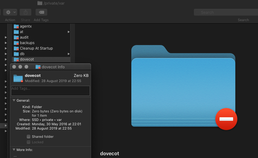

It says 0 Kb because you don't have permissions to know what is inside, if you do have permissions you COULD delete it, since you can't it says 0 Kb
See below what I mean...
I have no permission to look into this Folder, so, as you can see it's 0 KB but I know it's not empty

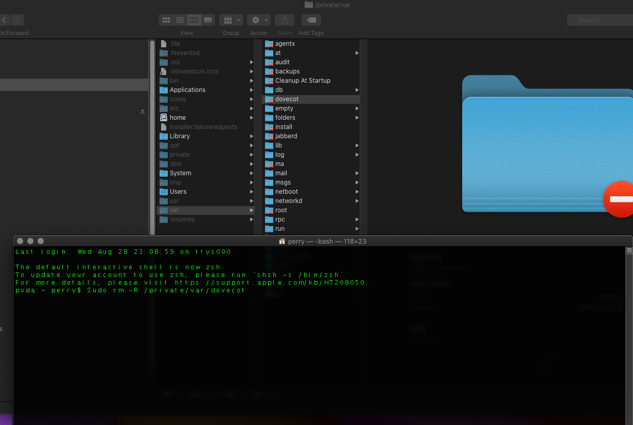

The above was just an example of a Folder, it's not in the Volumes Folder, here's an example how I would delete this Folder, I did not hit return, nor delete it since that could be a problem.
