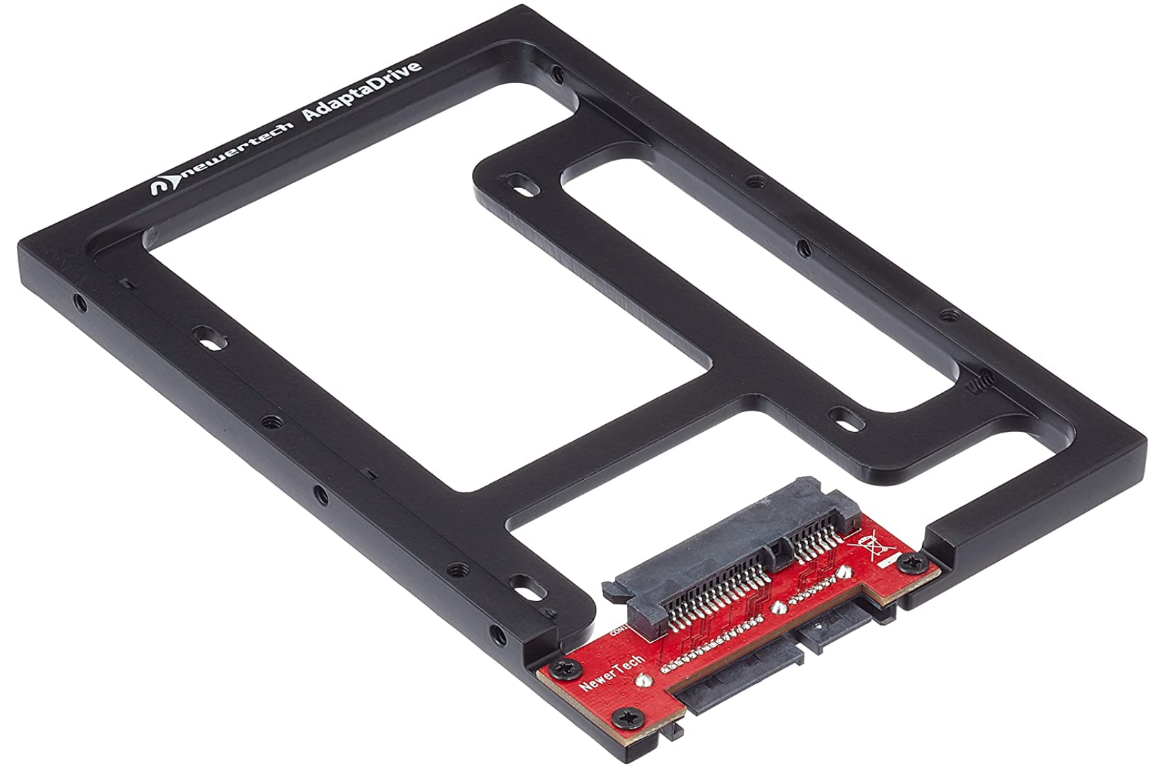

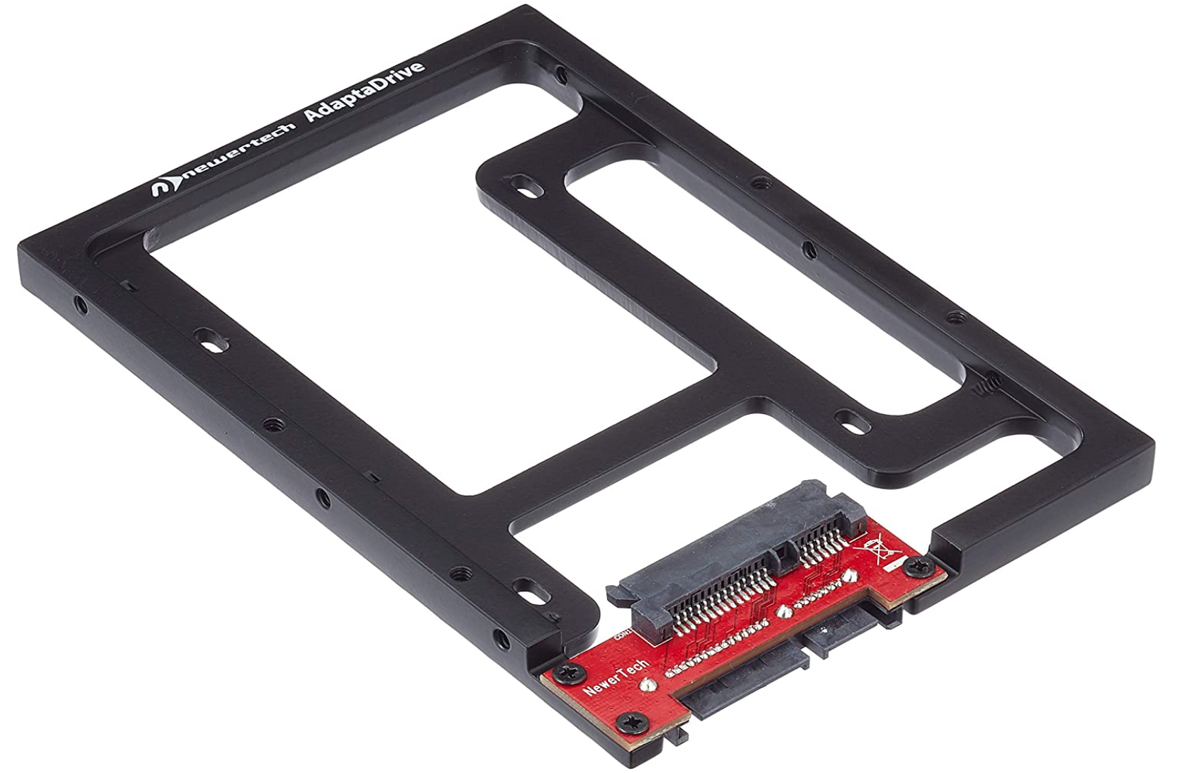

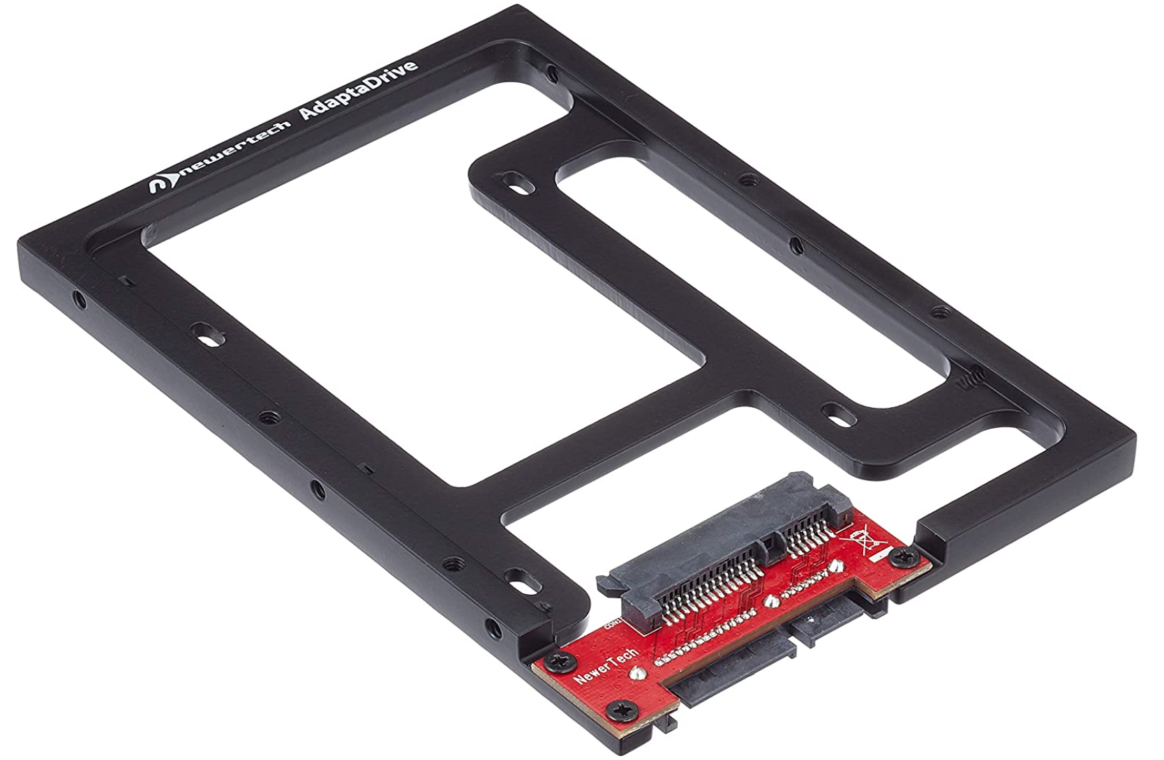

*Any adapter bracket that looks like this works fine. Do you really need one? Well, no—double-stick foam tape works—but you do increase the air circulation and if you have to go back in, it's even faster to change out the drive inside. I do not recommend leaving the old HDD in there, even disconnected. Do the job right.
