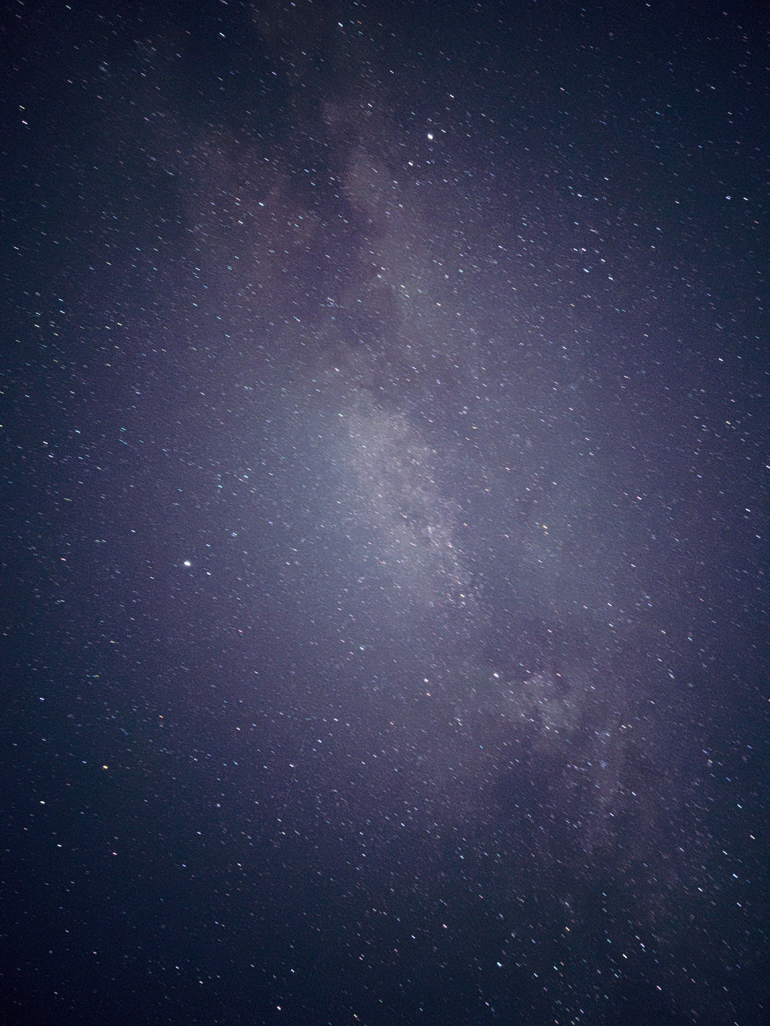

ITS MILKY WAY TIME!!!

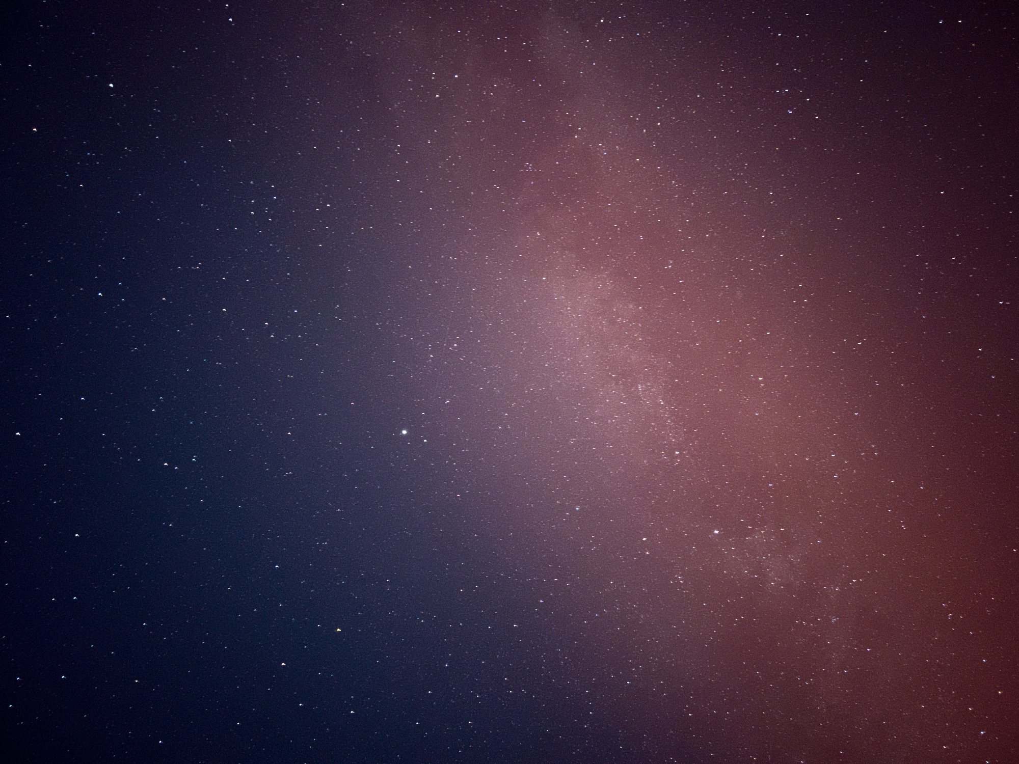

I went to my usual dark sky location to test the iPhone 14 pro max in night mode. I must say the new larger sensor is 4x better than the 13 pro max. The Milky Way looks way more realistic and like a DSLR image……finally! Crazy to see these at ISO 12,500 and 10,000… wow. The max ISO of the new sensor is 12,768! Wow. But the images are clean at that ISO. I’m impressed. My iPhone was tracked on my skywatcher Star Adventurer during the 30” exposure to keep the stars pinpoint.
ProRAW and edited in Lightroom mobile.
Out of camera jpeg, no edit

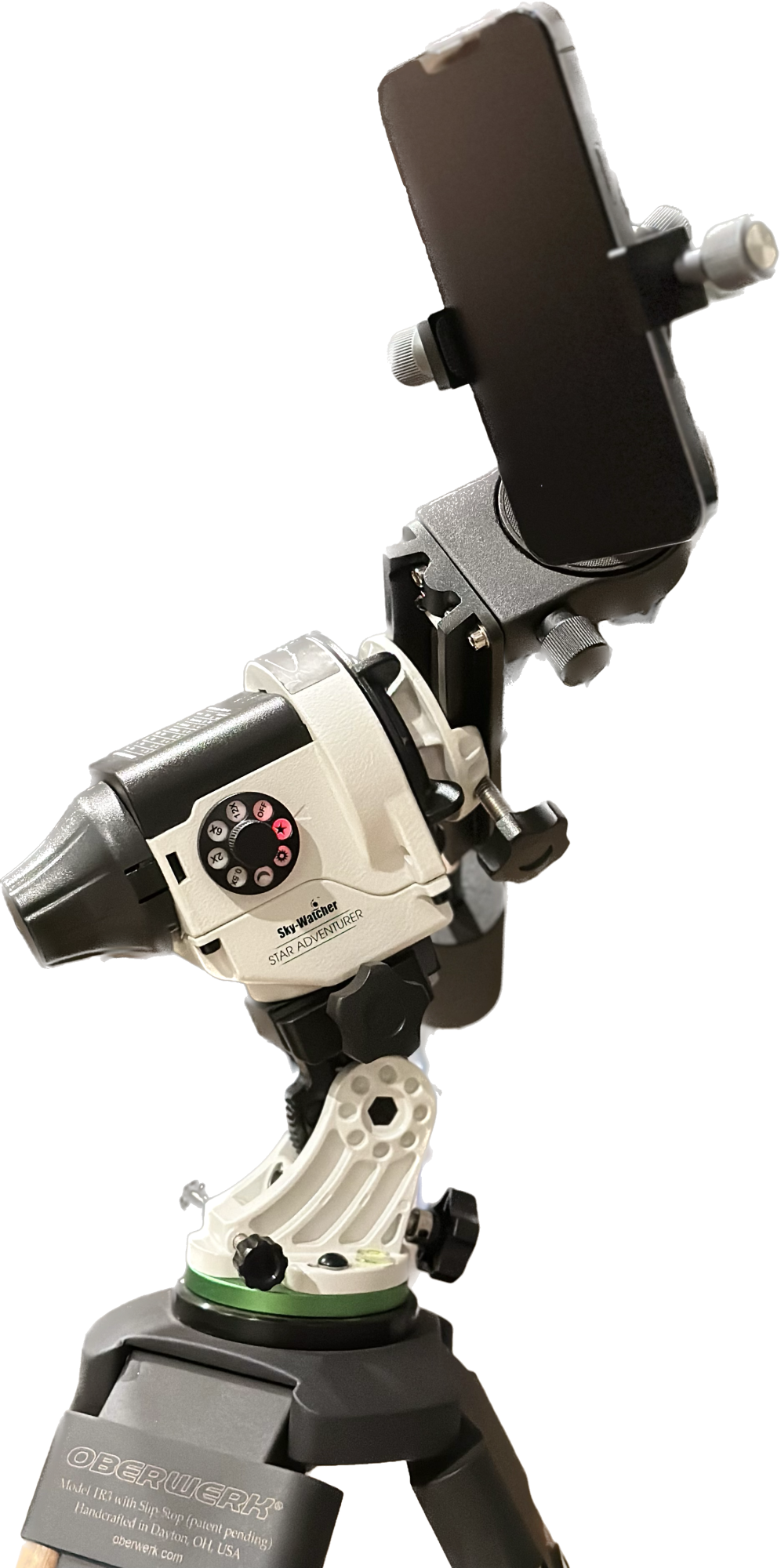

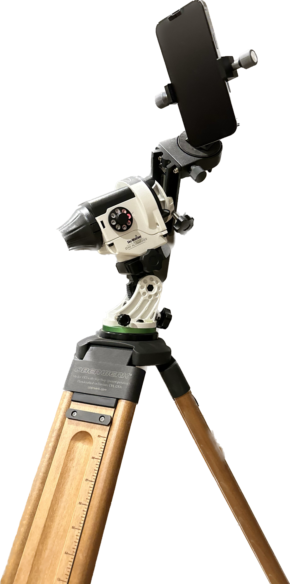

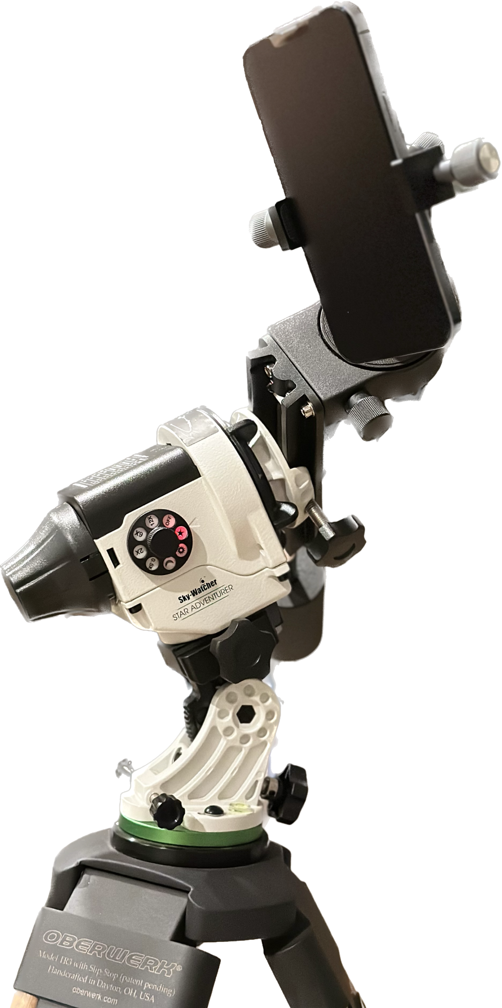

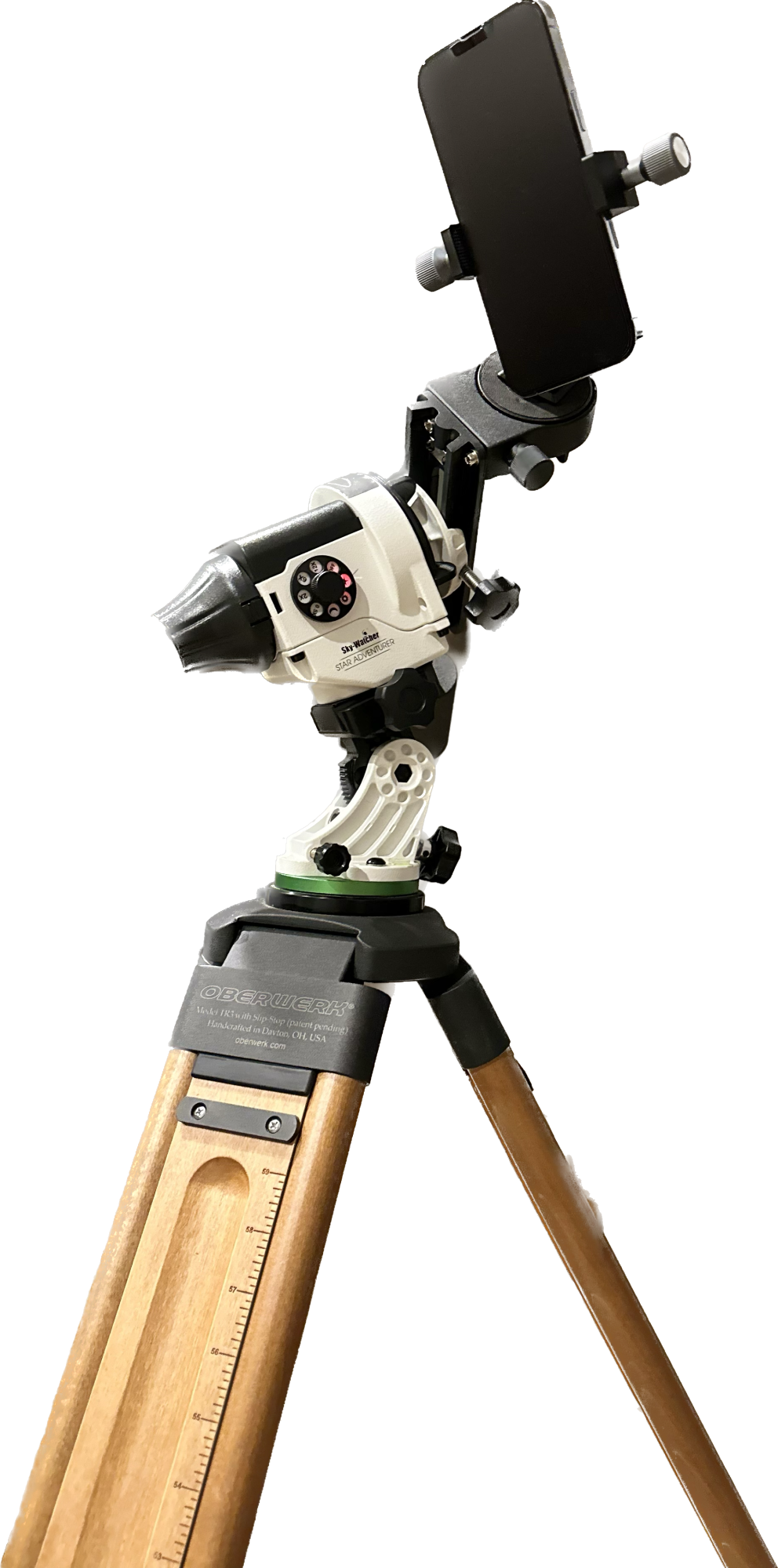

The photo cut and past action is really cool.! Anyway, here’s a photo of my set up. taking mine that this is not necessary to be used but I just use it to keep from getting star trails over 30 seconds of exposure time. otherwise, just a standard tripod will work just fine, he’ll just have a photo with a good Milky Way with some elongated stars when zoomed in at 100%. this is the Skywatcher star adventure. The cell phone bracket I purchased on Amazon also and here is the link for that. It does an OK job I just wish it held the phone a little bit better but it’s made very well.
Metal Smartphone Tripod Adapter for Phone - Universal iPhone Tripod Mount - Fits iPhone 11 13, iPhone 13 Pro, iPhone 13 Pro Max, Samsung - Sturdiest Phone Tripod Mount Attachment https://a.co/d/iW2Ol3a
There are other options. Also, just read the reviews before you get one to see what’s best for you.

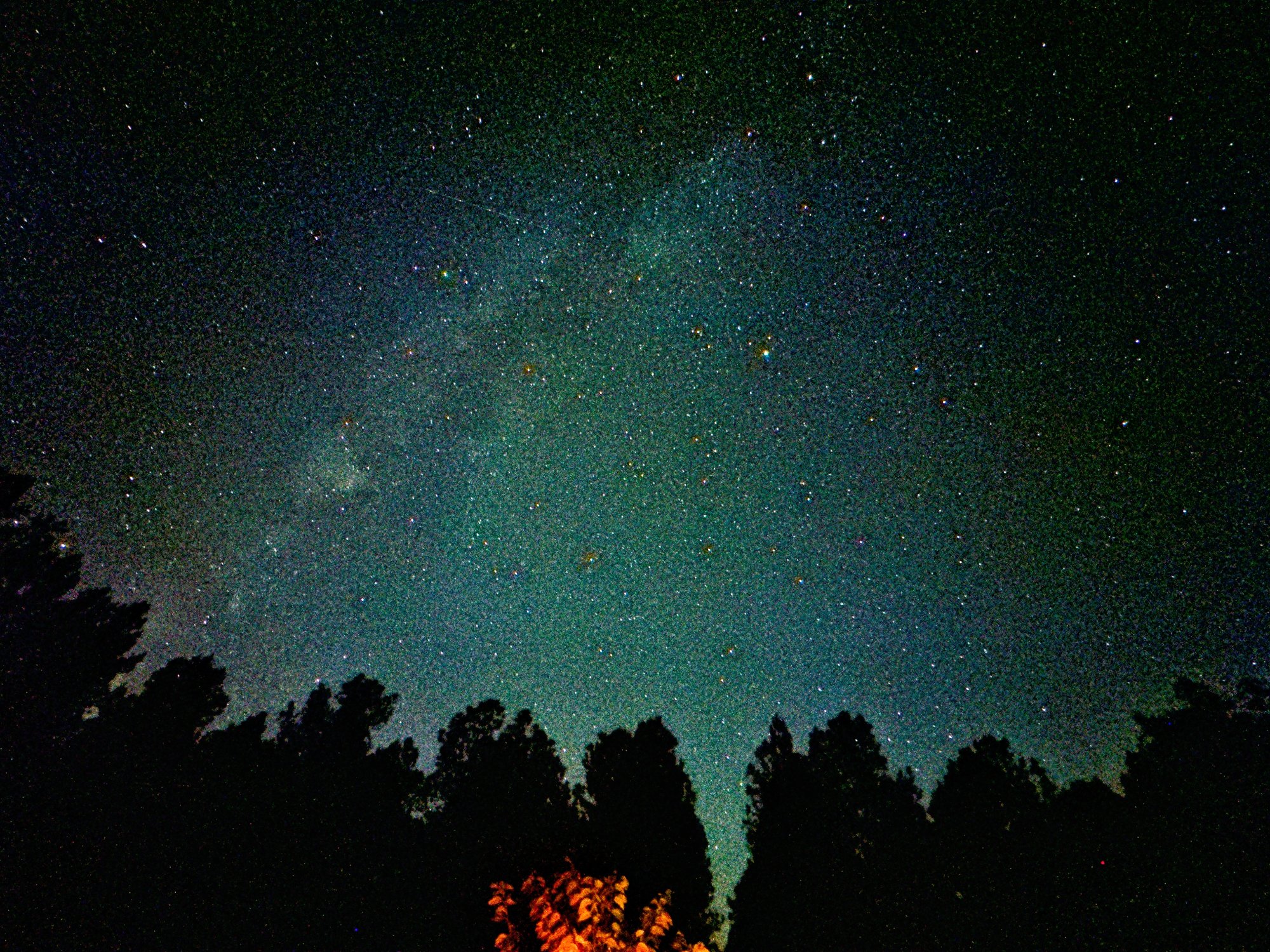

I need that! I shot these with my 13 Pro and was happy since I set my phone on a folded up camping chair on the ground. The first picture had a nice warm glow as it was next to the camp fire.

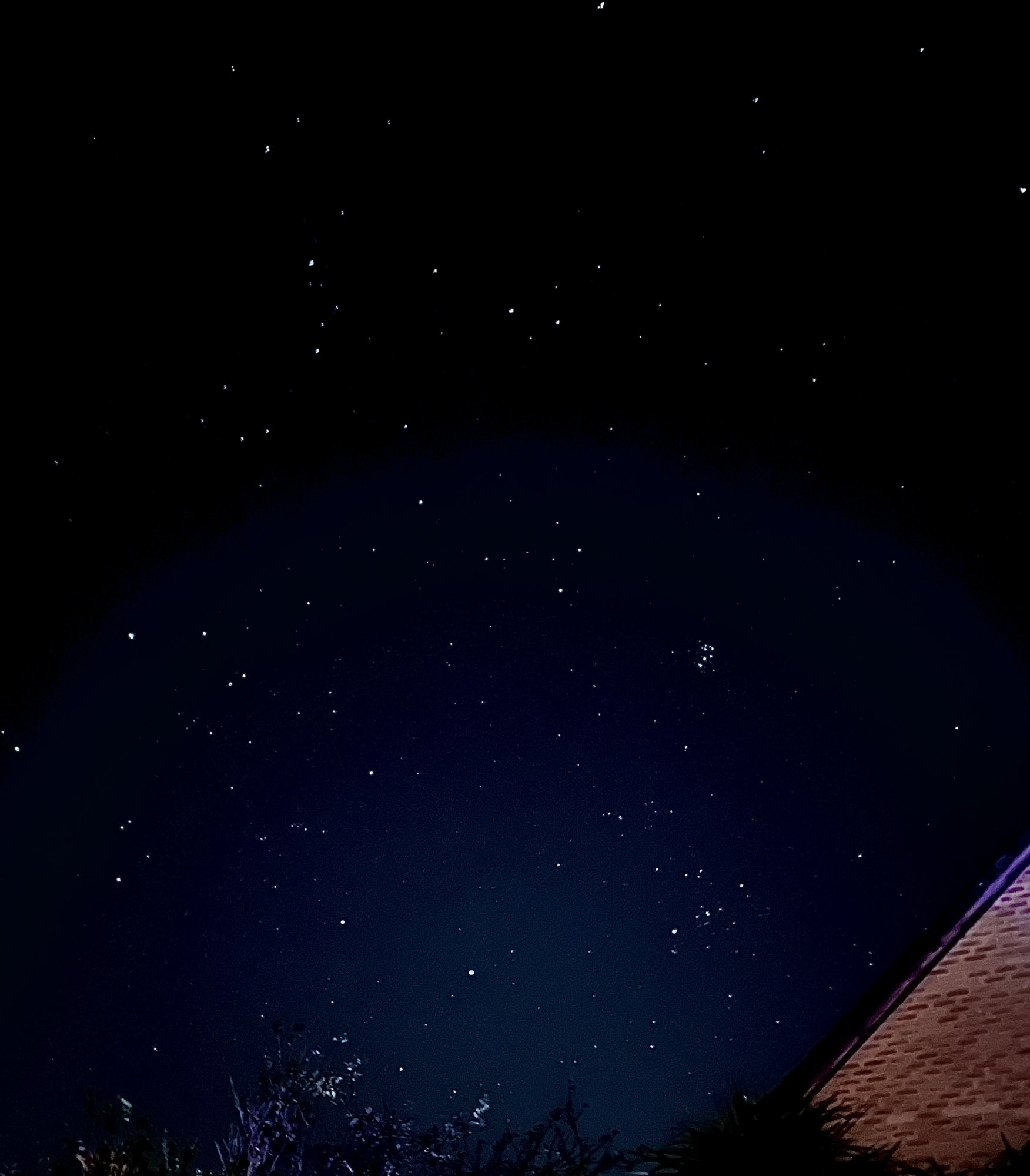

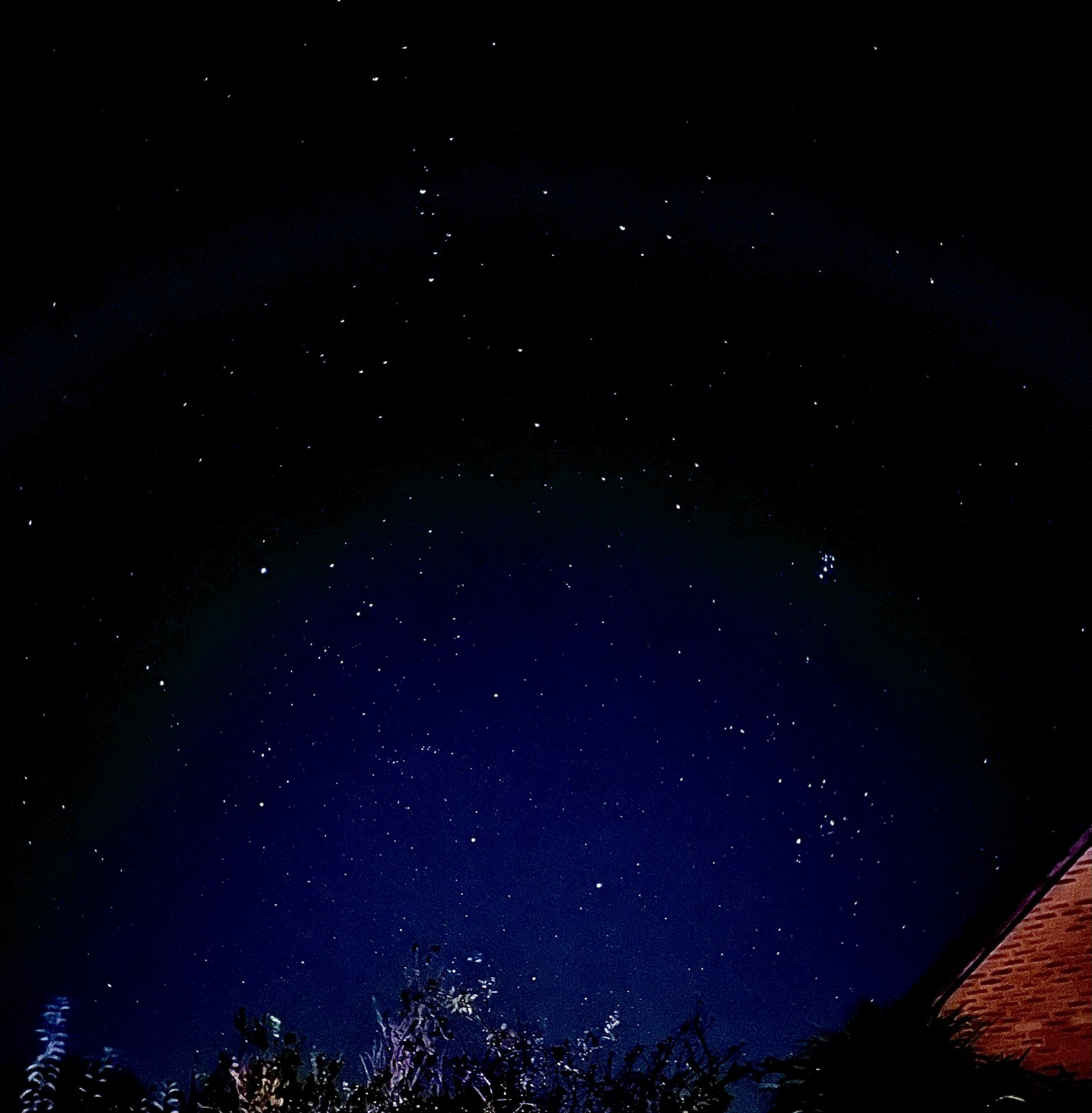

Some advice here - or even if it is possible.
The below was last night, finally got my camera tripod out and did a full 30 second exposure on the iPhone 14 pro. Then edited on the iphone using the native tools. IMO quite amazing for a phone camera, but still missing the milky way dust cloud that should run through the middle of that view if my bearings are correct. Would that come out with editing, will it not show as it is too light polluted, or do I need a filter similar to the one I would use on my scope?

It shouldn’t take any editing to show the dust cloud. I found if I let the phone focus itself without touching on one of the stars I got much better results. I also watched a video of a guy who got better results when he upgraded from iOS 16 to 16.02.

Could you see it with your naked eye? If not, you have too much light pollution in your location. I can't see the Milky Way from here with my naked eye - just too many light around. If you can't see it, neither can your phone camera.

Thanks. I can’t see it but I thought that as I couldn’t see that many stars a longer exposure would bring it out.
Love these shots just beautiful. Did you focus on a star or no focusing?
Thank you…
The iPhone will continuously auto focus so I just let it focus itself. A couple of times I did experiment with touch focus, a couple of times the image was out of focus. So I just let the iPhone focus on it own.
