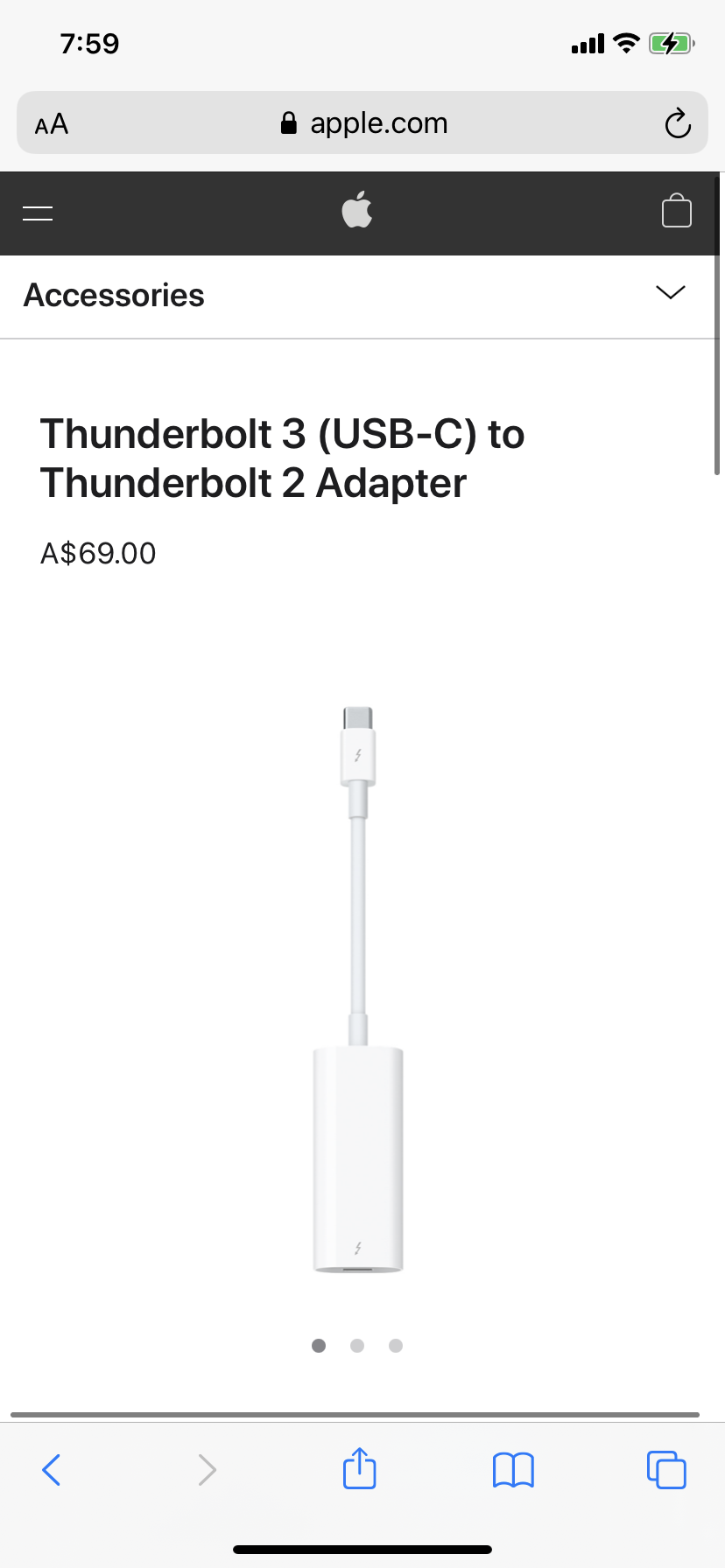

To clarify, are you using a Thunderbolt 2-to-Thunderbolt 3 adapter or a Thunderbolt 2-to-USB C adapter? If it's just USB C and not Thunderbolt, I'm not sure it will work. Also, as noted above, if my memory of miniDV importing is accurate, the device won't show up as a storage device or anything, you'll have to initiate the process through iMovie etc.
I’ve attached a photo of what I’m currently using. I’ve tried to use IMovie also but when I click import the camera doesn’t show up where it’s supposed to or at all.
Hm, I would think that should work. Have you used this camera to transfer miniDV to a computer in the past?
