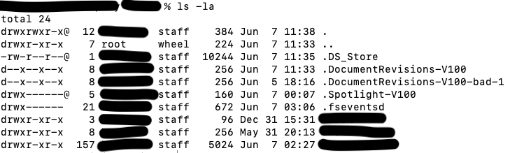

Does anyone know how to fix the issue of files on an external drive being deleted immediately instead of being moved to trash? Every time I try to delete a file, I get a pop up saying the file will be deleted immediately if I proceed. The move to trash was working fine a few days before. Now, the .Trashes folder on the drive is missing, I checked using ls -a in terminal.
I can't delete an nonexistent folder, unlike with permissions issues. I tried using mkdir to recreate the .Trashes folder but I get a no such file or directory error. I tried restarted the computer and run first aid in disk utility on the drive. Nothing worked.
It's a APFS drive.
Additional info: first aid in disk utility found some errors and fixed them, so now it says drive status is ok, but .Trashes is still missing. I am using macos ventura 13.6.7.
The last three folders are folders that I created for storing some personal stuff. The blacked out directory owners are just my username.
This is at /Volumes/[drive-name]

Judging by the blacked-out owner names, it looks like you have the correct ownership and permissions. There appear to be extended attributes on the drive, as signalled by the "@" on the "." entry. Please use this command:
Code:
ls -leOad@  /Volumes/DRIVE
