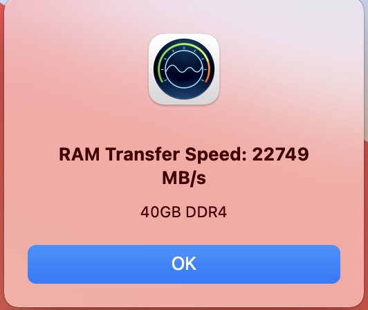

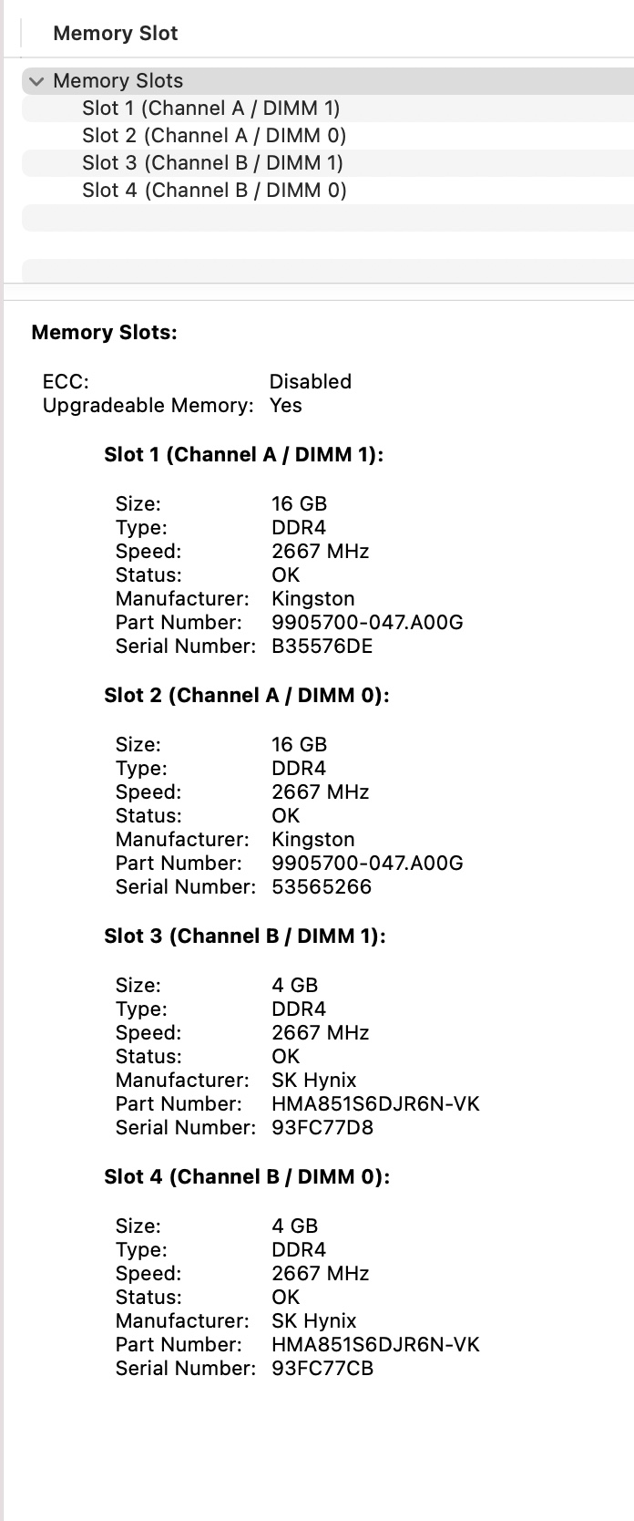

Mine is set up like this (below), and is showing the 40 gig at full speed.. I did originally get 2 x 4 gig SIMMs, they were the same manufacturer, same spec, but looked different, and they would on run at 2133 Mhz. I replaced them with 2 x 16 gig Kingstone SIMMs

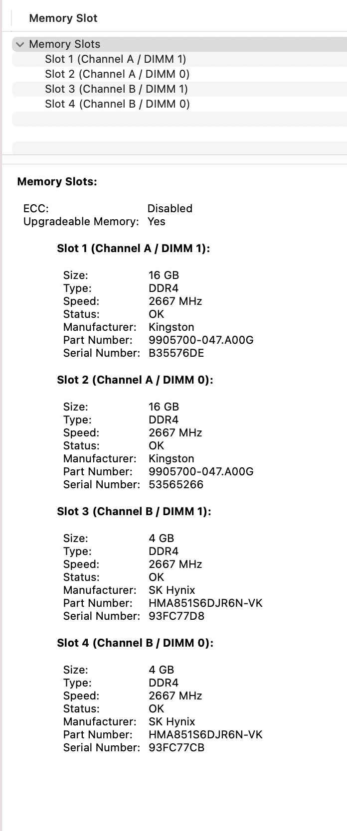

OK, the problem with your arrangement is that you have 16+16 GB in Channel A, and 4+4 GB in Channel B, which means it will not be running in dual channel.
At best, it will instead run in "flex mode," where 16 GB will run in dual channel (the 8 GB in Channel B plus 8 GB of the 32 GB in Channel A), and the remaining 24 GB in Channel A will run in single channel. This effectively halves the transfer speed of 24 GB of the RAM.
At worst, all 40 GB will run in single channel. (I am not sure if flex mode is even enabled for this iMac.)
You will do better to put 16 GB in Channel A (Slot 2) and 16 GB in Channel B (Slot 4) to get full dual channel, and leave the 4+4 GB out. (This is assuming you have the 2020 iMac).
You can check yourself by running Novabench RAM speed test both ways. You should get 28000+ MB/s if it is set up correctly.
Hope this helps.
@wilberforce Thanks for the heads up. I was originally only going to use the 32 gig, but when it just seemed to work I went with it.. Im not keeping up these days with all the subtleties these days. to busy.. 🙂
