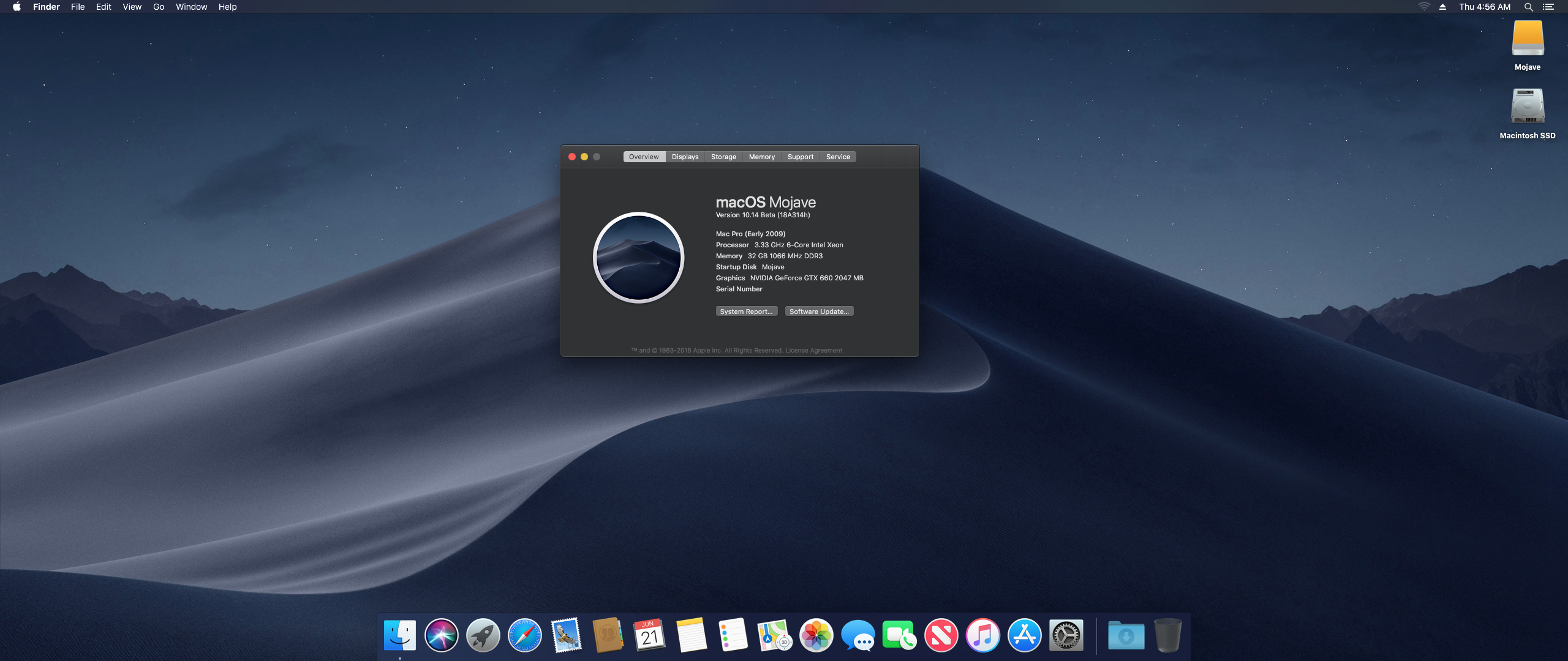

I ended up swapping in the GTX 660 and everything is working perfect! I'll have to wait until final release for the web driver on the 980.

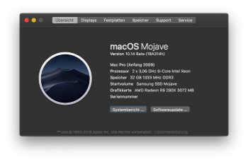

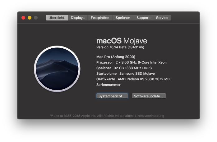

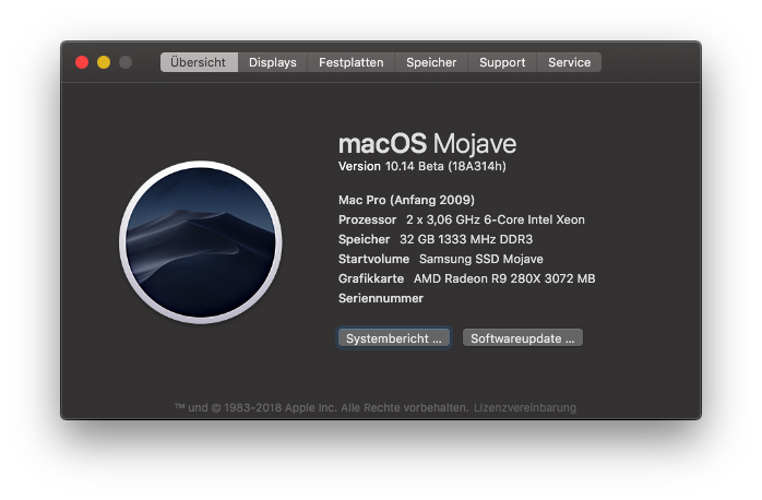

So, got DP2 up and running on a 4,1/5,1. Can report a flashed 280X works fine, isn't laggy either.
I didn't use a supported machine. I used @dosdude1's MacOS Downloader instead, and made a bootable USB thumbdrive with @tywebb13's instructions. BootROM is still at MP51.0085.B00. No problems at all.

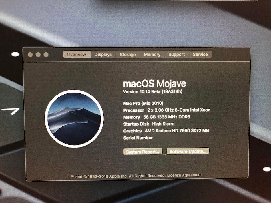

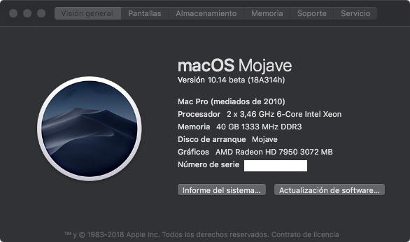

Thanks for the tip! After I moved a copy of Mojave installer into my applications folder, I used this command from terminal and had no problem installing Mojave onto my MacPro5,1.
So far after my install everything seems to be working...I'm using my Radeon HD 7950 and everything seems to be okay so far...
I have since renamed my startup disk to "Mojave" :)

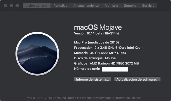

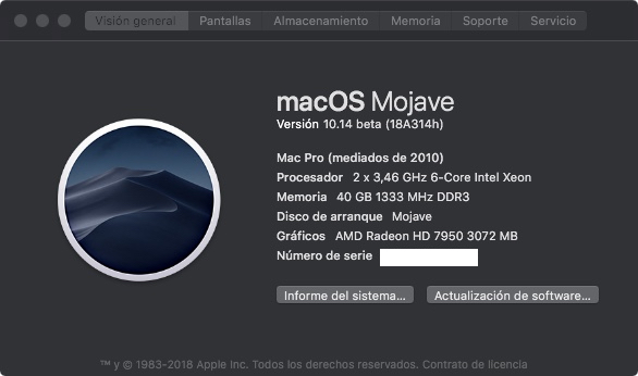

As the "sudo /Applications/Install\ macOS\ Mojave\ Beta.app/Contents/Resources/startosinstall" method didn´t work for me, i made an installation of Mojave in an external SSD on my compatible Macbook Air.
Once finished, booted from the disk in my Mac Pro 5.1 with HD7050.
No problem at all.

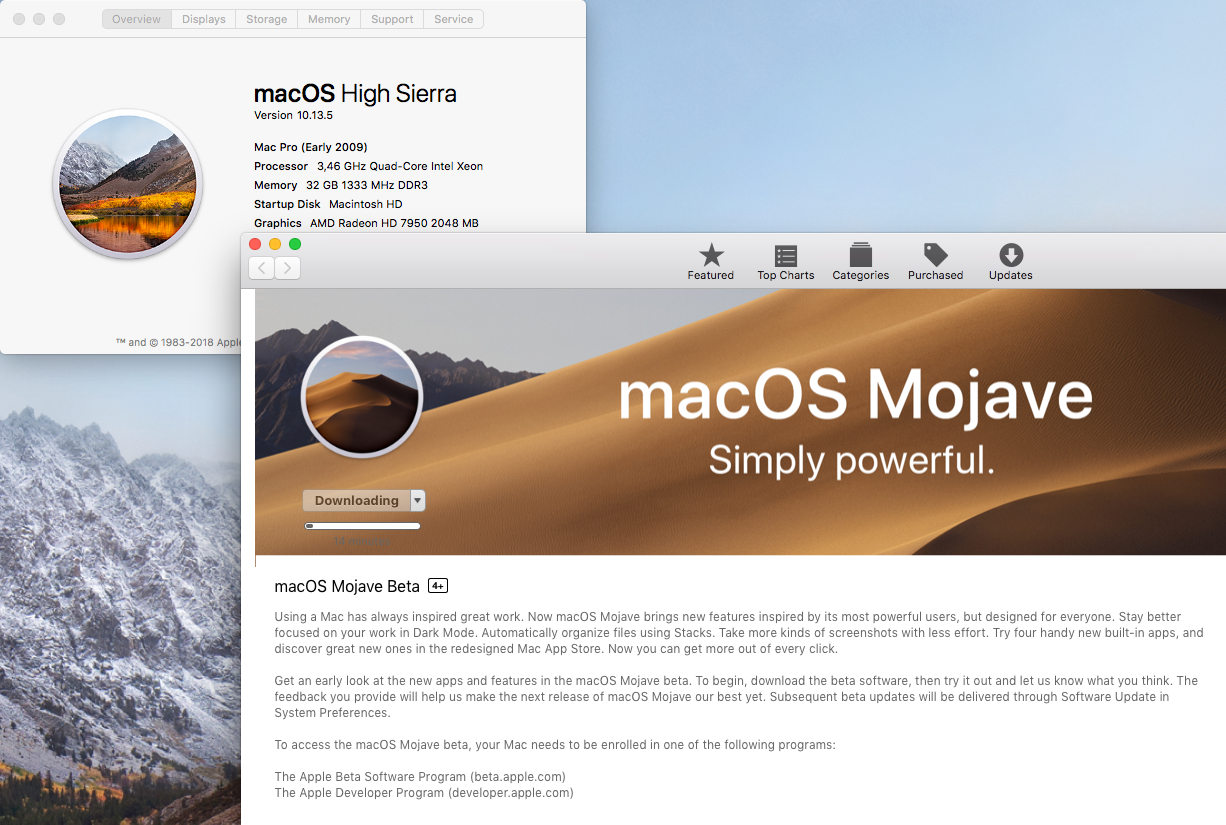

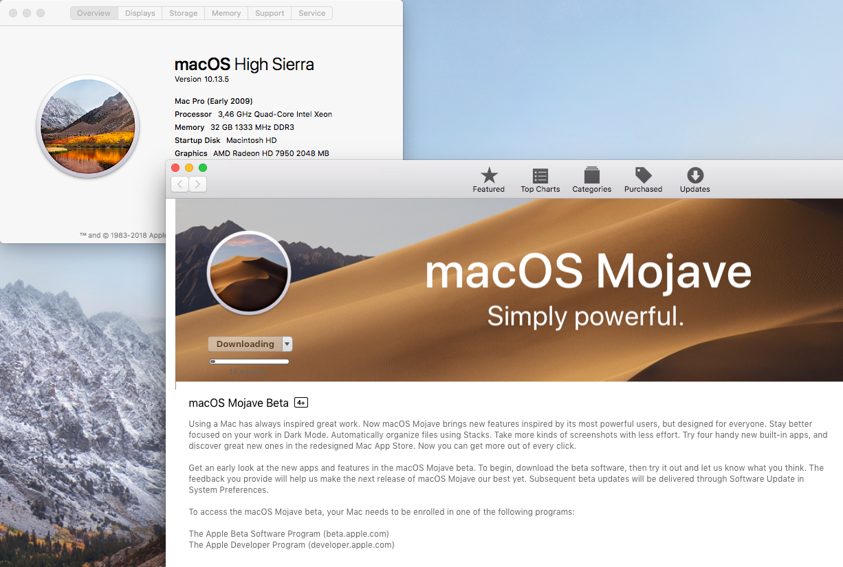

I'm getting the same error. I'm trying to download the developer beta 2. I logged in to the developer website and downloaded the installer. I get to the point where App Store opens to let me download, when I click on continue the error pops up. I've been trying since yesterday.
Delete the installer. Install the public beta profile. Then download the installer from the App Store and it will be the full installer. Once Mojave is installed you can install the developer beta profile.
