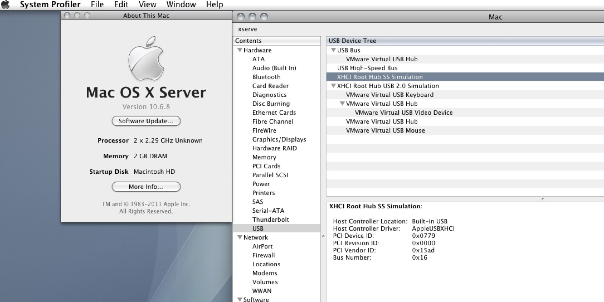

I think the earliest OS limitation for MacPro7.1 is Snow Leo 10.6.8 with PCIe USB2 and SATA controllers. Limit the number of cores in boot-args and specify arch=x86_64. And of course you need a compatible graphics card. On a hackintosh with identical hardware it was possible. You need to experiment with Opencore.
UPD: I did not test the XHCI (USB3) driver on real hardware to get rid of the USB2 card, since I do not have access to the hardware, but it works in a virtual machine.
