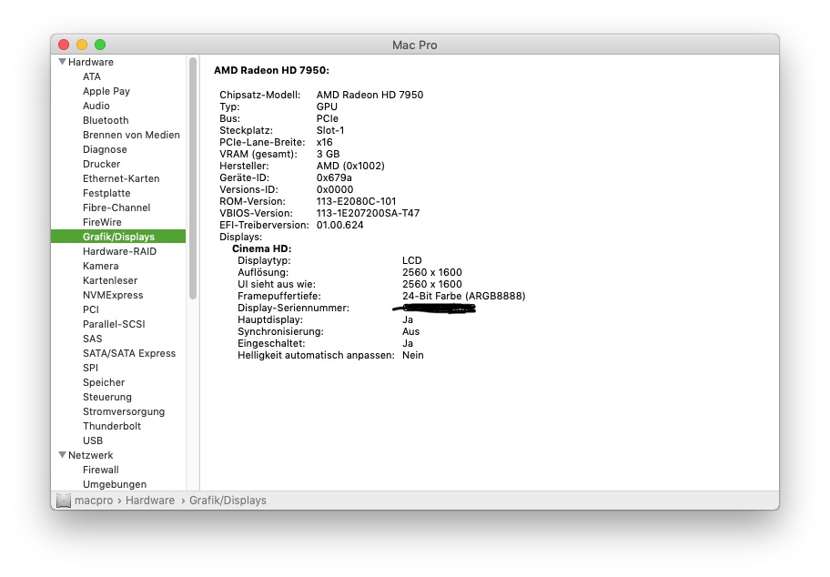

I’ve updated my Mac Pro 5,1 2010 starting from 10.12.6 over 10.13.6 to 10.14.6 today. Boot menu works, booting to safe-mode works. But after about 3/4 of the loading bar the screen goes black. It sounds as if the boot process goes on correctly, I just can’t see anything. It did still work with 10.13 – it just booted fine and I started the Mojave update.

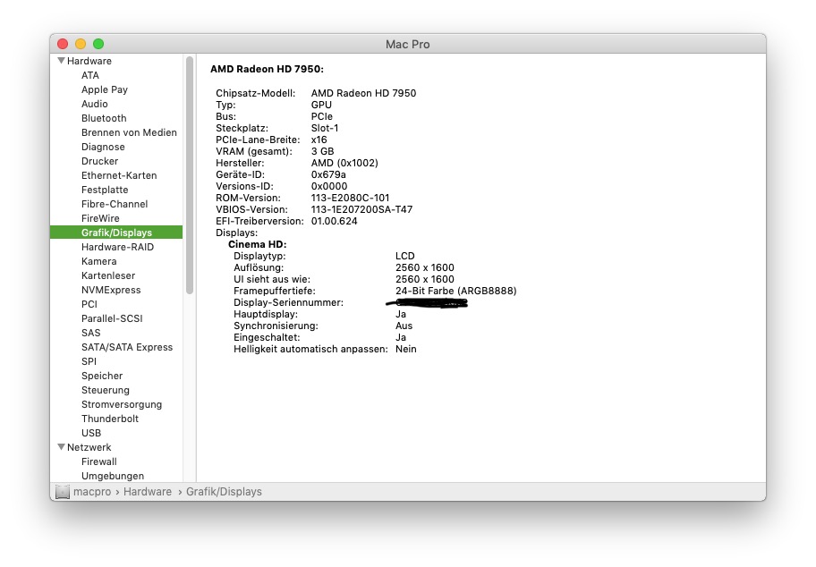

A few years ago I’ve upgraded to a Sapphire HD 7950 3G DDR5 – not the Mac Edition though. Until Mojave it worked fine from–I guess–10.10 on. I don’t even have the original card anymore, since the 7950 just worked. I flashed it back then.

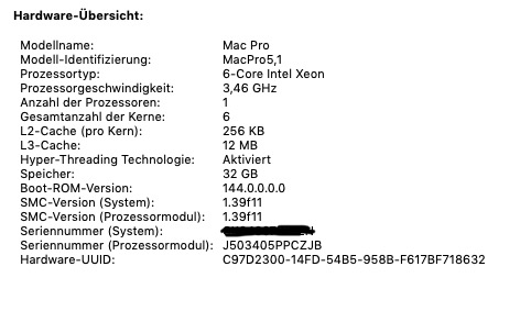

Does someone have a hint where to look next? Update the firmware? Installing drivers? Any help greatly appreciated. Please find additional system info in the attachments.

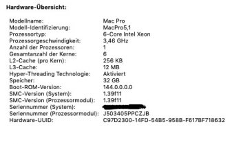

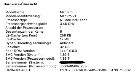

You already have the current BootROM, 144.0.0.0.0.
Safe mode don't have acceleration and masks GPU hardware problems, did you tested your Mac Pro with another GPU? There are lot's of people reporting HD 7950/7970 dying lately and all start with problems after the drivers are loaded progressing from there.

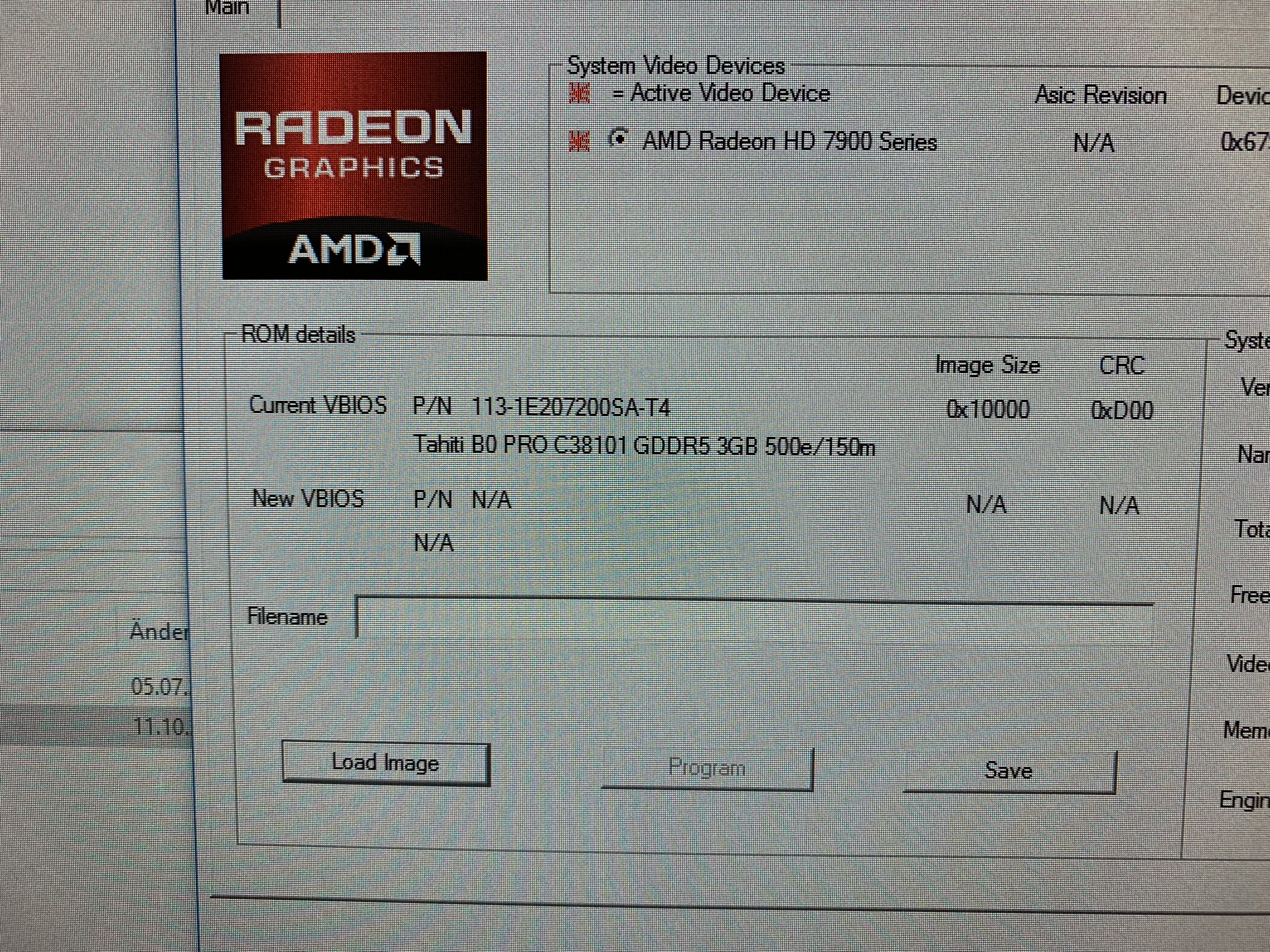

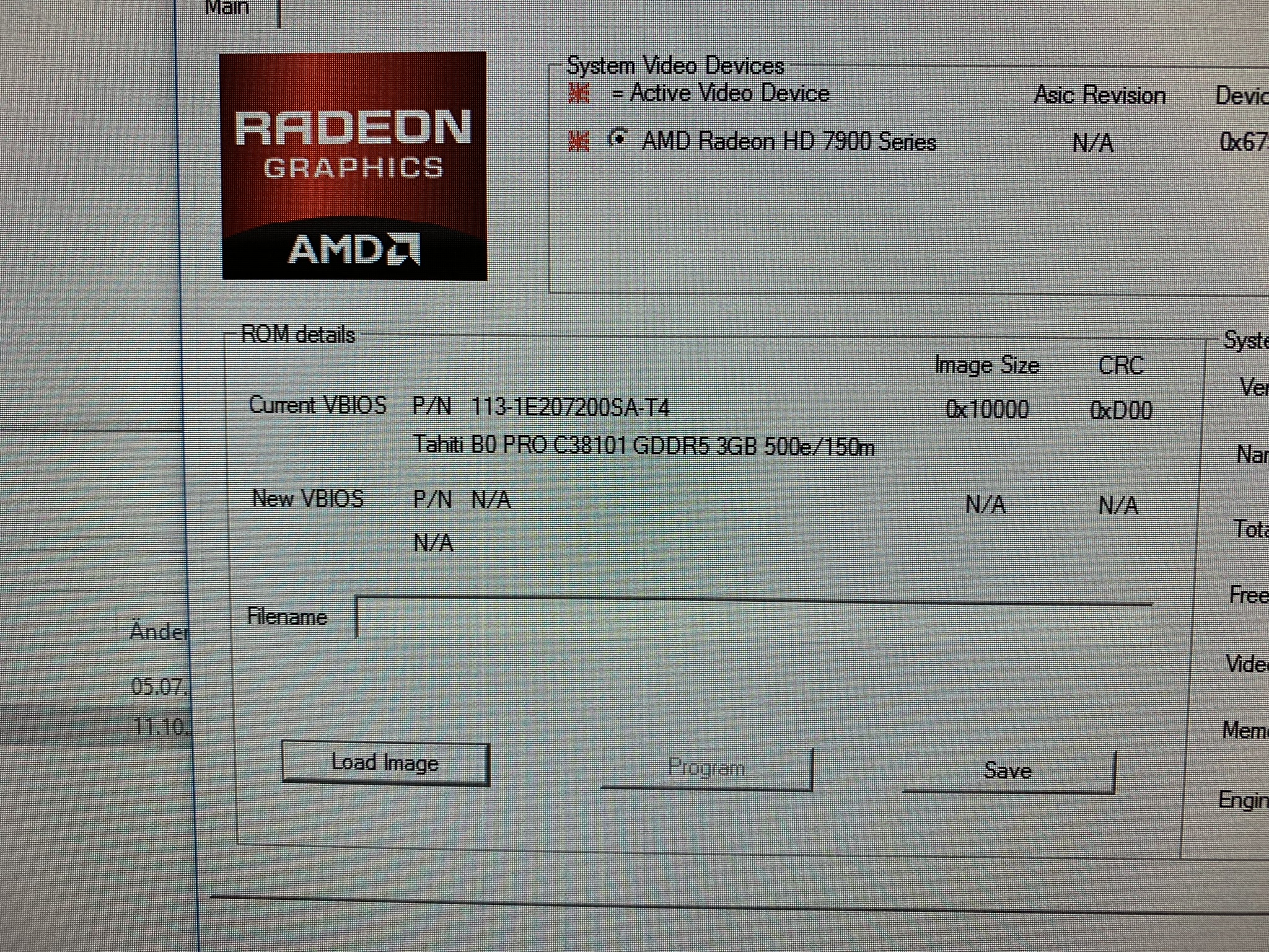

Is there a little switch button on your card for switching between BIOSes. Have you give it a try?
Reactions: MIKX
Yes, shut down. . change the switch to Position 1 and see if you get a screen when you start up again.
AW
Assuming that you haven't EFI flashed BOTH BIOSs you won't get an EFI bootscreen so don't hold down the OPTION key when you start up.When I EFI flashed my HIS 7950 & Sapphire Dual-X 7970 I used BIOS Switch position #2. ( I think that BIOS position #1 is the factory default. )
If it boots up and shows a login screen you have a chance.
I would then ( in my case ) Boot into Win 7 and SAVE the BIOS #1 rom.
Shut down & boot back into Mac OS
SAVE a copy of the newly dumped ROM as " 7950 BIOS 1 ROM.
Seeing that you are familiar with EFI flashing you will know what to do next.

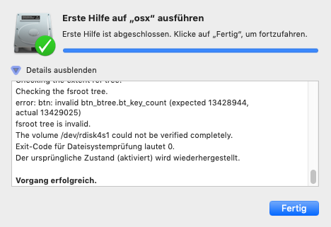

Thanks for all the replies. IndioX got me thinking: What if this isn’t a sole graphic problem after all.
1. I’ve installed mojave on an external drive (as suggested by tsialex) and was able to boot just fine.
=> My conclusion: Not a hardware nor a sole graphic card problem.

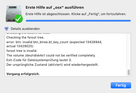

2. I went on using disk utility and single user mode to repair the btree error I saw there (screenshot attached). I also tried booting to repair utility and reinstalling Mojave…
3. Elsewhere a guide fixing login problems suggested removing the .AppleSetupDone file…
So I ran the following in single user mode
/sbin/mount -uw /
rm var/db/.AppleSetupDone
And now… after booting the voice assistant started after a few seconds (due to my inaction the system triggered the assistant for blind people)… I could choose a keyboard layout etc. but the screen was still pitch black. I didn’t create a new user account for now, since I wanted to check back with you guys. What could that mean?
After removing AppleSetupDone the setup is THERE I just can’t see it. Although everything else from boot menu over recovery mode or safe mode works just fine. What could I try next?
