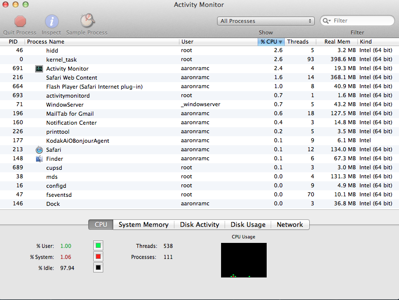

wolfaaron
macrumors regular
Jul 31, 2012
138
45
My battery is shortened by 25% after the upgrade to Mountain Lion.
Here's a screenshot if someone wants to tell me if there's a problem:
