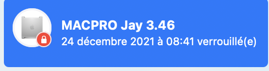

Hello, all. I have a MP 5.1 running on 10.14 with a RX580 (unflashed), I updated the procs to 3.46, 12 cores, things were running smoothly, there is no filevault or encrypted DD. I traveled along with my 2 kids and left my pregnant wife home (she cannot travel)and decided to lock my mac from another device in order that she doesn't use my main computer (its my only desktop left)while im away. Locked it from icloud, (marked as lost). I returned yesterday to have the displeasure of finding the computer running with black screen, she said she just powered it once and that it was like that, she saw no prompt... I restarted, nothing just black screen, no prompt for password or unlock. I checked on that idevice 'find my mac' (iPhone etc) and the Macpro appears with a locked icon but no ability to unlock it from there. When clicking on the 'Mark as lost' icon I get the possibility to lock the mac (again!!!) but not unlock it. I did lock the Macpro 2 months ago and there was no issue, I was prompted with password input, now nothing, just the mac chime after 1 minute, and blank screen. Im very worried because since my graphic card is non flashed PC card, it works but I have no bootscreen progression, Im not even sure I can use the recover mode because I won't see anything. I tried the Pram reset but it does not work only the mouse is lit (gaming mouse with leds)!! Has it ever happened to anyone, any clue?

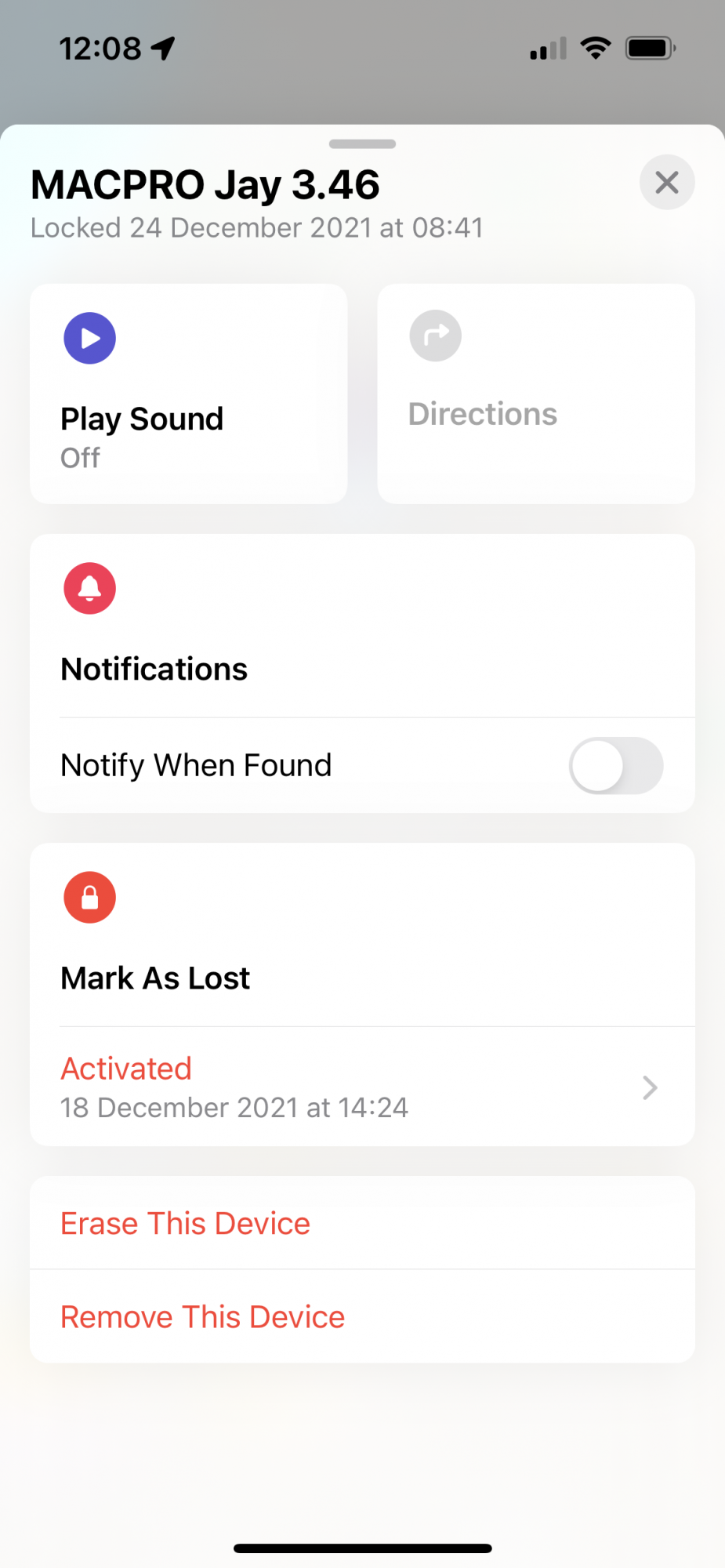

In your screenshot, what happens when you tap on the activated section under Mark as Lost? The section that says "Activated 18th December"

There is a discrepancy
It’s appears as locked since 24th of December, the day she probably opened it, and
I have 3 options from the drop down menu :
-Register as lost
-Erase device
-Remove device
No password input on either my M1 MacBook or iPhone!!!!
It’s a nightmare.

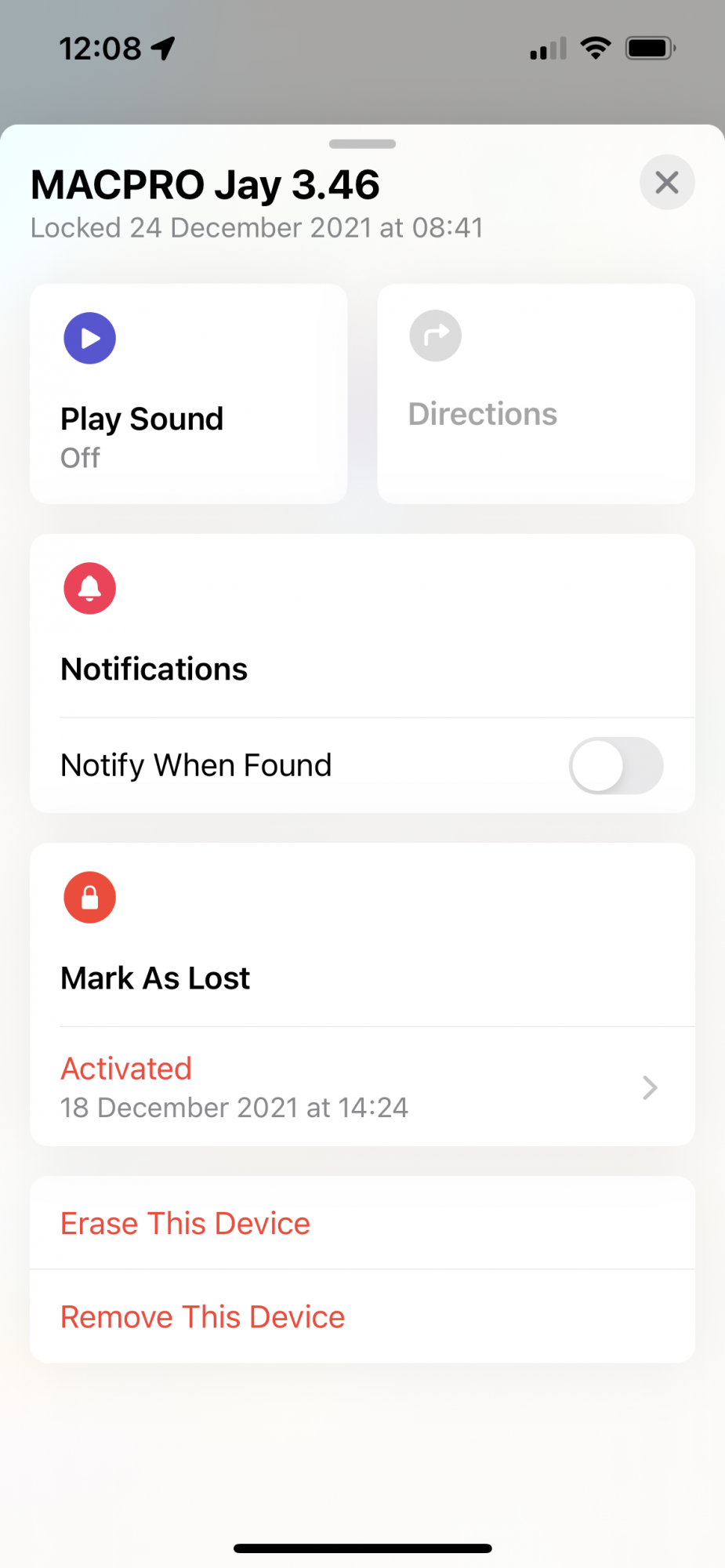

I’m in front of all my apple devices (MacBook pro M1, iPhone ) it’s listed but there’s no option to unlock it. Mac Pro starts, 25 to 30 seconds wait, then chime, then nothing, no signal to the screen, no input challenge to password… that’s the issue!
I have my password and code to unlock, just it’s nowhere to be entered.
