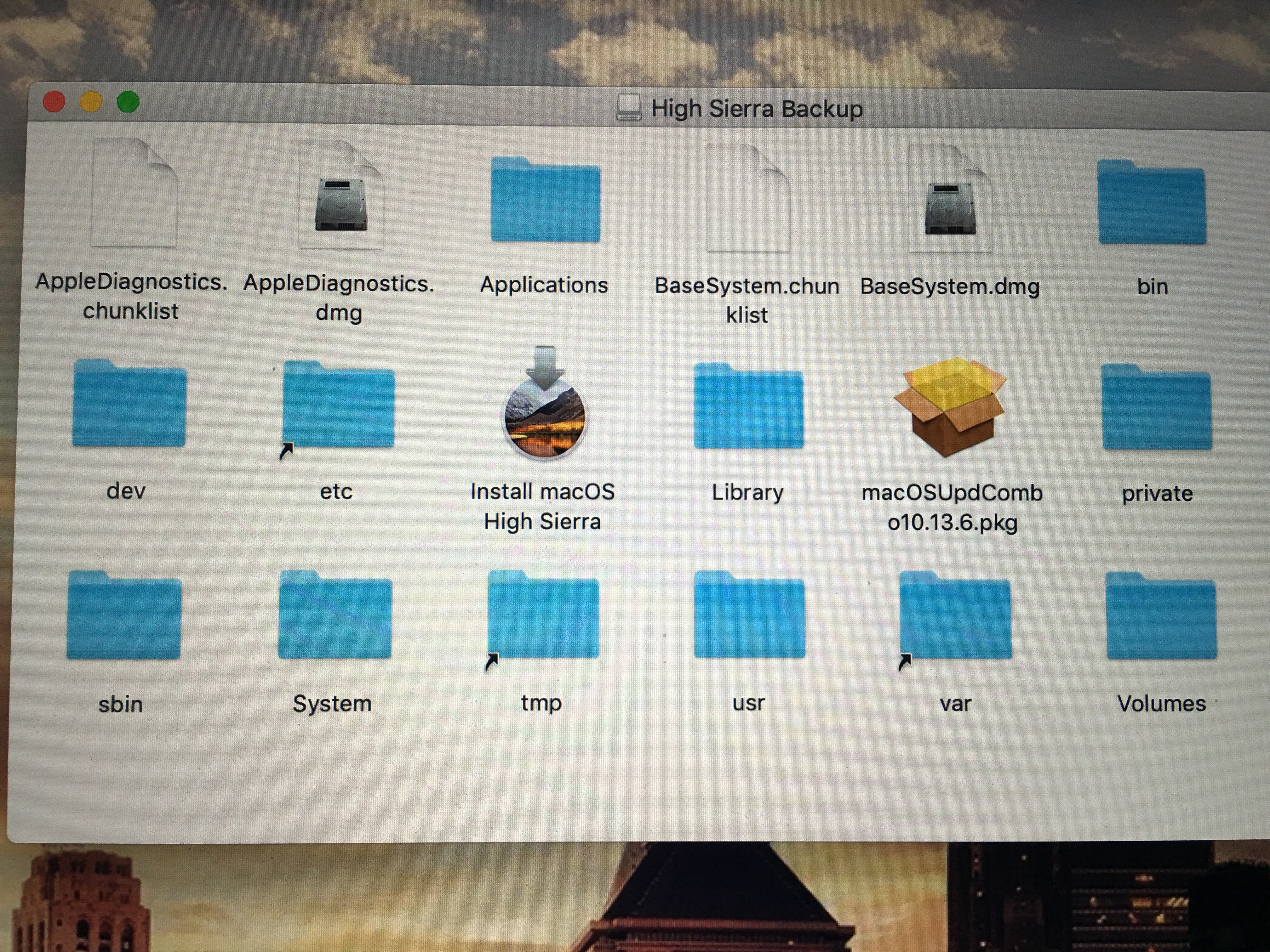

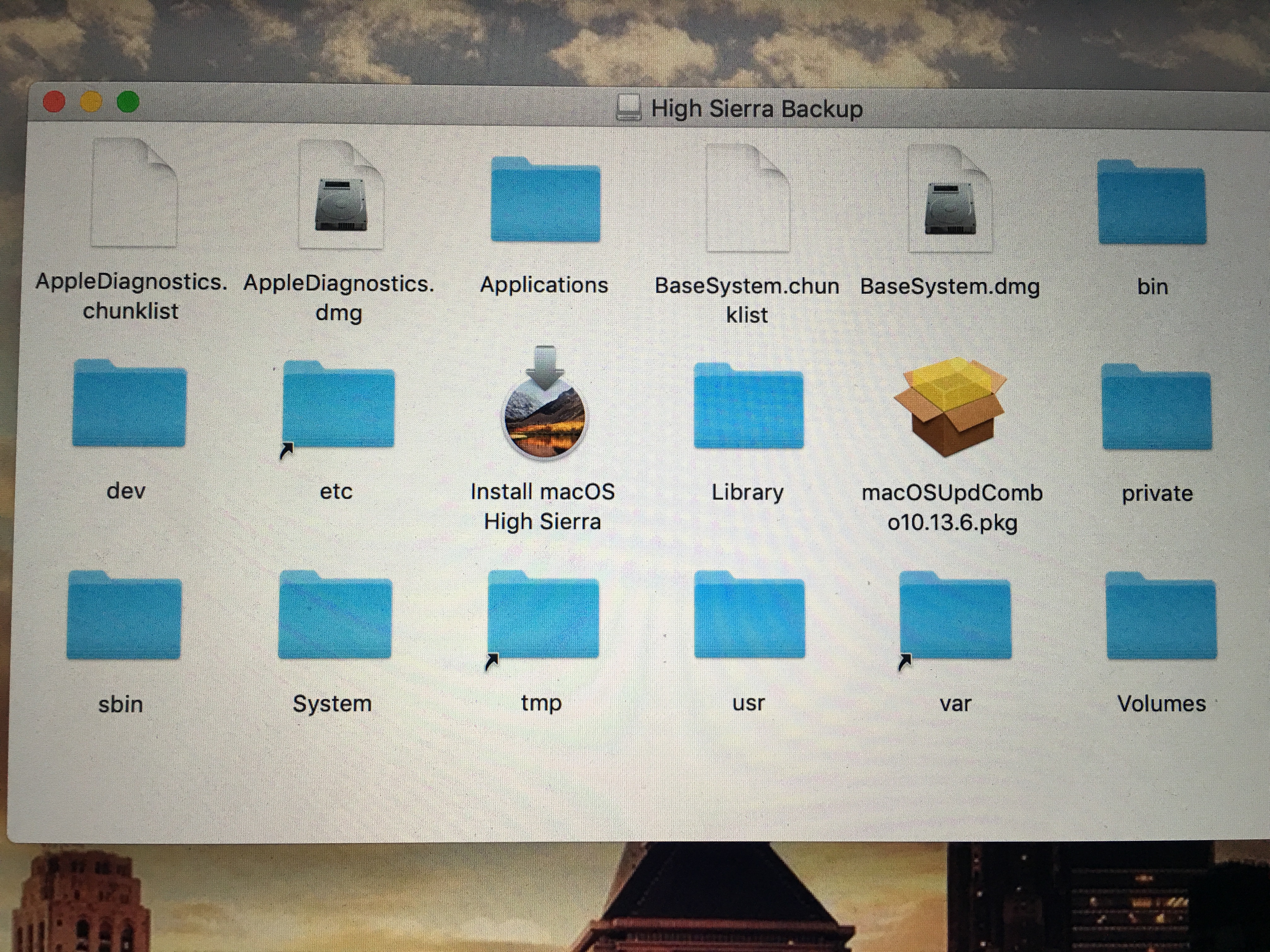

Here is a screenshot of the USB I was using...perhaps this is not correct? I don’t remember how I created it but it wasn’t via ‘createinstallmedia’, but I did use it previously to reload High Sierra when I was having issues getting my MP to update past 10.13.4 (which I was still unable to do before my original GPU died). Unfortunately I have no other PC/Mac to test the GPU in. My only other computer is a MacBook Pro pre 2018 so I don’t have screensharing capability. My monitor is a Dell U2711 with DP, HDMI, DVI, and VGA inputs.

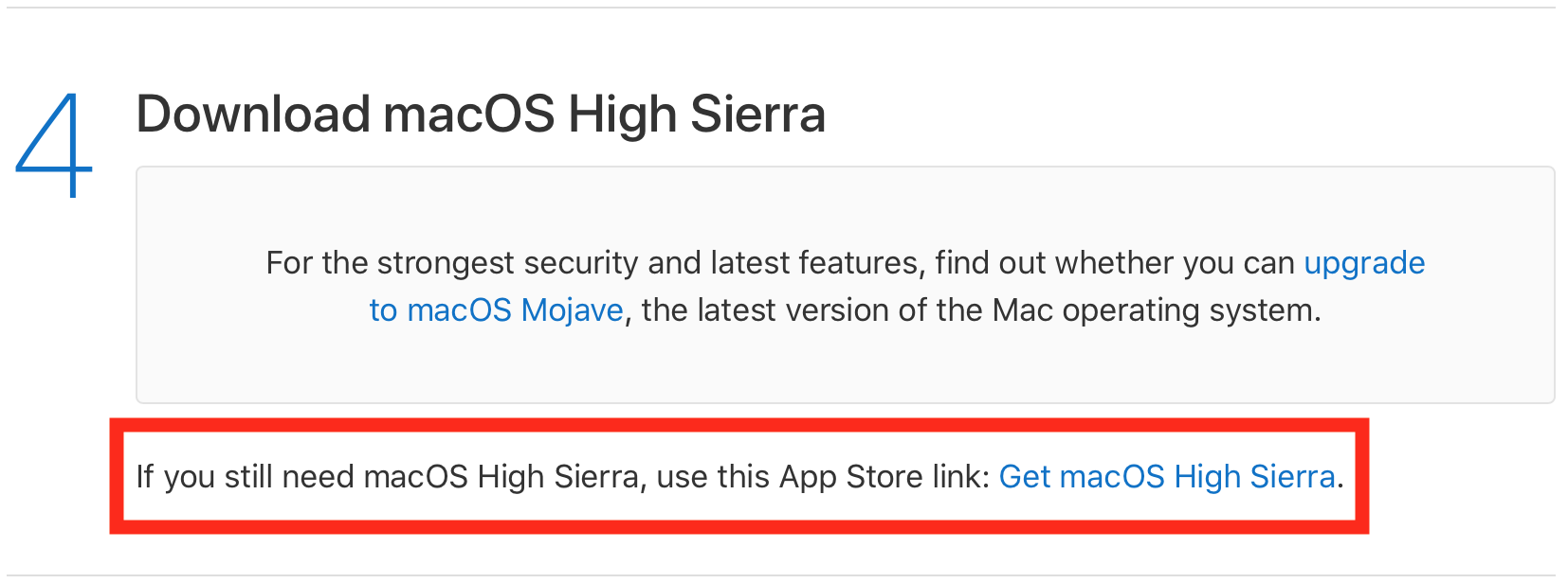

You are really making this more complicated than needed, follow Apple instructions on how to create a createinstallmedia USB installer and test it: How to create a bootable installer for macOS.

Ok, partial success! Obviously the problem was with the original USB I was using, so after creating a new USB boot drive, I finally got it to load into the initial gray screen which gives the options of “Restore from TM backup, Install macOS, Get help online, or Disk Utility”. What do I do at this point? Thanks
