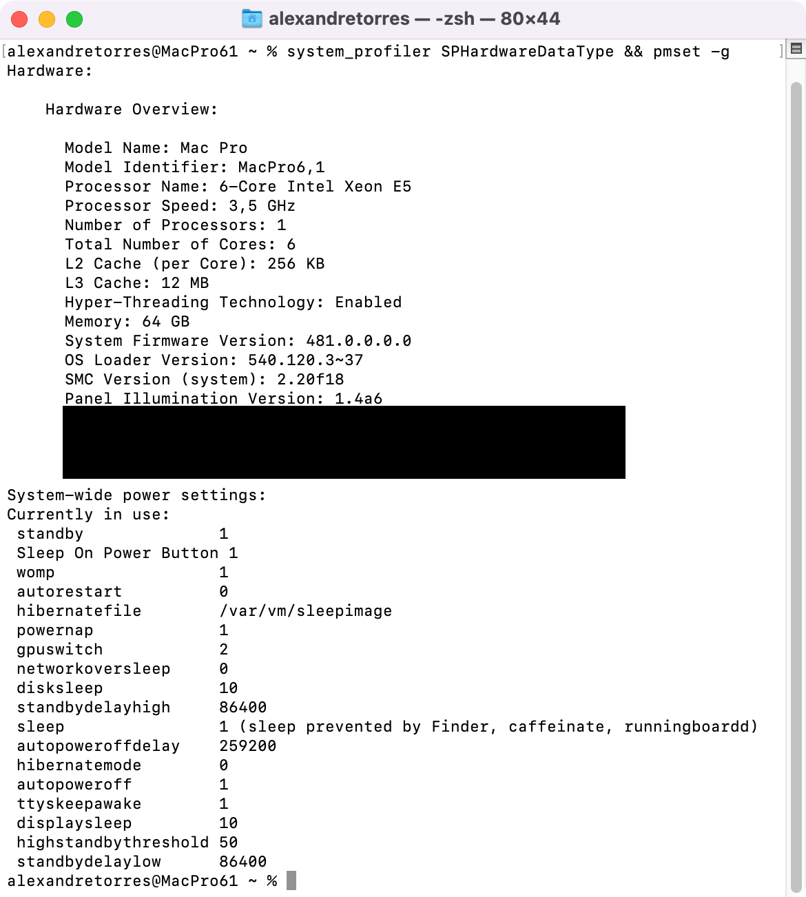

ran pmset -g and I get a result that GPUSWITCH was set to 2.
"Use Integrated video on battery or AC"
Xeons do not have integrated video.
Since using GFXcardstatus to force it to use GPU it's been fine.
I'm going to try disabling that extension and using pmset to configure it when I have time.
tsialex
Contributor
Jun 13, 2016
13,094
13,298
gpuswitch: 2 is the correct value:
Code:
alexandretorres@MacPro61 ~ % system_profiler SPHardwareDataType && pmset -g

Calaveras

are you sure?
Because from what I found on some site (stack exchange I think?)
Gpuswitch 2 means integrated
gpuswitch 0 means discrete
gpuswitch 1 means use discrete on AC power only.
Checked the man file fro pmset and it was no help of course.
The 6,1 has no integrated graphics, so I wonder if it's a similar case to numbering network interfaces and storage volumes? The first one detected is the 'integrated' and anything after is discrete?

are you sure?
Yes, I'm sure. Screenshot:

Seems so, never had or read about that before your post. Something very weird happened to your macOS install.
I agree with tsialex. My 6,1 has been running Monterey since I've owned it (about 18 months now); currently it's on 12.7.4.
"pmset -g" shows "gpuswitch" with a value of 2. Running videos absolutely does show the Slot 2 AMD Radeon GPU active (per the Activity Monitor/GPU pane).
