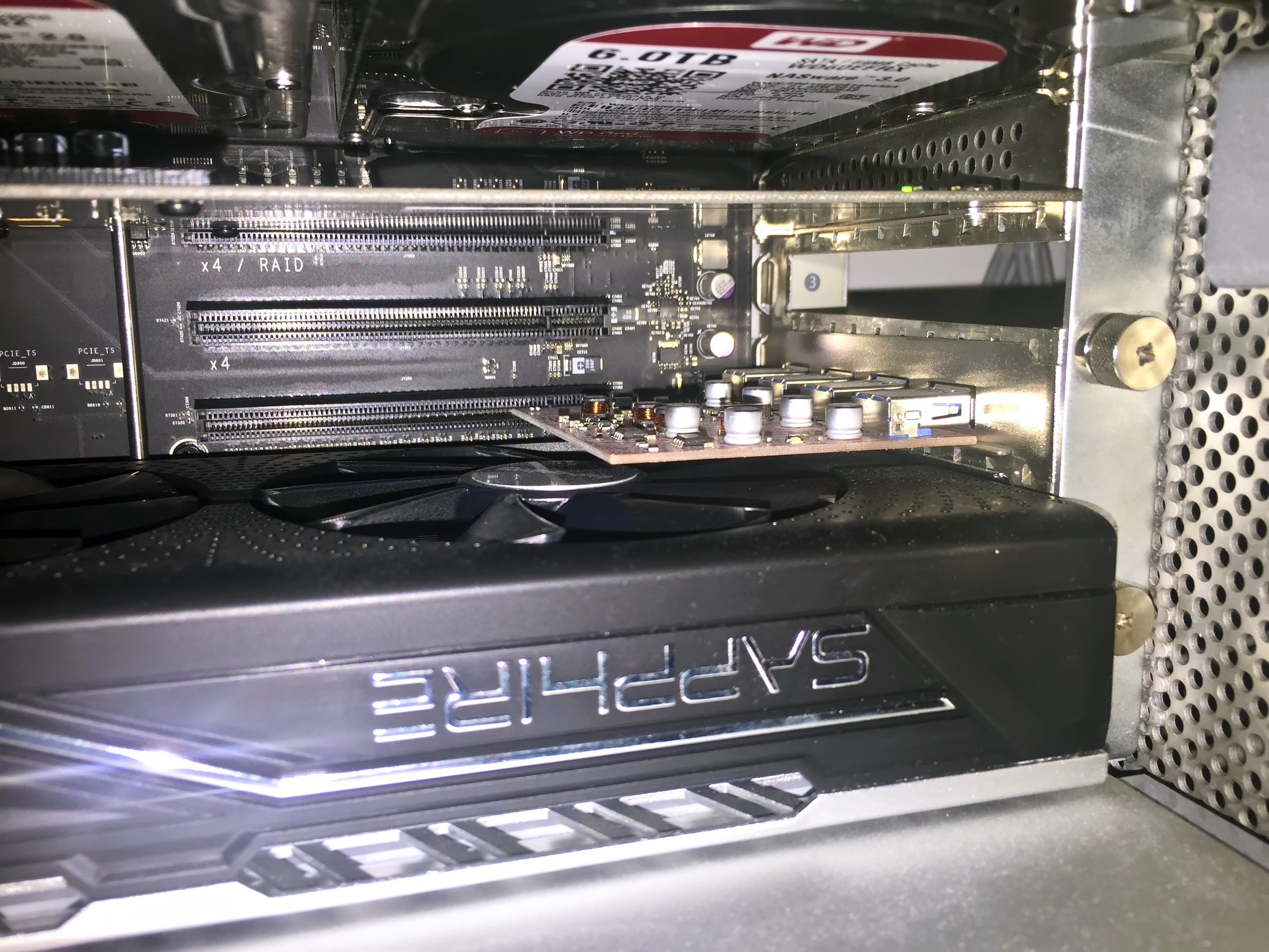

Does anyone know of a legitimate non-conductive spacer or wedge to use with the Sapphire PULSE RX580 8GB in an official MacPro 5,1 (Mid-2012) for the card in PCIe Slot #2? Looking for some kind of pad in the area around the first fan so it does not knock, hit or interfere with the PCIe card above. Thinking of using those clear furniture bumper dots, but wondering if there is something more computer oriented.
Currently have an Apricorn Velocity Solo X2 in PCIe #2 slot. It is completely seated and installed correctly, but it does slightly "droop" and hit the fan. You can completely hear it during boot and whenever the GPU fans activate, unless some kind of wedge/spacer is placed. Slot #2 was previously occupied by an Apricorn Velocity Duo X2 (when using with GTX 1080 FE), but moved the Duo to PCIe #3 so the one fan on the GPU has full vent access.
Temporarily using a plastic tool as a wedge for initial RX580 testing. With the EXTREMELY tight fit of the card, plus the fans sitting slightly above the surrounding plastic housing, will need to come up with a more permanent solution to continue using the PCIe slot.

I also experienced this issue. The Sapphire Pulse card is a monster! And its fans sit up slightly above the heatsink. I killed my GT120 by (stupidly) trying to carefully lift the edge of it up with a PCI slot cover.
After that debacle, I moved my USB 3.0 card to slot 2 but it has a couple of chips mounted on the underside that got hit by the fans. In fact, the fan closest to the backplate couldn't spin at all with that card inserted, no matter how I tried to wedge the two cards apart.
So I moved that card to Slot 3 and installed my RocketRAID eSATA card in slot 2. It has no components on the underside so as long as I made sure it was shifted as high up as possible (and the Sapphire pushed down as far as possible) I don't get any fan interference now.
If the contraption used to secure the pci slots in place is not working, throw it aside and screw it in place like you would in a PC case.
It's working. Both thumb screws are secure and the bar is in place. The issue is the Apricorn Velocity Solo X2 slightly drooping into one of the Sapphire PULSE RX580 8GB fans. That is not good for the GPU or the Solo X2.
That's basically what I have going on now. Luckily the physical bottom of the Velocity Solo X2 is smooth, except for screw heads. The card "droops" slightly. It's likely a slight or minor bend in the card itself. The Solo X2 is longer being made, so cannot easily replace. Setup works perfect with GTX 1080 FE, no spacing issues at all.

Using a plastic screen puller tool currently and it's working fine for testing for now. Ideally will get a more adhesive/permanent solution. Using all PCIe slots, so limited in which slot I can use the RX580.
wedging things to keep the fan of the RX580 from hitting the card above is not good in my experience. You will not get proper air flow/cooling to the RX580, especially if you use it for anything other than just reading emails.
Please refer to my posts in the past about doing this same thing and being unsuccessful.
https://forums.macrumors.com/thread...-random-restarts.2120481/page-2#post-26130788
Yes, it's not even close to ideal. Not a great fan setup of this RX 580 for MacPro 5,1 usage and only picked it up because it is Apple's recommended Mojave card and was on sale. This is not at all an issue with the NVIDIA GTX 1080 FE. If the GTX 1080 works with Mojave, I'll absolutely stick with using that over the RX 580.
I need to use all 4 PCIe slots, so will need to figure something out to keep the card in slot 2 from "drooping" into the RX 580 GPU fan.

Yes. The Velocity Solo X2 is actually the smallest footprint. It's a pretty short and narrow card. Covers part of the 1st GPU fan, but only on one half. Basically from the deep part of the case until about the end of the center logo. The 2nd GPU fan has full access.
The Velocity Duo X2 is longer and wider than the Solo X2. Would fully block the 1st GPU fan and much more partially block the 2nd GPU fan. Not a good candidate at all.
The other card right now is a USB3 card. Likely could pickup a smaller one, but this card often gets swapped for an external PCIe RAID storage controller/expander style card for working on certain client projects. Do not have this card right now, but swap frequently enough that having easy access would be ideal.

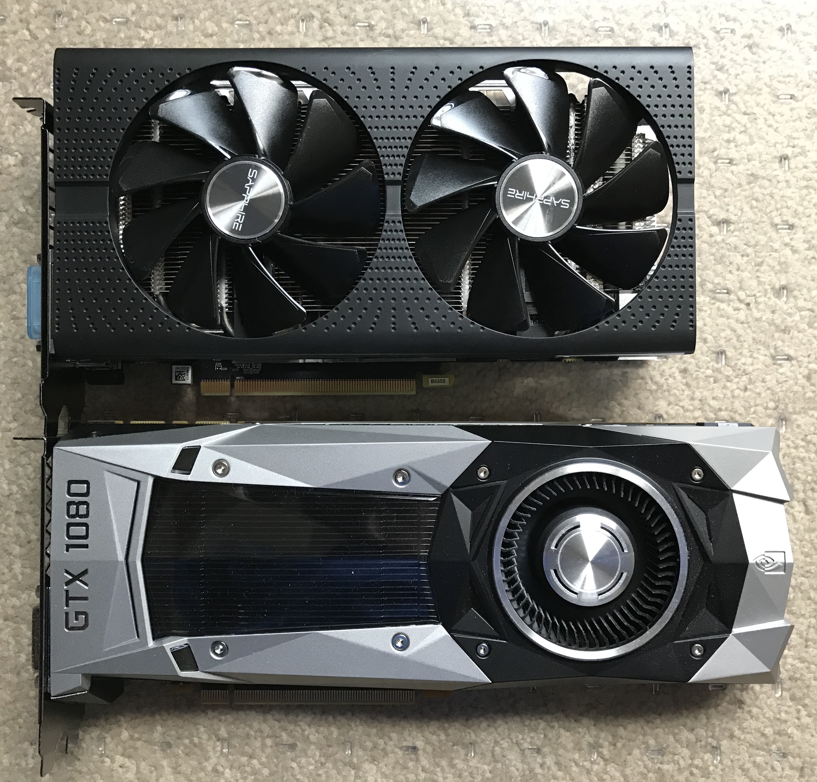

The fans on the Sapphire PULSE RX580 8GB are pretty massive compared to the GTX 1080 FE. Was easily able to place the Velocity Duo X2 above the GTX 1080 FE and had no issues with the single fan or cooling.
I had the same problem too. I ended up placing the card in slot 2, and putting my HighPoint 7101A in slot 1.
This makes me more comfortable with cooling for sure, and no clearance issues.

The Sapphire PULSE RX580 8GB is absolutely at least 2.25 wide. I can easily fit and position in slot 1 in my authentic mid-2012 Mac Pro 5,1 and did not run into some of the issues that several people were having with the bottom height of the card to the PCIe slot alignment. The bar with two thumbscrew knobs also easily reattached with the RX580 in slot 1 (and slots 2, 3, and 4 populated) which some people were not able to do.
In case it's helpful for anyone, here's a side by side of the Sapphire PULSE RX 580 8GB and NVIDIA GTX 1080 Founders Edition.

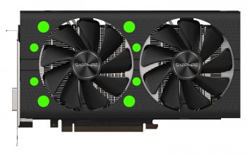

Thermal pad?
You can adjust the required clearance by adjusting the layer count. It's computer orientated, compressible to absorb sock, non conductive, good heat endurance, cheap, and you can cut it into whatever shape you want.
Reactions: bsbeamer
Thermal pad?
Thanks! Stacking thermal pads in a few spots could probably work for this and may be the safer option. May need to leave the top layer with the non-adhesive cover intact.
The thermal pad isn't that sticky, I won't worry about its adhesiveness. In fact, a little bit sticky to make sure it always stay at the same place is good (it's so close to the fan)

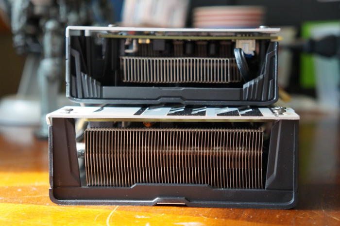

I didn't know the Pulse RX 580 is slightly wider than 2 slots. If you need to use PCIe slot 2 then you could choose a different RX 580 card that is 2 slot, and there is also the single slot WX 7100.
The PULSE is definitely a 2.0 slot wide card. It's higher than the 1080FE, shorter than the 1080FE, but both of them are 2 slot wide.
If it's a 2.25 slot wide card, it would block slot 2 (like what the Nitro+ does)
The Nitro+ (lower) is 2.2 slot wide (43mm), and the PULSE (upper) is 2.0 slot wide (40mm).
It's the protrusion of the fan beyond the card housing that encroaches into Slot 2 airspace. It may not be 2.25x wide, but it pushes the limit to the extent that the adjacent slot is limited in use. Perhaps it's a 2.1x wide card...

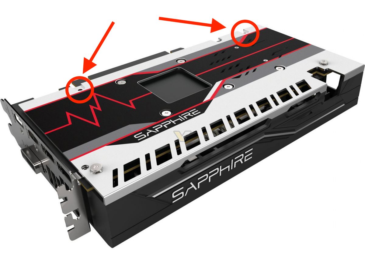

May I know if you removed the 2 screws for the backplate right next to PCIe connector? I did
Reactions: MIKX
There is no such problem in my case.
No, I didn't remove them. They aren't causing a standoff on my card at all.

All those screws on your card is completely flushed?
The very first thing I did was remove that two screws when I got mine. I know they shouldn't affect the card to slide into the slot. But as long as those screw can touch the cMP's CPU cage. That means even 1mm extra thickness may cause some unwanted annoying issue like what you have now.
I don't know if it help anything in your case, but may be worth to try.
I did not remove any screws, kept the card "as-is" when installing for this test. Next time I install (likely next week) will look at removing those two screws to see if it addresses anything. With the drooping of the card above, I doubt it will make any difference.
Measuring from the base of the bottom screw that overhangs the backplate to where the fan blades protrude above the case/housing, I'm seeing approximately 44.5mm. My previous understanding was standard two-slot/double-width/dual-slot cards were 40mm (maximum) and single-slot GPUs were 20mm (maximum), but I guess this is not a universal standard. I've seen several single slot GPUs under 20mm (such as the GTX 1070 Katana at 16mm).
I already checked that, the screws aren’t causing a standoff in my install. It would be fine if I were using a smaller card for slot 2, but my particular card encroaches on PCIe Slot 2 airspace for a full size card.
