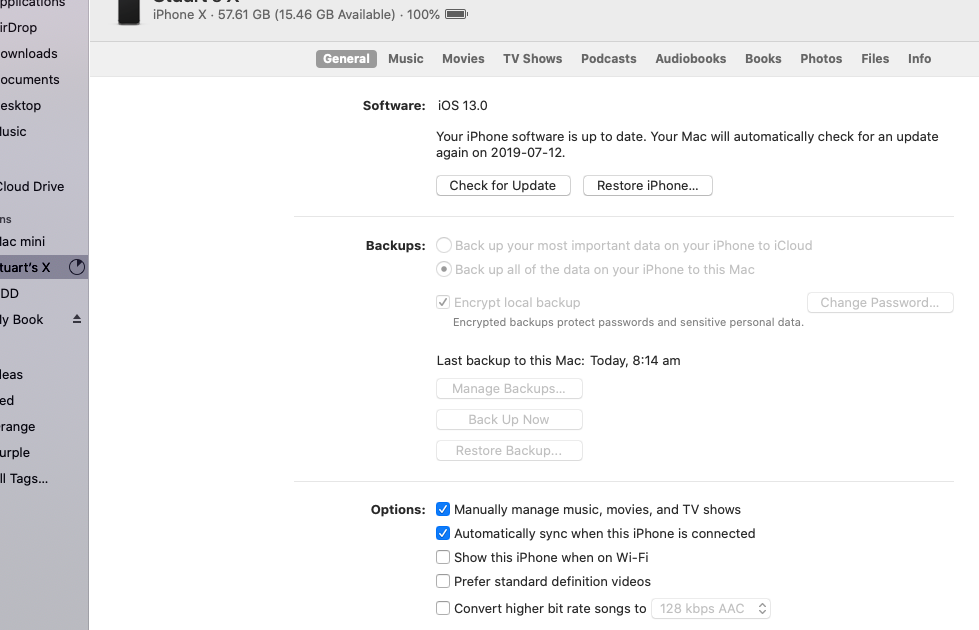

And now the somewhat positive news...i've found a workaround that is supremely figitty but it works for now.
Running Catalina Beta 2 and iOS13 beta with "Manually manage" box checked.
1)

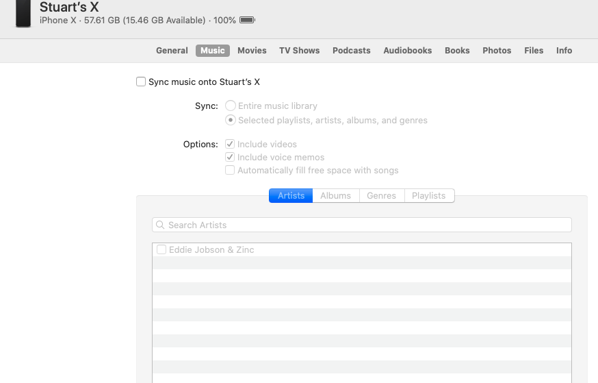

2) Click the "music" tab to see the window...

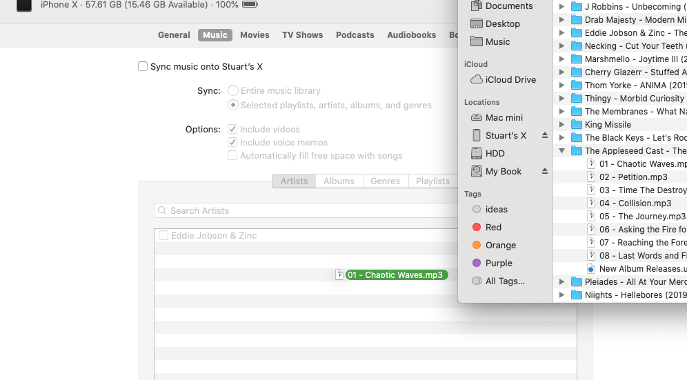

3) Drag just first song (track 1 or whatever) to that window but WAIT until you see the green plus sign (+) to appear before dropping or it won't transfer (the plus sign usually appears as you first drag it over).
Then drop it anywhere in that library looking window.

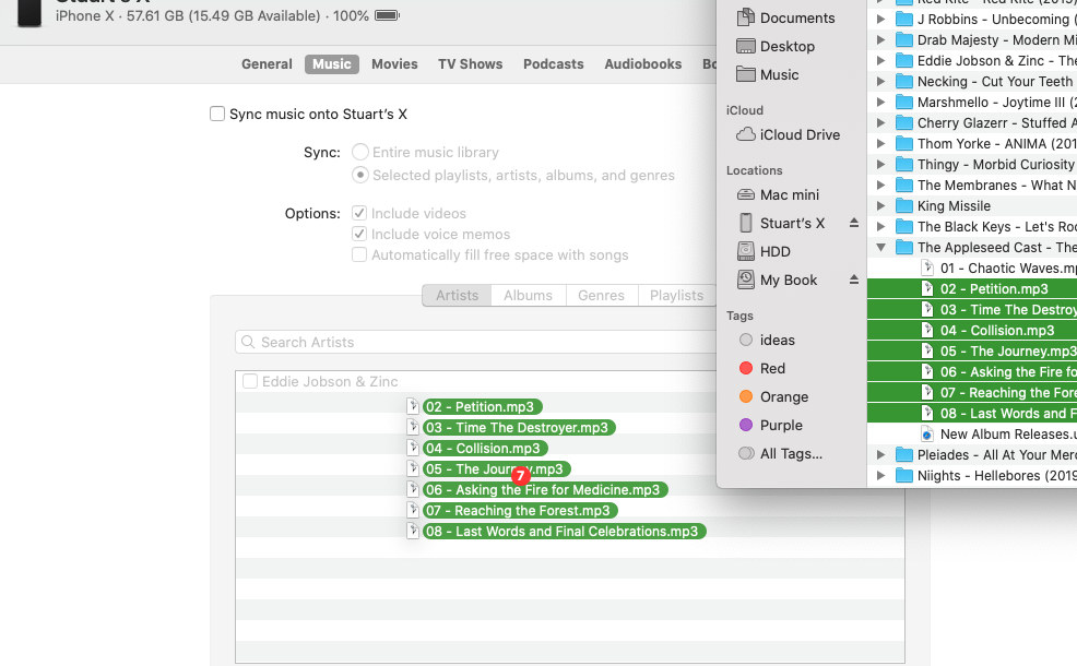

4) Confirm on the iPhone that the track has transferred then go back and grab all the other tracks and with green + appearing, drop them in the same place.
The iPhone should creat ONE album with all the tracks in it.
Weirdly, EVERY TIME I do this, I have to go back a third time and get Track 3 of EVERY album as it never transfers over.
