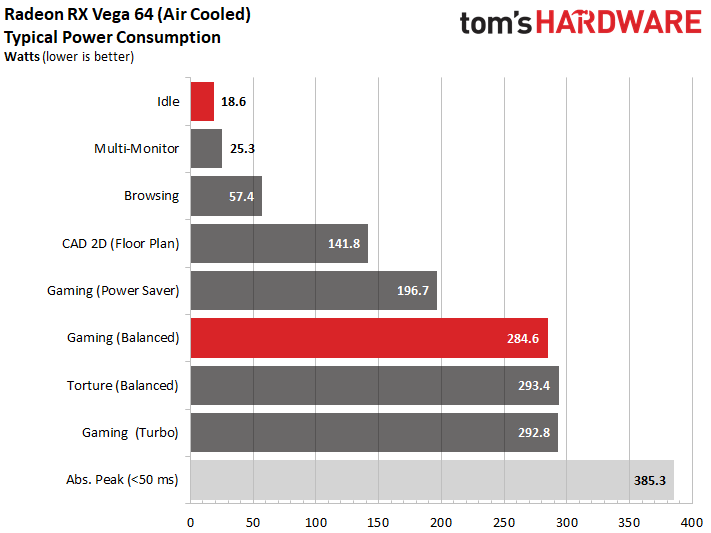

On the other hand, TDP is just for thermal capacity calculation. Not really the card's power draw. Especially TDP cannot reflect the power spike. A Vega64's peak power draw can be quite high. This may be the reason why causing the shutdown. The SATA port never designed to handle the GPU style power spike.

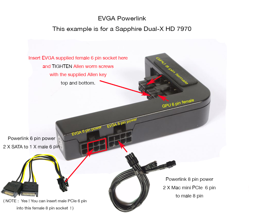

It may be that you did not do the EVGa PowerLink setup correctly.
I currently power my MSI Armor 580 8gb using the EVGa PowerLink which is not directly connected to the GPU. It sits on top of the PCI area Fan.
Please take a look at post#1
https://forums.macrumors.com/threads/evga-powerlink-with-amd-gpus.2166917/#post-27038019
In particular .. . this pic is important
the above photo shows how I setup the PowerLink for a flashed HD 7970
EDIT : IMPORTANT : Note that the 2 x sata to 6 pin go to the PowerLINK
Please tell us in detail how you did your EVGa PowerLink setup
May I strongly suggest that you go here and make a Macrumors SIGNATURE including everything relevant to your cMP. Having a SIGNATURE will help us to help you - it will appear in all of your future posts.
As an example please take a look at my SIGNATURE below.
I'm not using a Vega 56 but just to be clear re PowerLink setup here is my 7970 setup
It is very easy to get something wrong.
If, as you have stated, your Vega 56 works when powered externally it seems obvious that you have made a mistake in your internal cabling setup
Please tell us IN DETAIL how you did your EVGa PowerLink setup.
No one is condemning you - we want to help and if we are successful that solution will be very useful for other Vega 56 owners.
