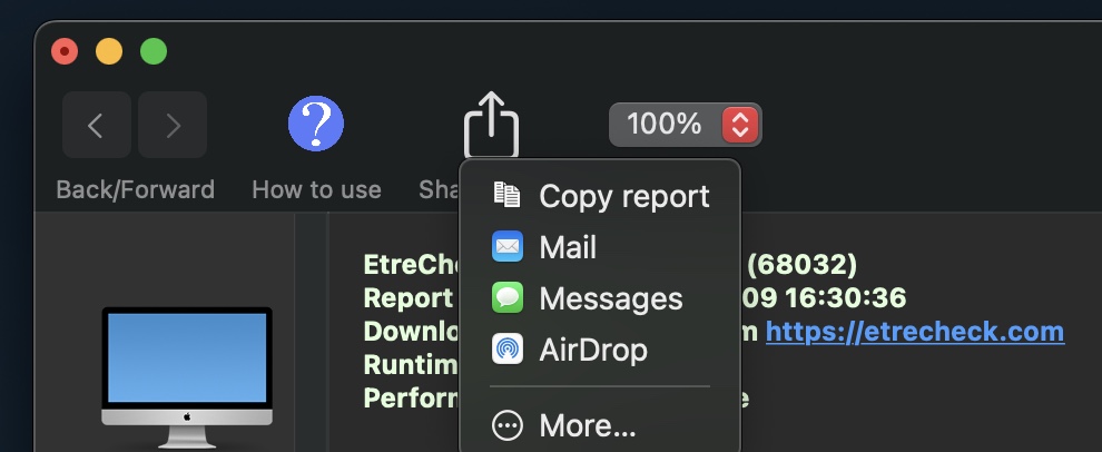

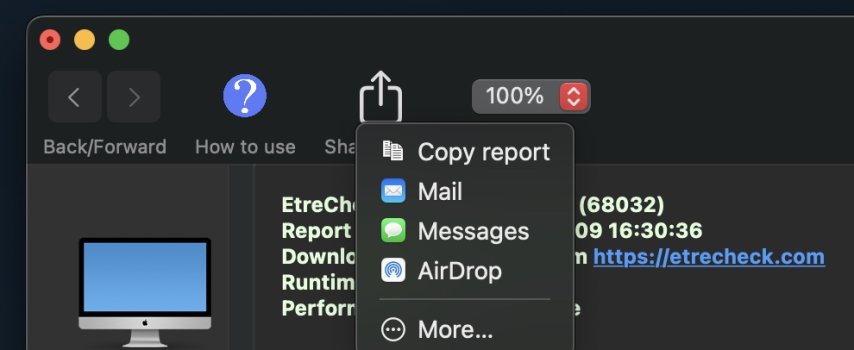

I've ran an etrecheck, I'm not sure what part to paste and if there still is someone to help me figure out what is going on
Left side bottom says Report, it's menu bar has the share icon, copy report, open the site you want to paste the report to and there's no info about you included.
