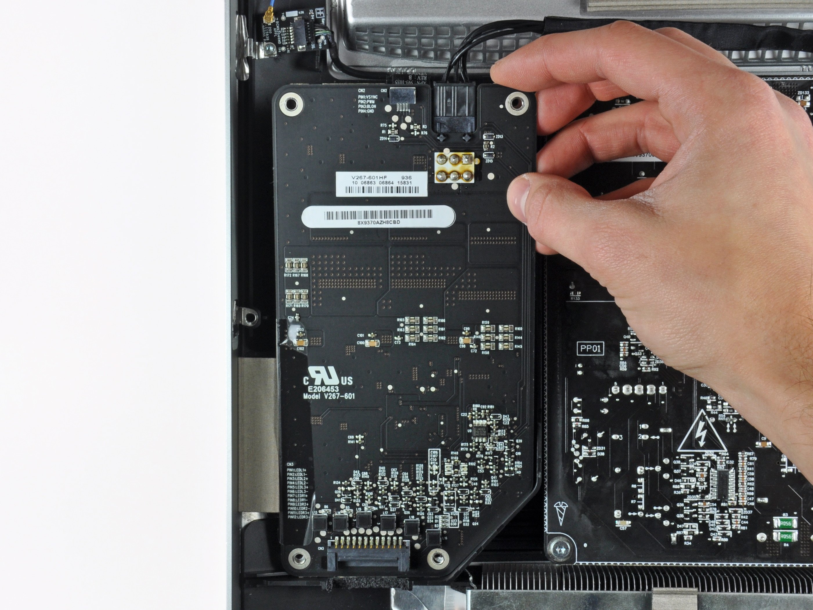

So I got the video cable in today, it fits perfect. Another problem popped up. The connector on what I think is called the power board came unsoldered. Anyone know what this board is called? Just gonna order anew one. It's the board that has 2 connections to the LCD panel, sits near the top of the case off to the side.
It's the LCD backlight board, LED driver board, etc. depending who you are talking to.
Ifixit has a guide on how to replace it.
The board is not very expensive, but if it is only de-soldered, you can re-solder it back in place, for faster result.
