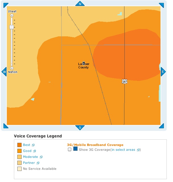

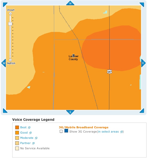

For those that are having success, would you mind going here
Coverage Viewer
Here is mine. FWIW, I tried this and did not have success.
I wonder if those that are are in very strong areas

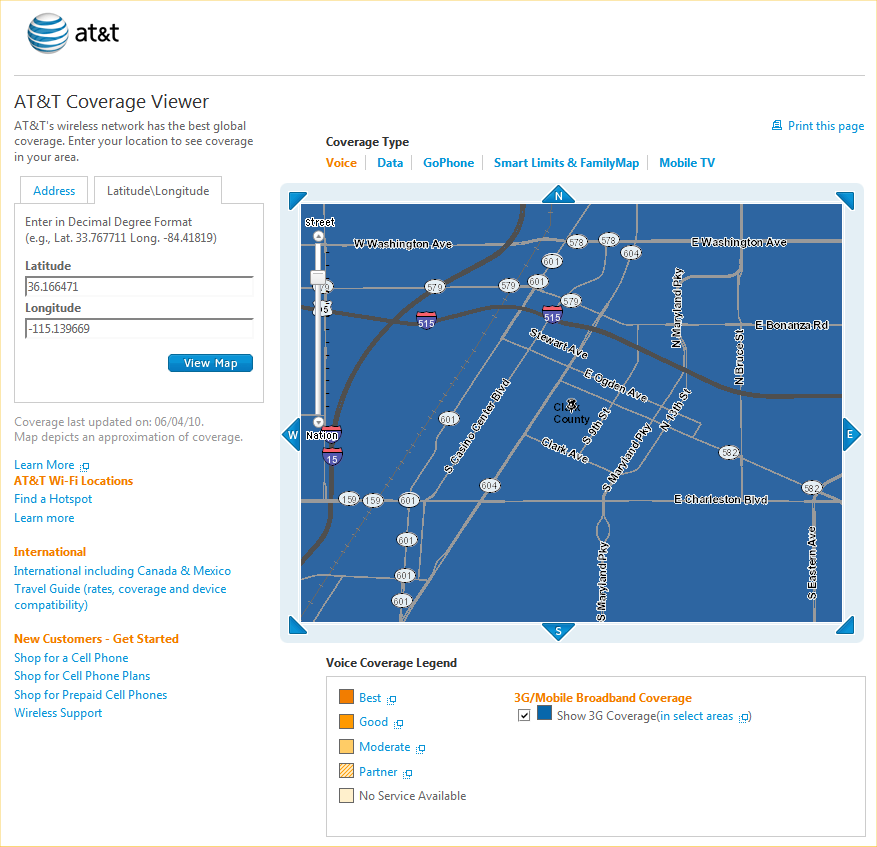

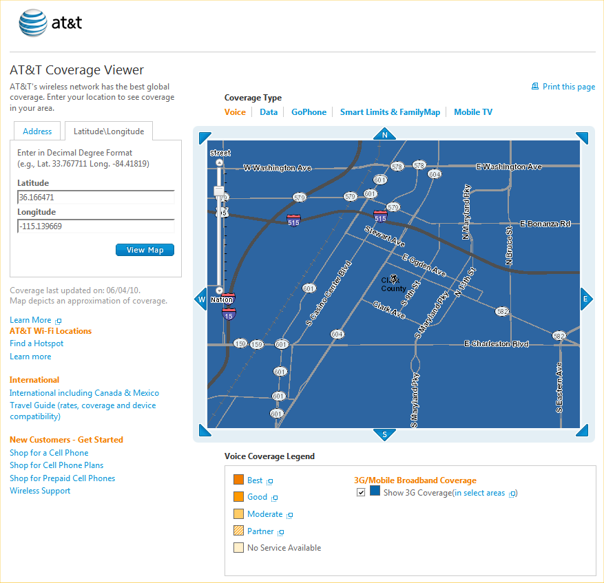

My "approximate" location up on my 3rd floor balcony, line-of-sight with an AT&T cell site/tower on the AT&T building here in downtown Vegas. I'm blanketed, service coverage isn't an issue, I assure you. :)
