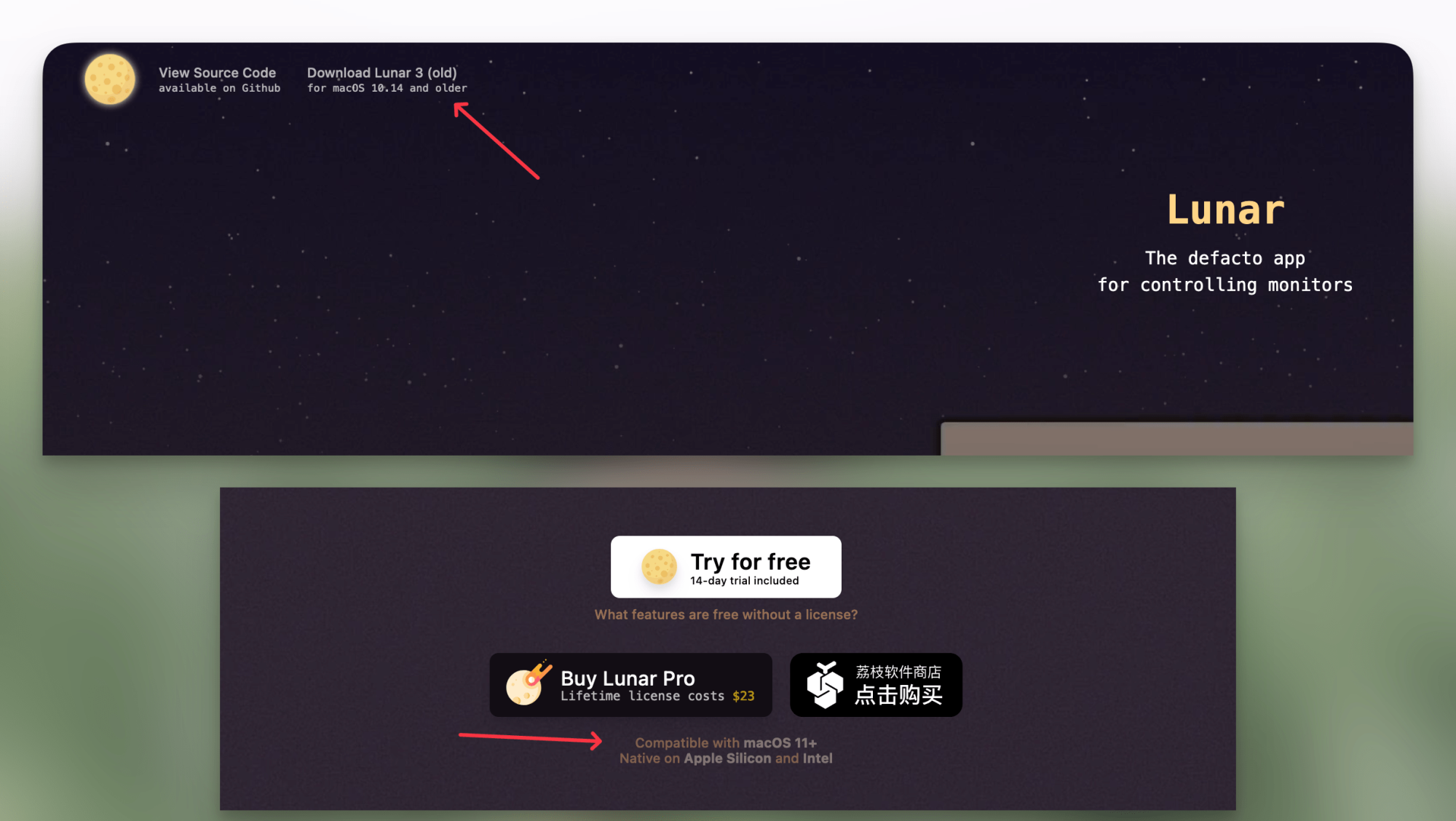

Bravo on making an absolutely exquisite looking app (actually, all your company's apps look like great pieces of utility), and addressing an edge case for difficult functionality.
Do you think your app can provide a solution to the issue of DisplayPort monitors disconnecting from the system when they sleep (an idiotic part of the DP spec)? That's one of the big contributors to multi-monitor issues as far as I can tell.
Only feedback I'd perhaps offer is if your website could make it a bit more obvious that Intel CPUs are supported, and what the supported OS versions are (and do you have older versions of the app for older OS versions that can be activated when you buy the current version serial etc).
Thank you for the feedback! I tried to make it clearer what devices are supported with the following additions:
The older version of Lunar (version 3) is completely free and open source and supports macOS 10.14 and later (Intel only).
The newer version of Lunar (version 6 at the moment) has a free tier and is source available for free features and supports macOS 11 and later (both Intel and Apple Silicon)
