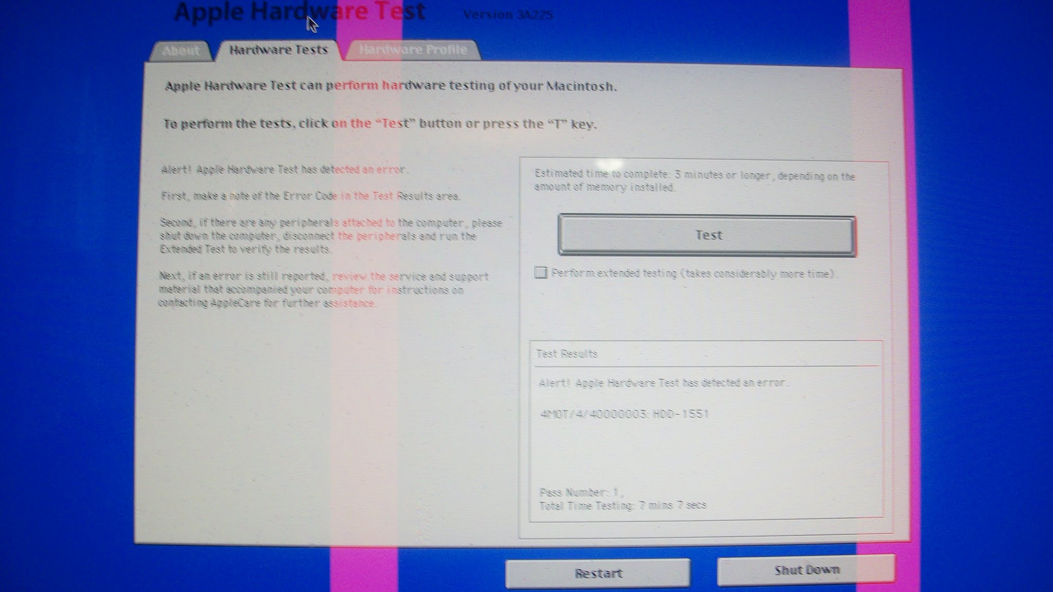

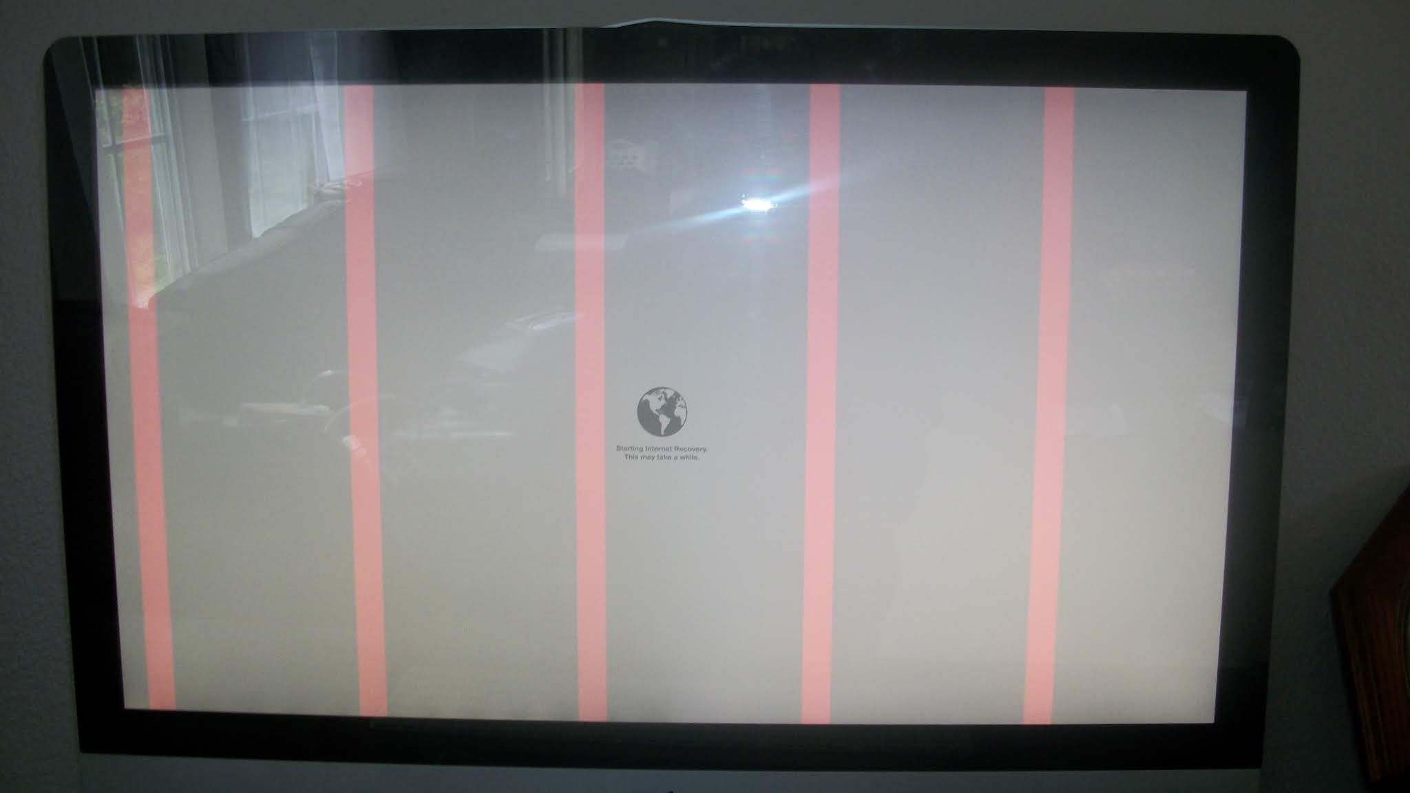

I was using my 2011 27 inch i7 Imac and the screen suddenly went green! And i had to shut it off with the power button. And now it doesn't boot up anymore! It will start up and display pink bars
and start to load but then it will get stuck and then restart. And it will do this until you turn it off. Originally i thought it was a bad GPU. I ran the Apple Hardware test and it threw a 4MOT/4/40000003 HHD-1551 code
which simply says that the hard drive fan has gone bad and that has nothing to do with the symptoms my Mac is experiencing. I read some forums about this issue and there was mixed opinions about the issue. Any help is appreciated.

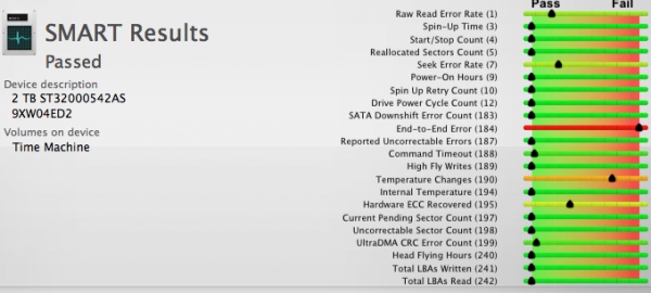

HHD fan bad is the likely cause but that isn't what you're seeing.
The heat from the HDD cooks the components in these. The drive is bad. These go through a lot on their way down while still passing SMART in Disk Utility. This is a typical example.

This does not mean you don't have a bad drive. Run Disk Repair in Dusk Utility. If anything shows up red, get that drive replaced ASAP. If the result is green, still get the drive replaced but you have more time.

I ran the First Aid test in Disk Utility in Recovery mode and it says that the drive is "OK".
Not the same as running Repair. That sometimes finds issues that Test misses. It takes a few minutes longer and if everything is still good, that's great.

Sorry, got confused thru the thread. are you sure it's not just the GPU?
I just had the same grey screen/pinkish bars - and did the "bake the GPU" hack to great success.
I'm not clear how you determined this was not your issue?
