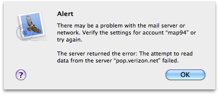

I still wonder what's wrong... I did a little digging and it looks like AOL does indeed use IMAP. That's a standard—it really shouldn't change. Do any errors appear in the console when you try to get more mail?
I get this.

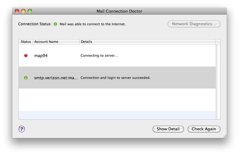

Here's what it says in Mail Connection Doctor.

I was wondering about /Applications/Utilities/Console.app, which may provide more information. When you try to connect in Mail, do any errors appear in the console?
