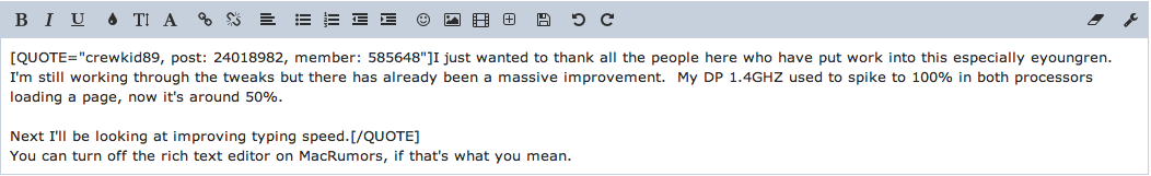

You can turn off the rich text editor on MacRumors, if that's what you mean.
You'll want to click that button in the corner that looks like a wrench.
OK. It's just a common issue people bring up a lot, so I figured that's what you were talking about. Sorry.
No worries. Just meant it isn't only a problem here. I had already known that one from awhile ago. Otherwise macrumors seems to work remarkably well even on really old hardware.
