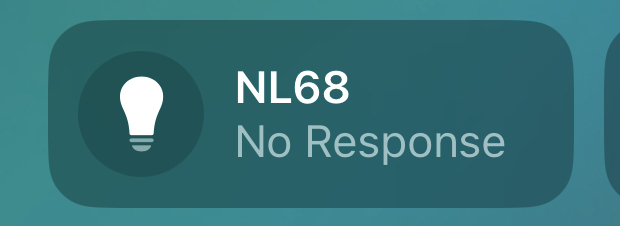

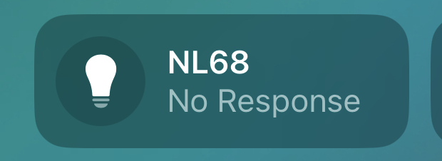

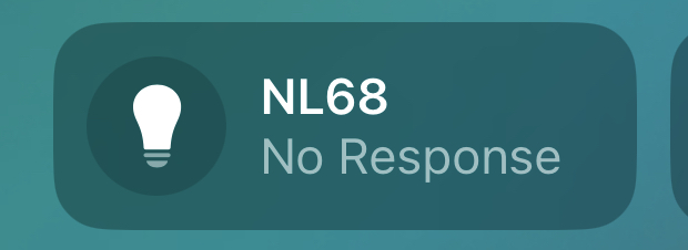

I just received my Nanoleaf Lightstrips, and I've been trying to set them up for 3 days, with very little help from their Tech Support. For some reason, when I try to add the accessory through the Home App, it recognizes the Lightstrips, but then it will say the Accessory is Unresponsive.
If I add it through the NanoLeaf App, I get a bunch of errors, yet, I'm able to control the lights, but it should work in the Apple Home App, since it's Matter based. I followed every instruction to the T, and nothing seems work and I can't operate it through the Apple Home App, especially since it is Apple HomeKit supported.
Can anyone shed some light to this? Thank you so much for your help!

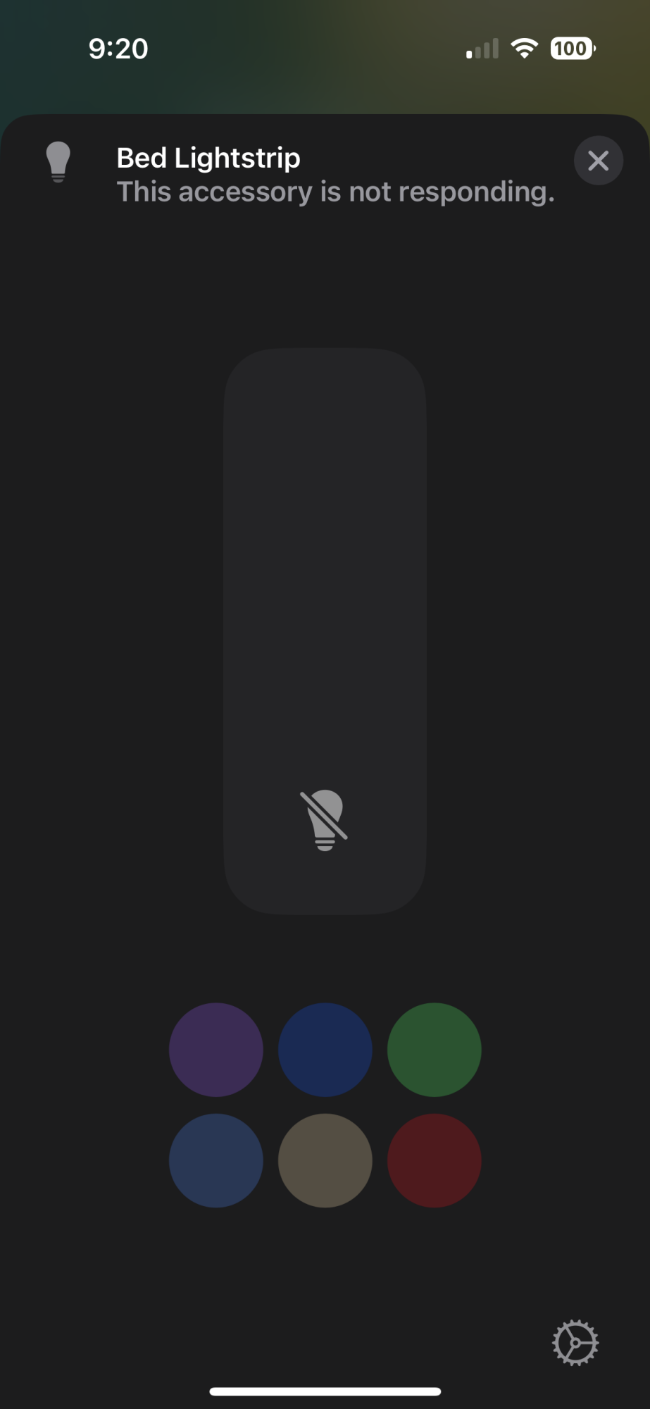

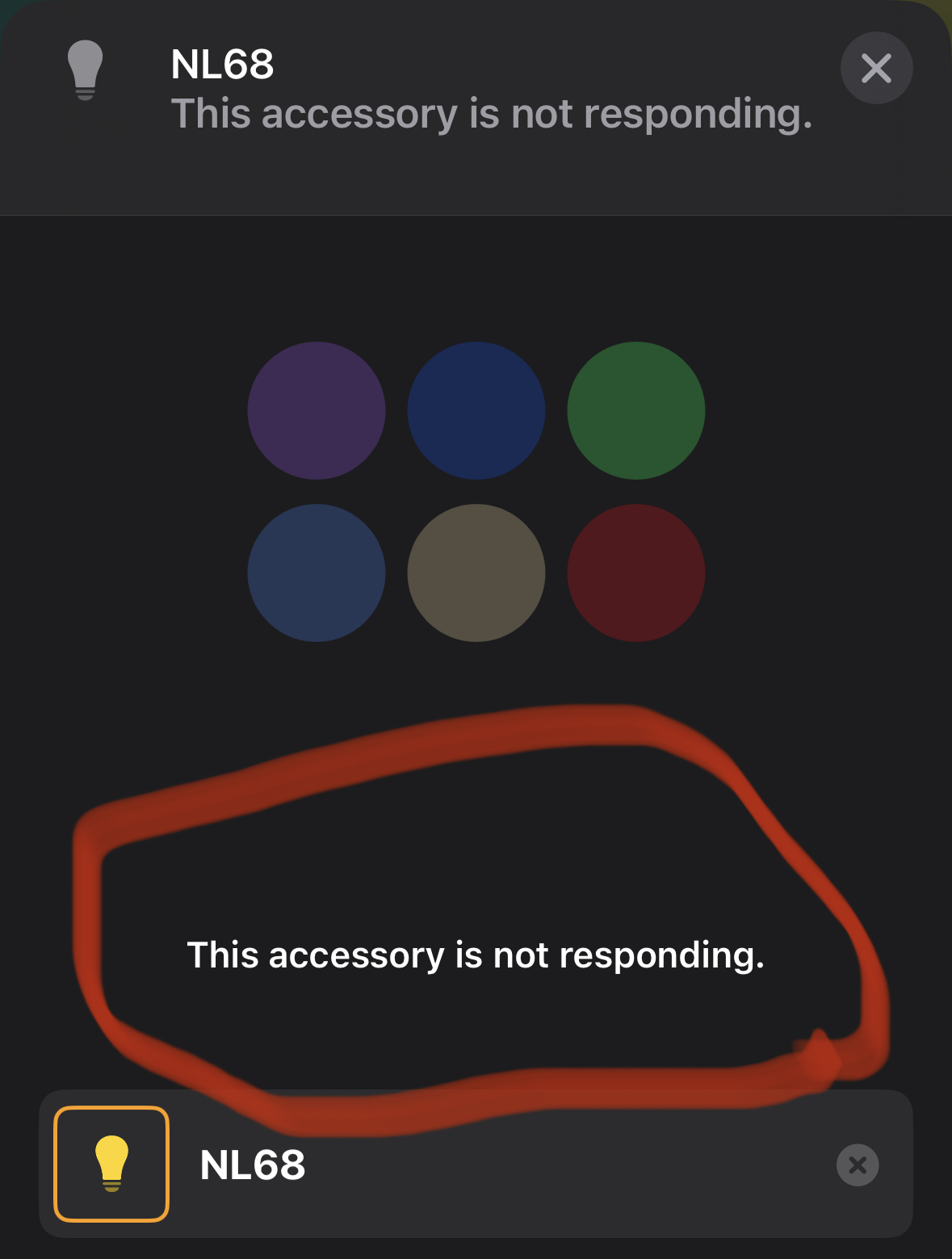

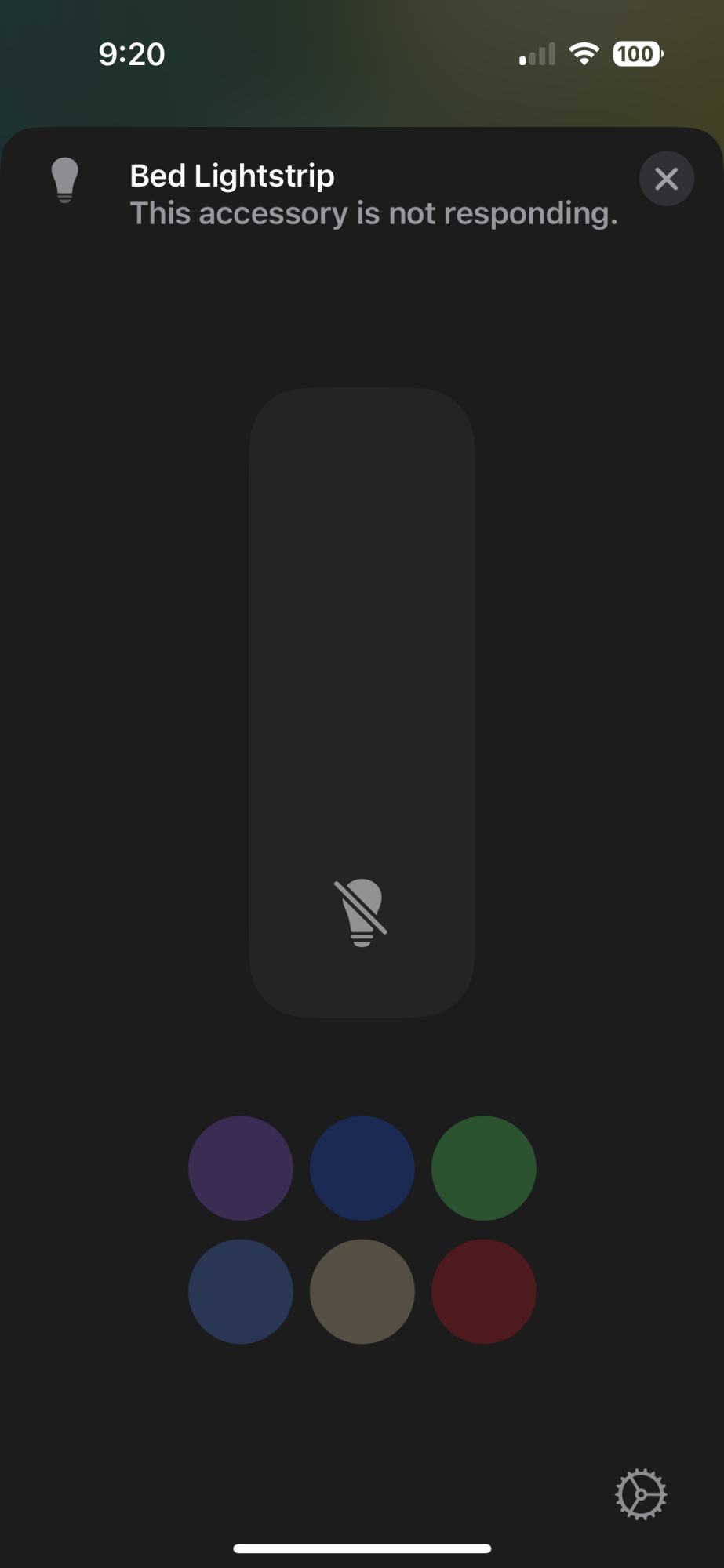

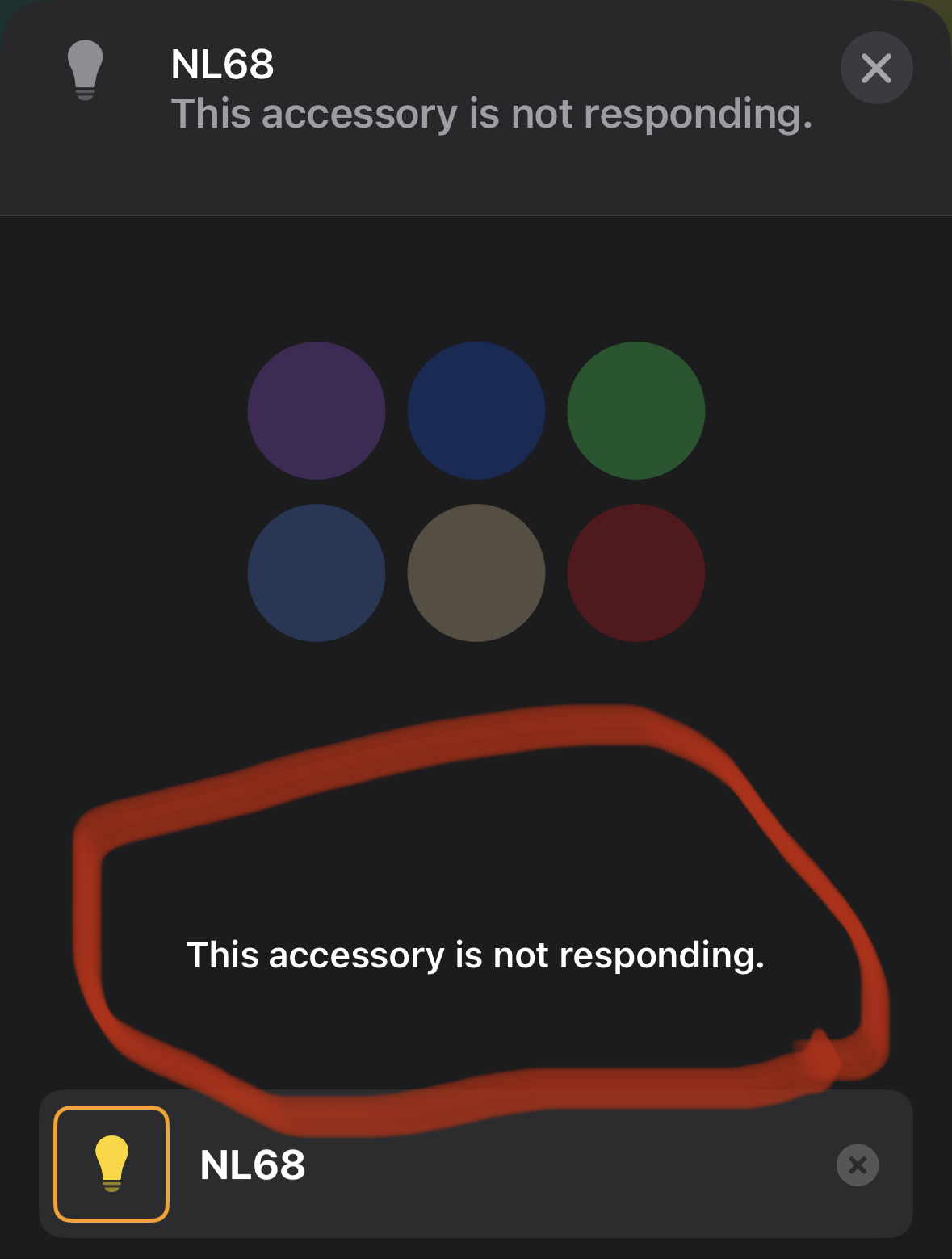

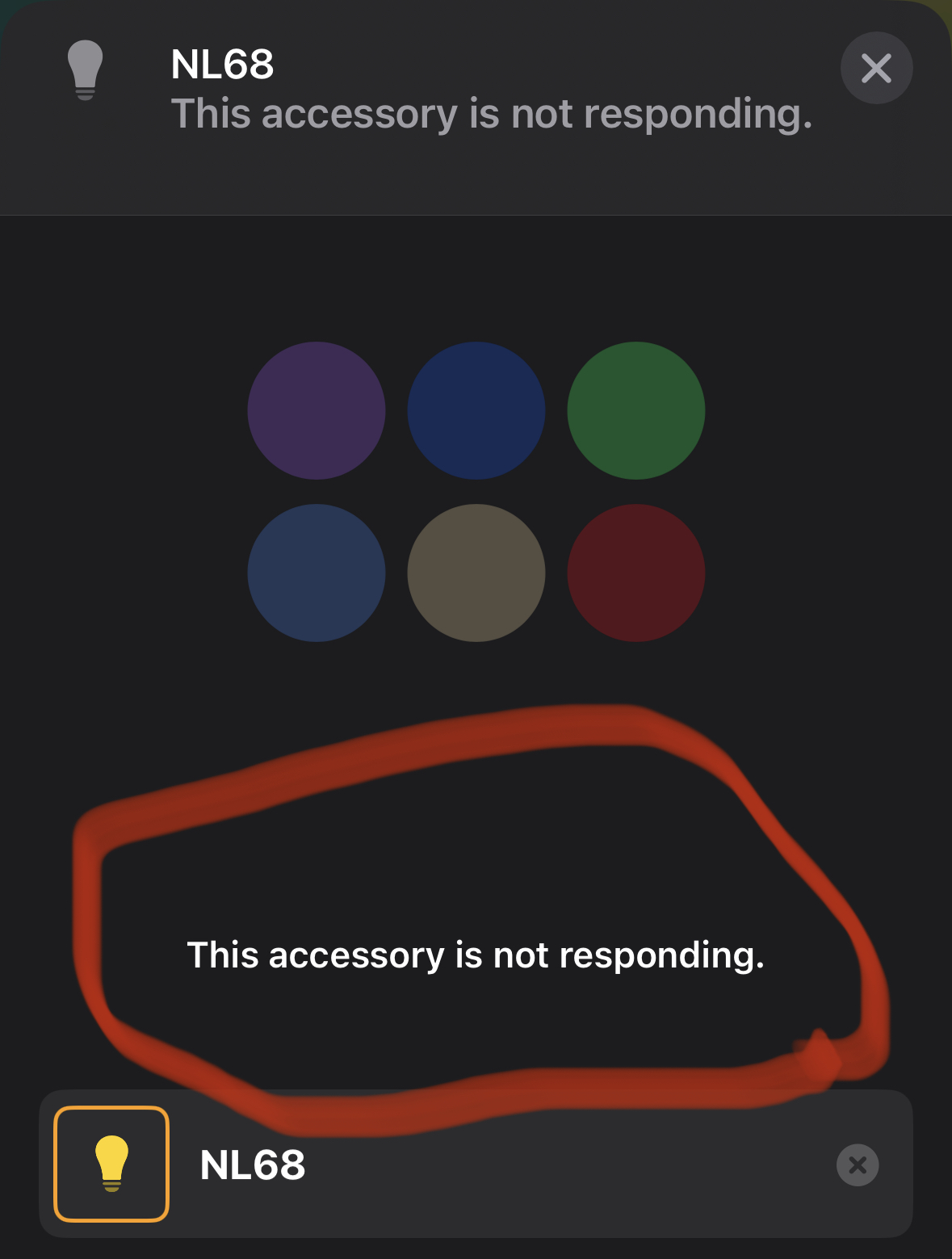

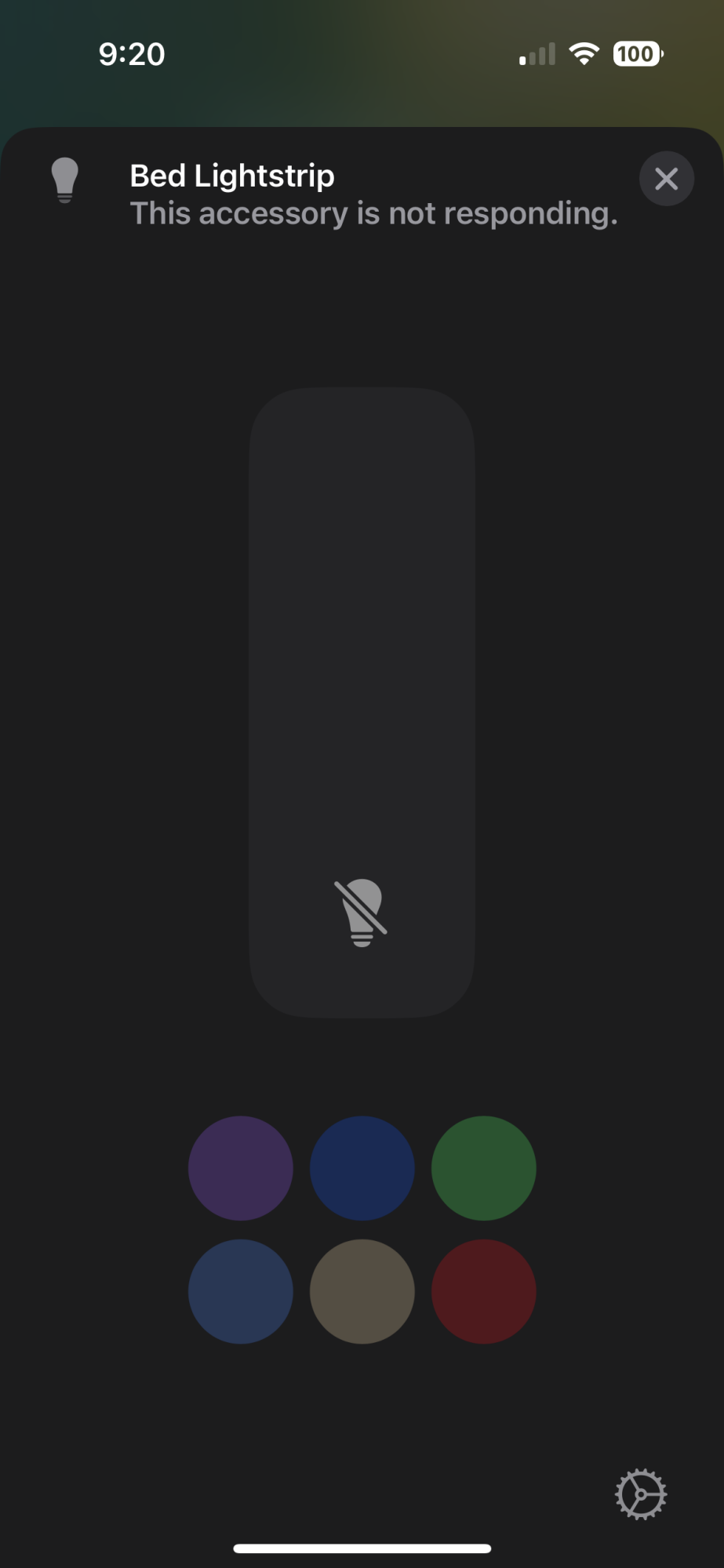

Here are some screenshots:
