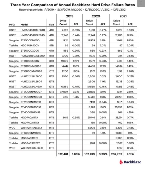

That is one of the concerns that I am still considering whether or not to buy a NAS which is not a cheap investment. It is like putting all eggs in a basket which could drop. I think somebody mentioned that when his NAS was rebuilding the RAID, something happened and all 4-5 drives die.
The attached image is the closest thing I can find for good data on hard drive fail rates as BackBlaze does a published annual comparison/release. Do keep in mind that these are more than likely enterprise level drives which are more reliable than consumer ones, but you will not really find any major comparisons with good data sets with consumer drives since even a small business will eventually switch from consumer grade (if started with it) to enterprise as business grows that is why it is hard to find. Also keep in mind that these drives pretty much will have no downtime besides when maybe they are getting maintenance done throughout the year which is also why it is good data set. So even IF a enterprise level drive is 10x less error prone than a consumer at a pretty much 99% uptime of reading/writing you are look at what 11% for a Seagate 8TB. *please keep in mind my 10x is a guess and I do not think the difference is this high if you have never had a hard drive fail on you before then a NAS drive is even less likely because even a consumer one is rated for a higher workload than a standard HHD* Synology and Seagate (or whatever company drive you choose) also has built in software or software available to keep regularly of drive health so the likelihood of sudden failure is slim and you can see when it detects a drive showing signs of failure for you to get a replacement whether that be through warranty or a new one if past warranty.
