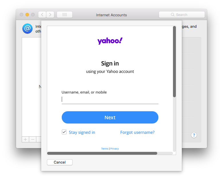

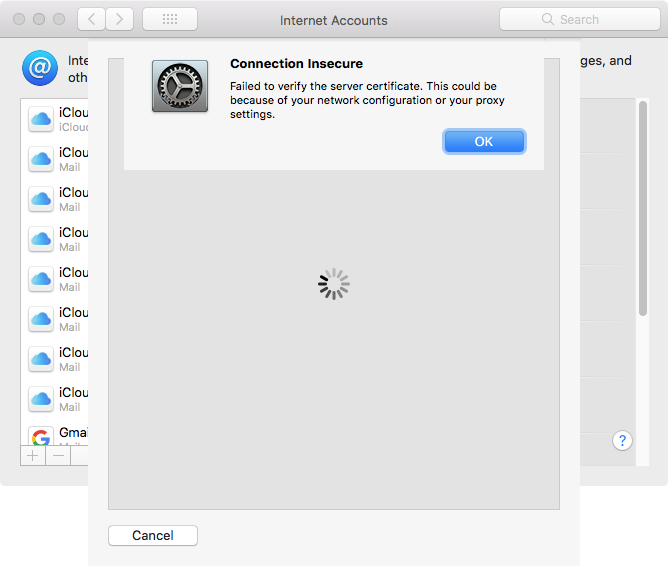

3. System Preferences > Internet Accounts > *adding a Google or Yahoo* account pops up a perpetually loading empty window, and an error popup on top of that.
I get error: "Connection Insecure / Failed to verify the server certificate. This could be because your network configuration or your proxy settings."

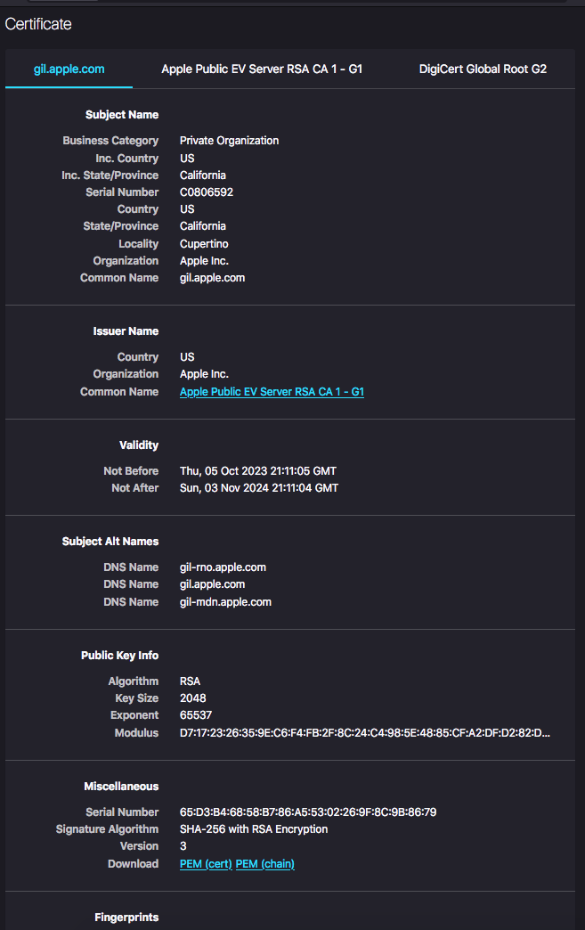

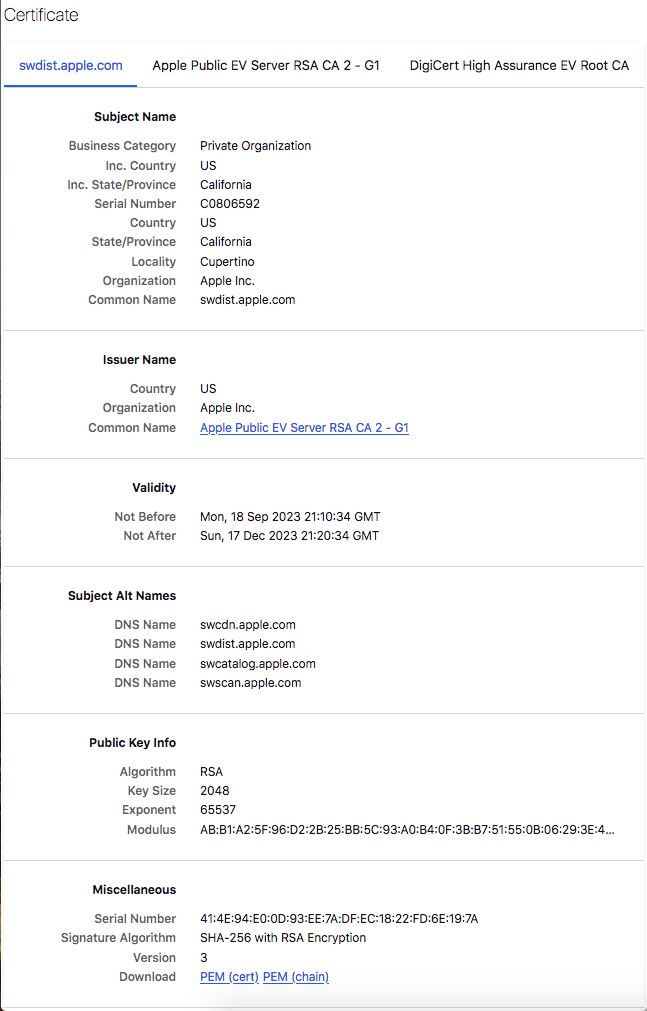

Apologizes. I misread your Solution A.
From your test results, High Sierra did not have problems talking to amp-api.apps.apple.com. That's a host for part of the App Store function.
But all of the error messages indicate that High Sierra couldn't establish a secure connection to Apple's server.

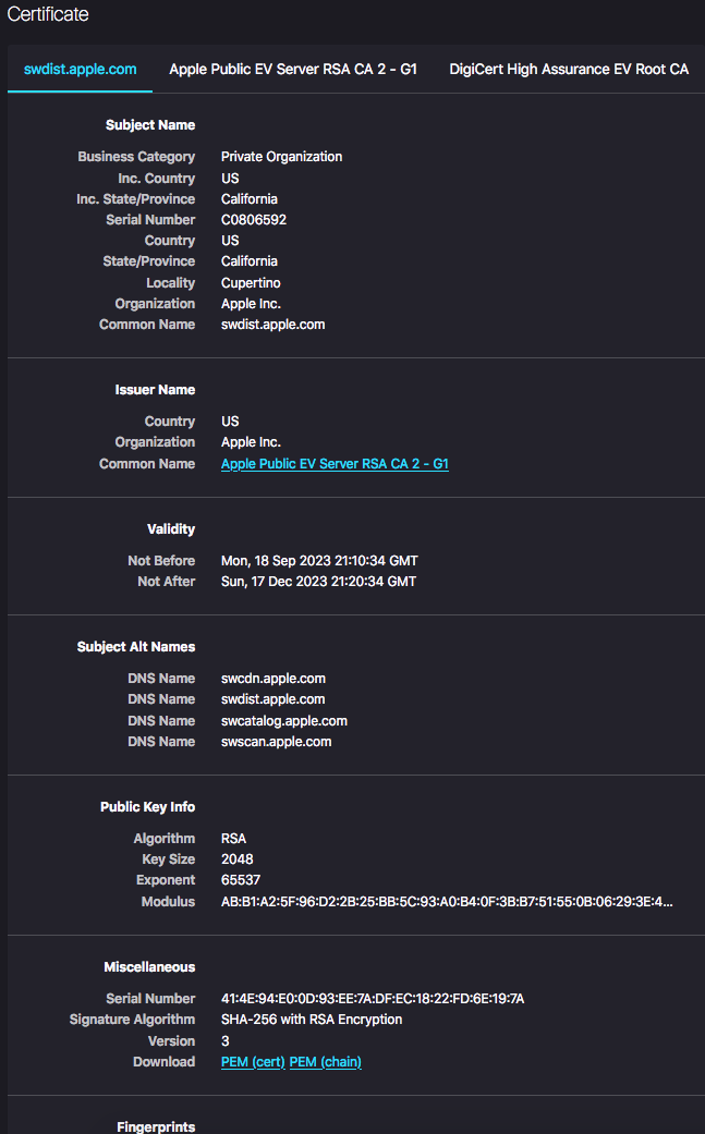

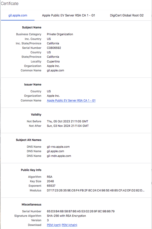

It might be necessary to test other Apple hosts to find the culprit. If you don't mind the tediousness:
In Terminal, run:
curl -vvv -X HEAD https://gil.apple.com/
curl -vvv -X HEAD https://swscan.apple.com/
softwareupdate -l
Also run these 3 commands in your thumb drive High Sierra.

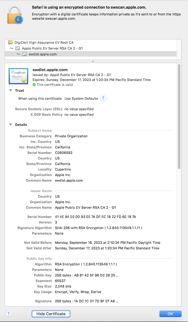

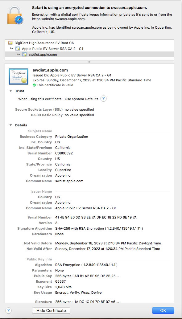

In Safari, visit these websites:
See if you get any error. Also click the padlock icon on address bar, show the certificate, make a screenshot of that.
Also install Firefox browser and repeat.
If possible, repeat in your thumb drive High Sierra.
My speculation is something went wrong when connecting to swscan.apple.com. This domain is responsible for software updates.
gil.apple.com is the one relating to Internet Accounts. We test that for the Error 3.
Where exactly am I looking for errors?
using Safari 11.1.2 (latest in High Sierra)
https://gil.apple.com = blank
https://swscan.apple.com/ = blank
using Firefox 115.4.0esr
How much certificate do you want to see?
Looks like it would take 3 screenshots for full length in Safari, and 7 or more in Firefox (has 2 more tabs worth of info also).
Here are photos of #3, error, and working I thought the failure was getting remote Google/Yahoo data, but you would know better than me.
error:
working (google and yahoo):
image uploading not fast enough here. I"ll have to come back from a non_thumb drive system.
using Safari 13.1.2 (latest in High Sierra)
