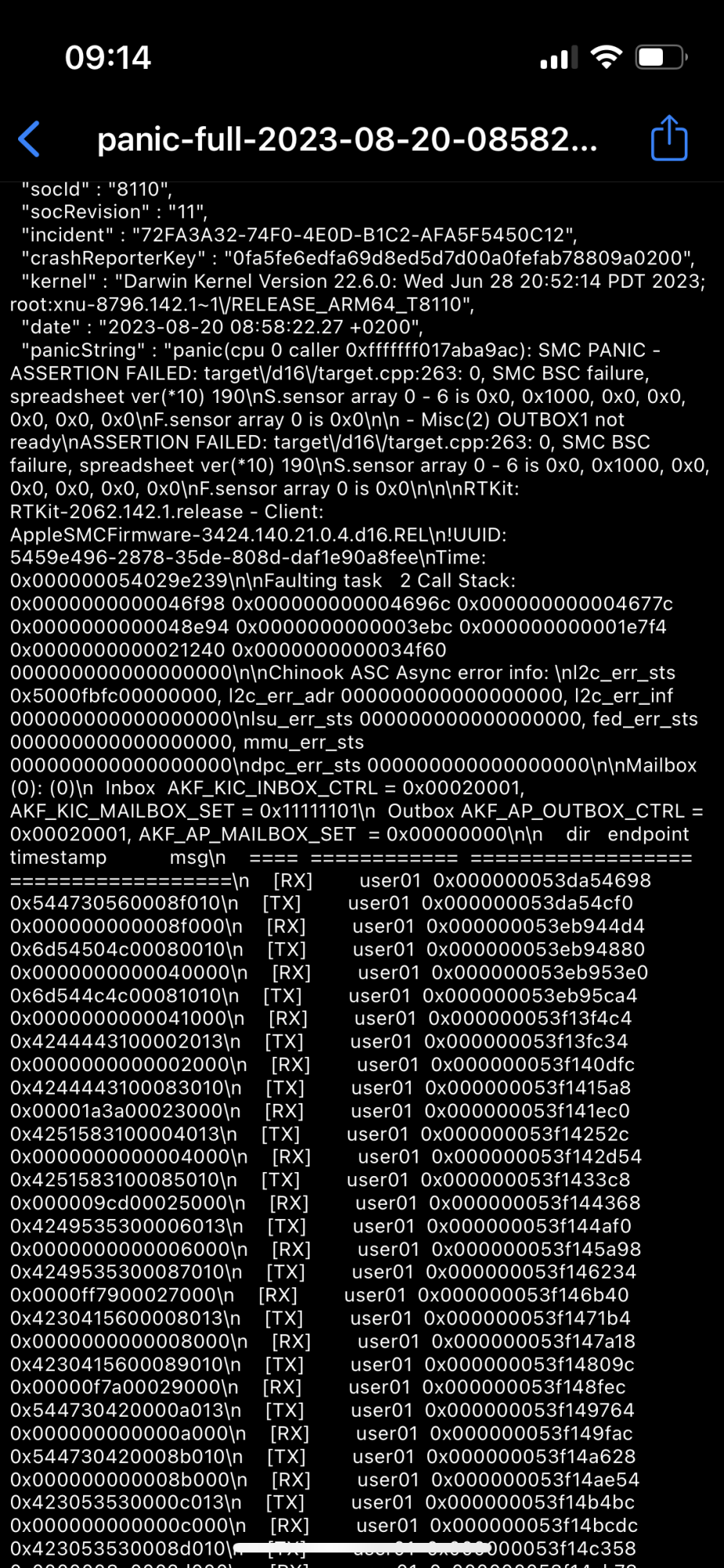

Hi,
my Iphone13 Mini restarts every three minutes. The error log shows a SMC BSC error of type 0x1000, which should be a damaged proximity flex cable. Disconnecting the cable should in theory fix this problem (or not?). However, the problem continues to exist even after disconnecting it. Should I still replace the cable or is there another problem?
To eliminate the possibility of a software problem, I then tried to reset my Phone in DFU mode via iTunes with no success as it still restarts during the reset process. Now it is also stuck in DFU mode 😀 and I can't get out of it unless i resolve this issue.
I would really appreciate the help!

hey, can you send a screenshot of your panic log? my issue was a SMC BSC error of type 0x1000, which meant that the proximity flex cable was damaged and needed replacement.
