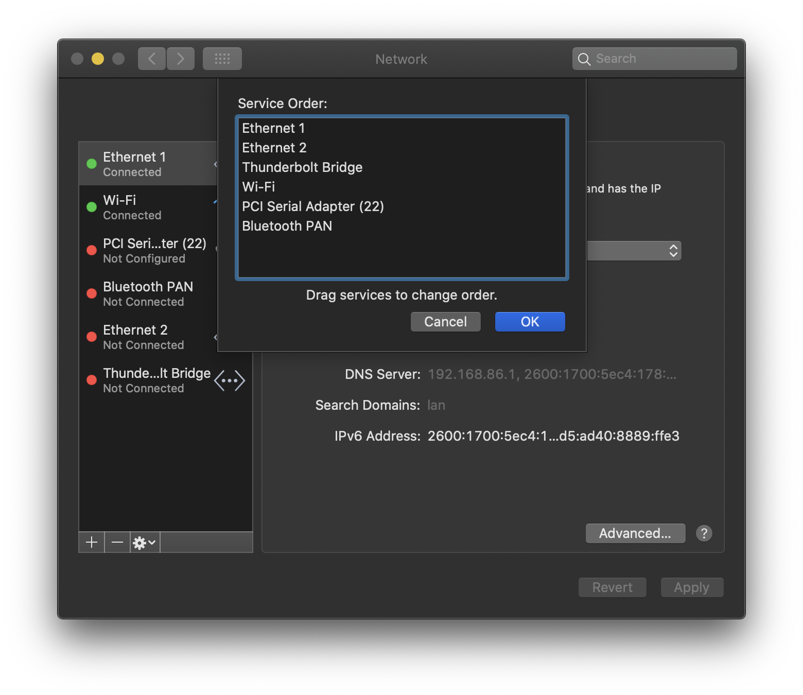

I recently got a Mac Pro (2019). I've noticed some incredible slowdowns on my access to my Synology NAS and then realized it was using Wifi instead of the 10G Ethernet. I would turn off Wifi, reconnect to Synology, turn Wifi back on and everything would be fine.. until.. the computer goes to sleep and then when I come back it, for whatever reason, reconnects over wifi.
Is there anyway to stop/fix this? I need it to stay connected via 10G, otherwise it's incredible hassle to have to do the turn off/reconnect/turn on solution every single time I get back to the computer. It sort of defeats the purpose of a consistent connection.
I was previously using a 10G adaptor on my MacBook Pro and was told the Thunderbolt turns off when it goes to sleep, which is understandable, but a built-in 10G should not have this problem, especially since this is a workstation computer.. Why would it ever prioritize wifi over ethernet?
EDIT 1: Just incase anyone mentions it, my service order is Ethernet 1 > Ethernet 2 > Wifi.

I am puzzled, because as you correctly identify, the Service Order is the way to manage this. It is not clear why this would not result in things working the way you want. Can you post a screenshot of your network prefs?

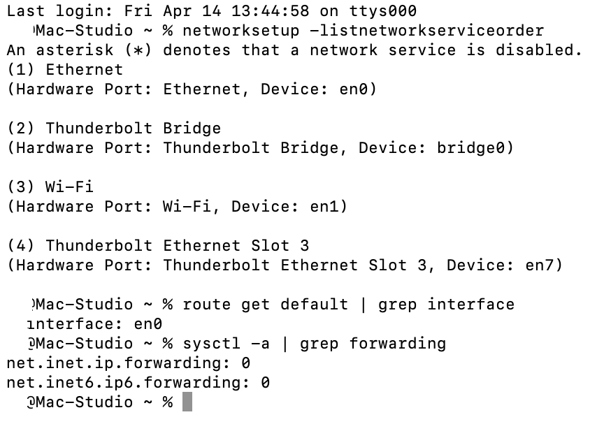

I keep running into the same issue on my Mac Studio. Very unpredictable. This has nothing to do with the NAS.
Right the NAS is not the problem, everything worked just fine with my 27" iMac 2020.
Can't figure out what the problem is though... o_O

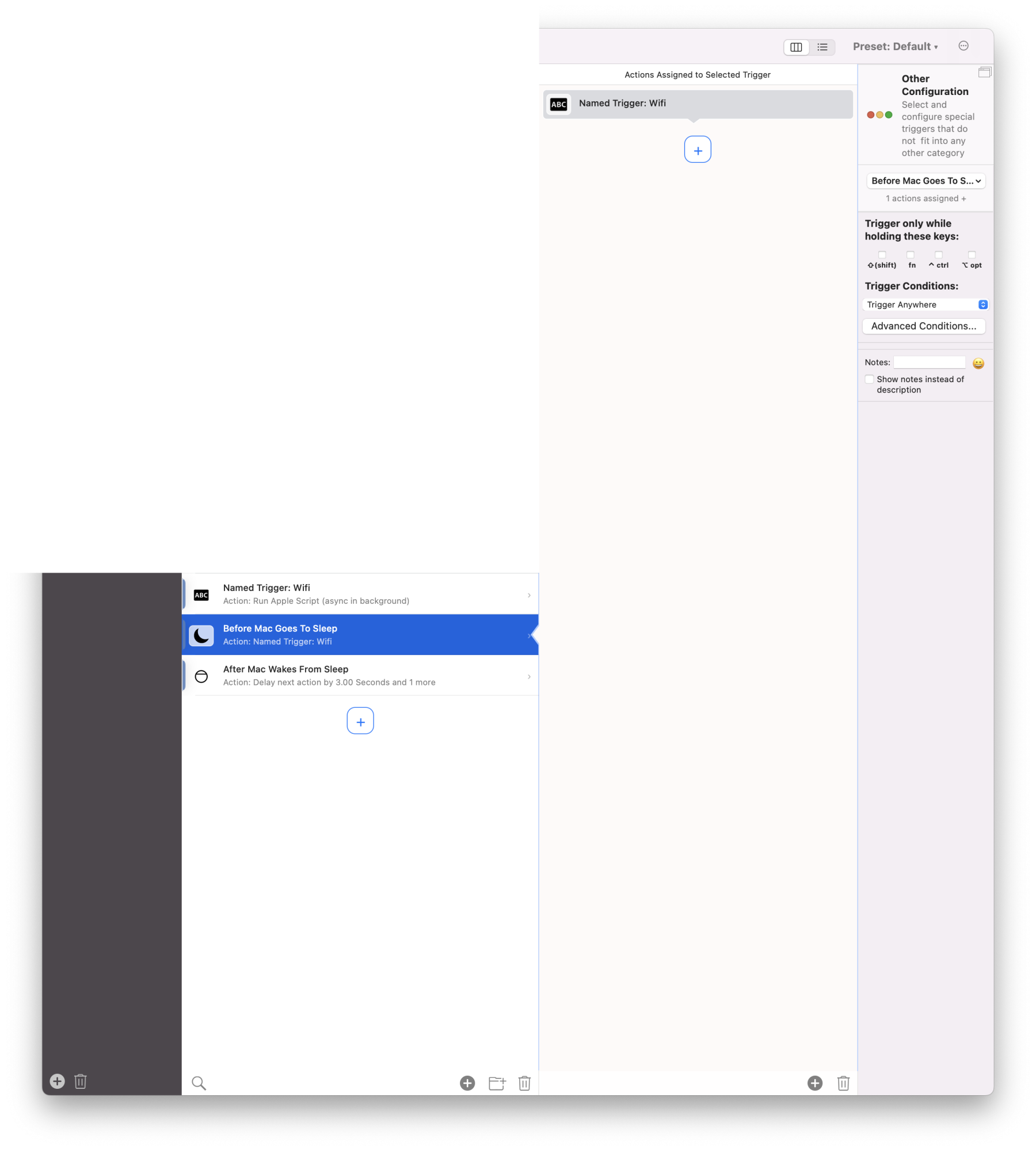

I spent a fair bit of time on this and couldn't figure out why. Everything looks OK after sleep:
But it's definitely connecting on WiFi, and not 10G...50MB/s and not 1170MB/s...what's even weirder is the NAS still thinks it's the IP from the ethernet! I even separated the IPs by 100 on the router...wifi over x.x.x.200+...no dice. I haven't tried VLAN, as that could cause other issues...
The only workaround I can think of is to disable WiFi when the Mac sleeps and turn it back on after waking. Not the solution we want, but if anyone else has figured this out please reply.

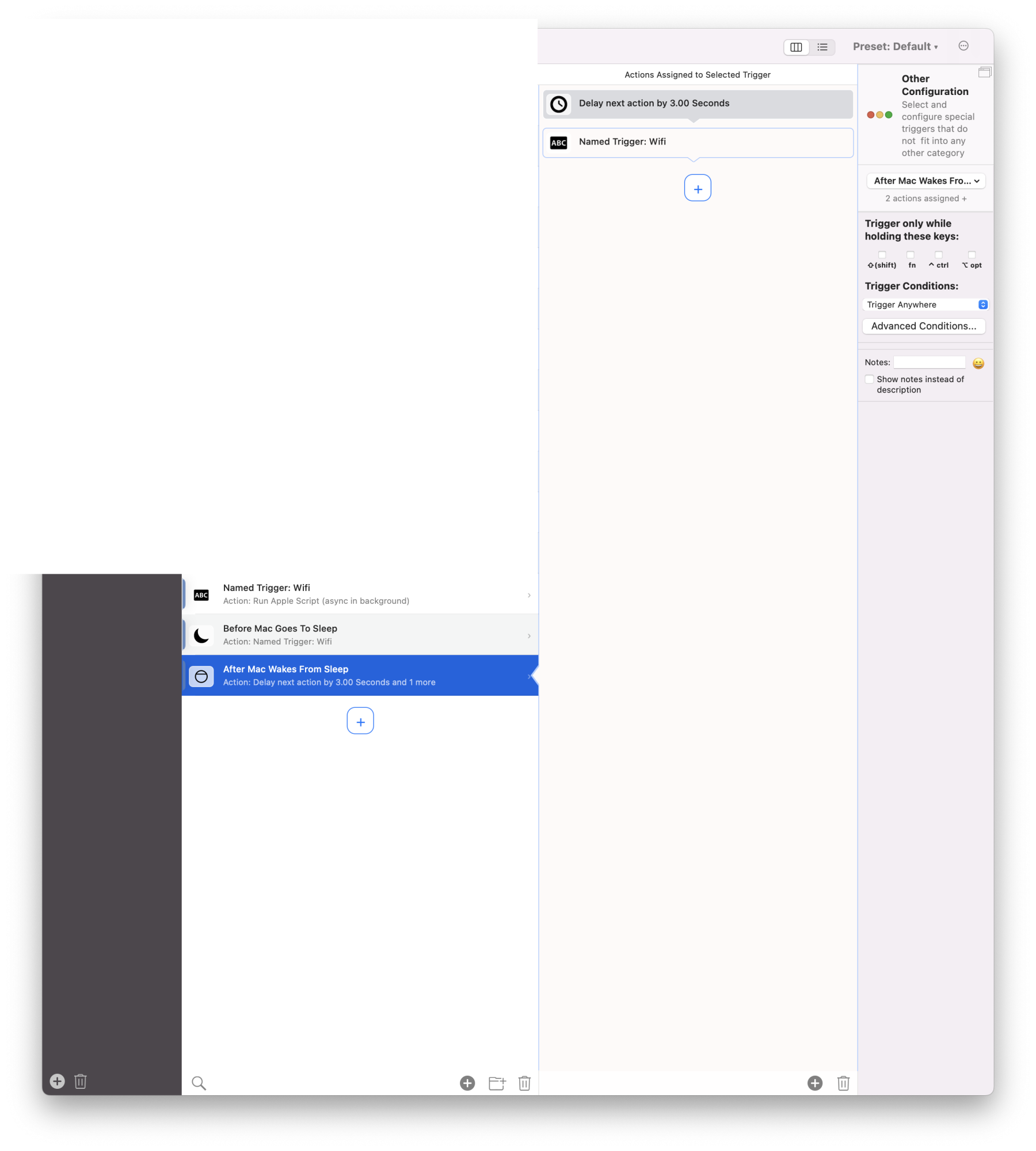

So here's my workaround which seems to work (requires bettertouchtool):
Reactions: ReneeReader
simacc

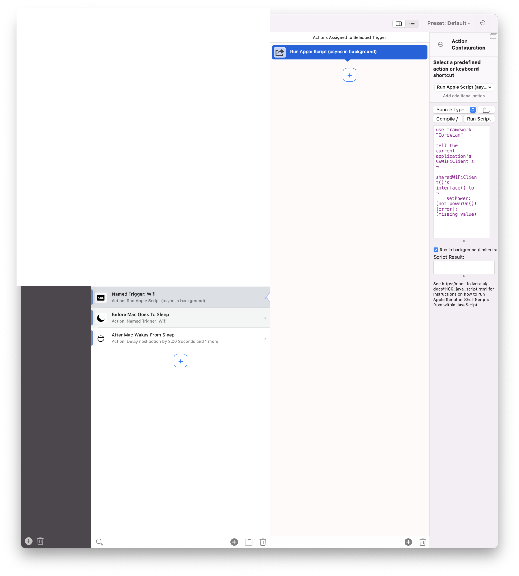

here's the applescript to save you typing it out:
use framework "CoreWLan" tell the current application's CWWiFiClient's ¬ sharedWiFiClient()'s interface() to ¬ setPower:(not powerOn()) |error|:(missing value)

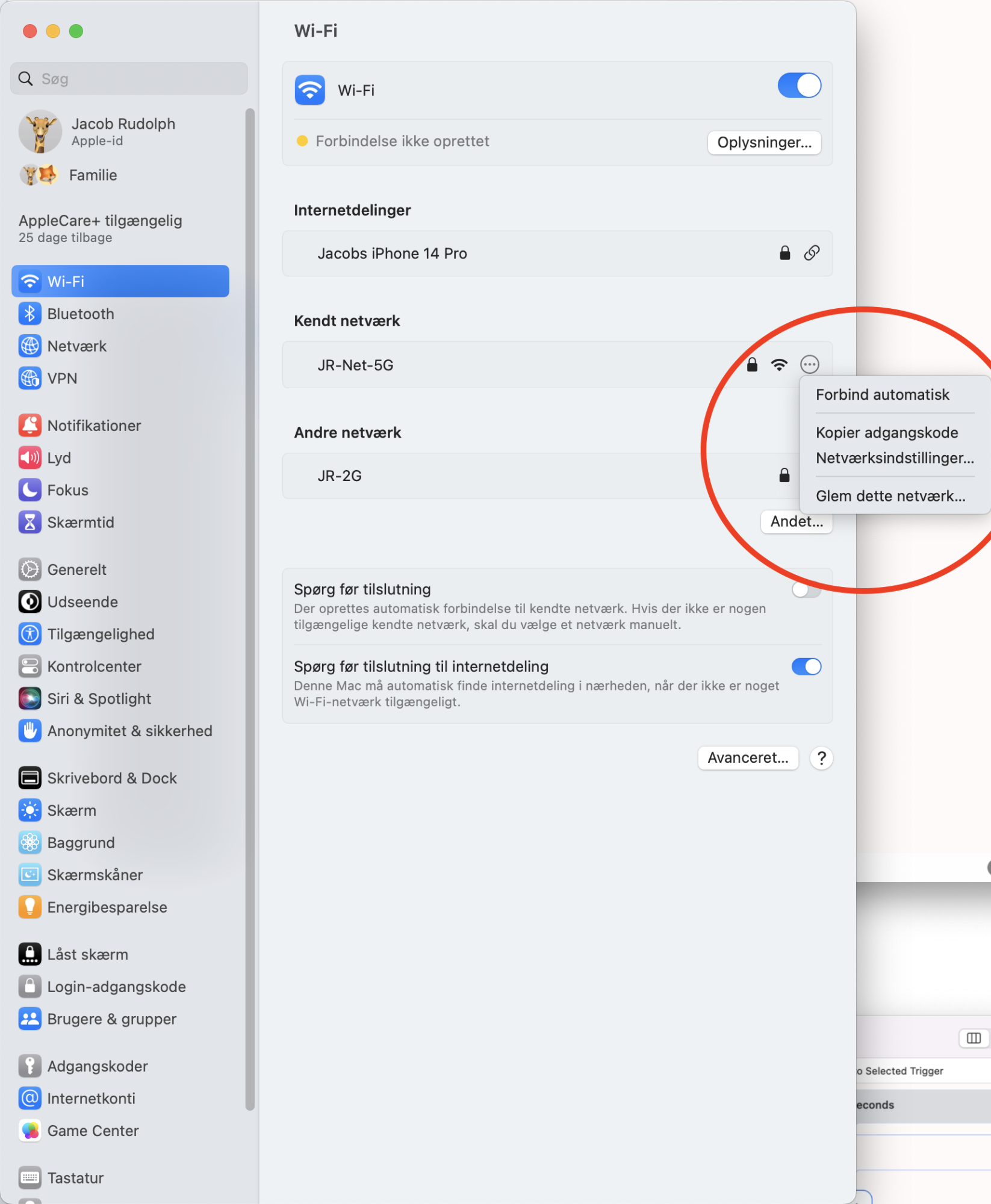

My solution so far:
In settings - Wi-Fi press the 3 dots on the right side and select "Do not connect automatically".
Do this for all your Wi-Fi SSID's, turn off Wi-Fi and turn it back on, the Mac will not connect to Wi-Fi but you can still use Airdrop, unlock with Apple Watch, continuity etc.
