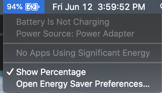

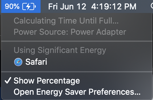

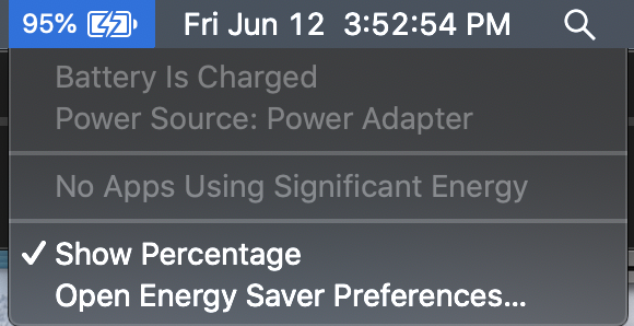

After observing the BHM feature on my 99% plugged into AC 15" 2017 MBP for a month, this is what I can report:
Approximately every three days the built in charge controller stops energy going to the battery. The finder battery menu shows one thing down to about 95% charge, then another as is shown by my attached screenshots. It gets down to about 90% then starts charging right back to 100%. That's it.
Here it is at 95%:
At 94%:
At 90%:

As you can see, the Battery icon is showing fully charged and plugged in even when it is below 100% and even when it says "Battery is Not Charging".
