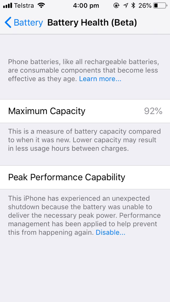

My SE is just over a year old and is reported to have 92% of its maximum capacity. However, it's already got performance management applied because of an unexpected shutdown. I can't remember when this shutdown occurred, but I have noticed more than usual stuttering etc recently.
Do I turn off the throttling (the information page says you can't turn it back on), live with it, or go get a battery replacement? I had noted the date that the discounted battery replacement program finishes with the intention of getting a battery replacement at about 1.5 years into its life.
The other thing holding me back is that there is no Apple store in my state, and the local authorised service centre charges a fee on top of Apple's fees.

Your experience is exactly what prompted the 6S recalls for battery defects, auto-shutdowns and refusing to power back up unless charging.
[doublepost=1529216171][/doublepost]
Makes you realize how Apple became or will become the first trillion dollar company on earth. Lol. They basically blame the battery being at 92% capacity as the reason it is defective. Yes, defective.
In what universe should a phone be auto-powering off (and refusing to power back on) because a battery is at 92% capacity? And Apple users just eat the s*** right up. So much so that they even PAY Apple to replace the battery because of their own manufacturing / design defect. Such crazy times we live in, lol.
You do realize that the capacity is simply one reading related to battery health, right?
