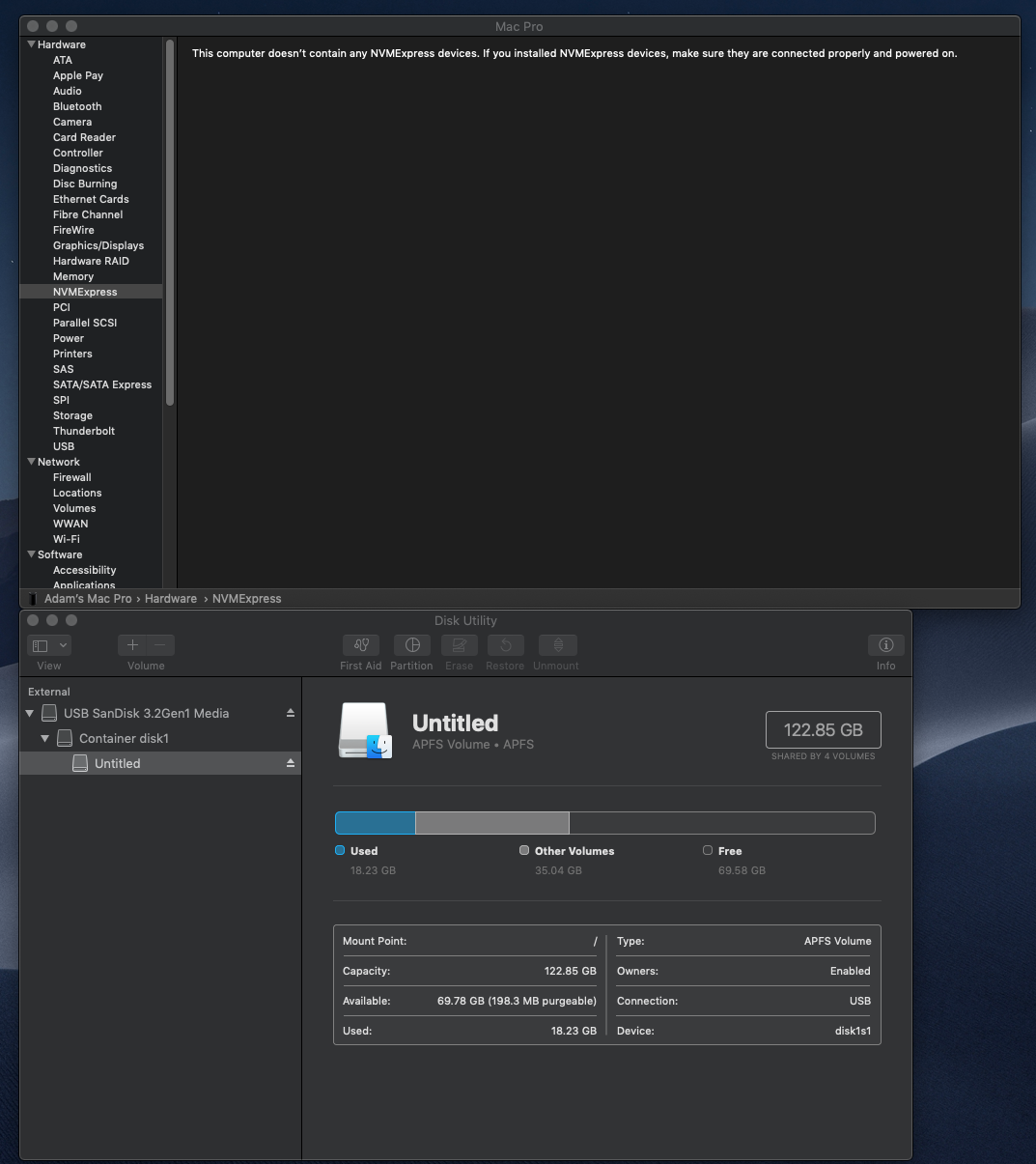

So I went and booted back into Mojave using the USB stick I installed Mojave onto.......and now Disk Utility/everywhere else is suddenly not showing the internal SSD anywhere?? What the heck sense does that make? It's connected in just the same, machine has been untouched since last time I posted.....
To boot I just inserted the USB and pressed start...nothing special. Really don't get this...

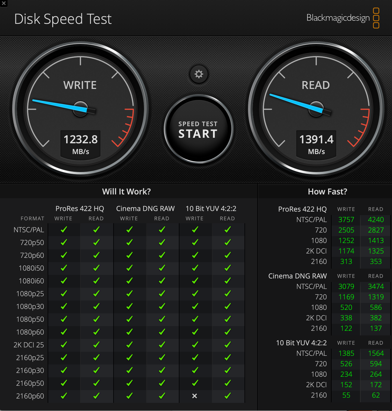

Update 2: Looks like the WD 770 is going back. I'm experiencing several KP on startup and the crash report mentions: "3rd party NVMe controller. Loss of MMIO space"a quick google shownsa number of people having similar issues.
I think I will return it for the WD 750 as I know that works fine in the Laptop.
Update 1: the WD750 2tb with amazon NVME adaptor fitted perfectly into my 15inch 2015 MBP and has been working flawlessly for the last few months.
So I decided to upgrade the SSD in my 6.1 Trashcan.
I bought a WD770 2TB, only because it was on offer at Ebuyer UK and was cheaper than the older 750 2TB SSDs.
I bought the same NVME adaptor from Amazon as I had good results with it in my laptop: NVME adaptor
The SSD and drive fitted perfectly into the Trashcan, nothing like the photos the OP posted.
As Soba mentioned in a post above: Option-Command-R should get you on the latest macOS
Using the above key combination internet recovery started up. The disk utility program recognised the WD 770 drive and allowed me to format it to APFS.
Internet recovery then proceeded to install Monterey 12.4.
Et Voila - 8 years after buying this heap of crap computer I finally have a decent sized SSD inside of it.
This Trashcan has only been used for light browsing for several years because it suffered from the dreaded 'GPU restart freeze' and also the 'crash on wake from sleep', however since a recent Monterey firmware update it has been very stable and I'm actually editing a wedding video on it!!!!!
After regretting buying this computer for the best part of a decade, I have come to the conclusion that its design was far ahead of its time. If Apple were to release an Apple Silicon version of this with upgradeable RAM and SSDs then I would happily buy one again, but I digress and my opinions are for another thread....
Speed test below - Read/Write 5gb file
