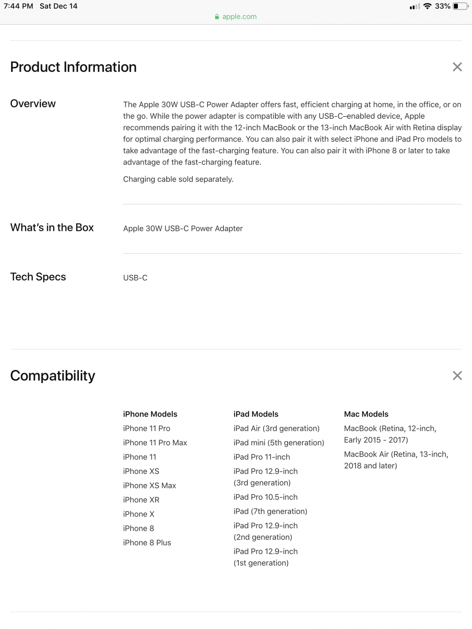

To all those older posts which doubted that it does support fast charging
it does... all here
under compatibility it mentions the iPad 7 and others which take advantage of it
Hmm, this kinda suggests iPad 7th gen should support fast charging though. The iPad Pro 9.7 is notably missing (which we know doesn't support fast charging) but the iPad 7th gen is listed.
https://www.apple.com/shop/product/MR2A2LL/A/30w-usb-c-power-adapter
I've already made note of that in an earlier post. Actual testing shows the iPad 7 only pulls 15W from 30W USB-PD charger.
