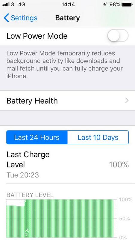

LOL, not going to happen, with any phone, sans putting it in airplane mode.
You sound very sure of yourself.
Tuesday 8pm until Wednesday 2pm

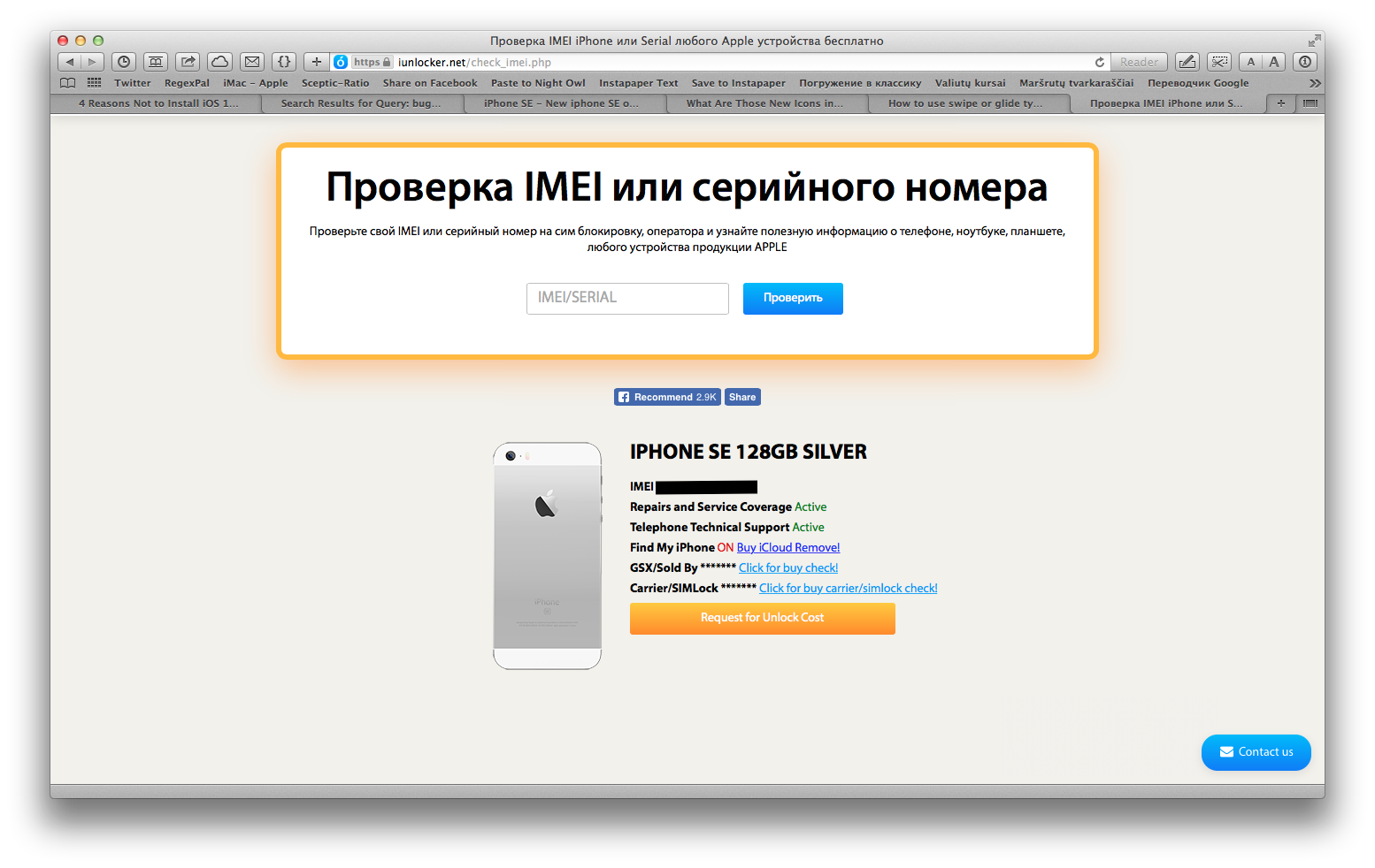

After reading this thread I'm scared AF because I ordered mine on eBay as "brand-new" in the original box and with all accompanying stuff and waiting for it to arrive. Damn! What if those 400 euros been flushed down the toilet? Begs question why it had being sold. What if it's defective? Per description comes with Apple warranty but who knows. Disheartening.
Have they given you a new iPhone SE or a different model? --OK, upon reviewing the whole thread this is an irrelevant question.
Don't panic too soon. Probably everything is going to be ok. And if the warranty is valid, then you will have the peace of mind that Apple is going to take care of your device if something doesn't work as it should.
Reactions: maverick28

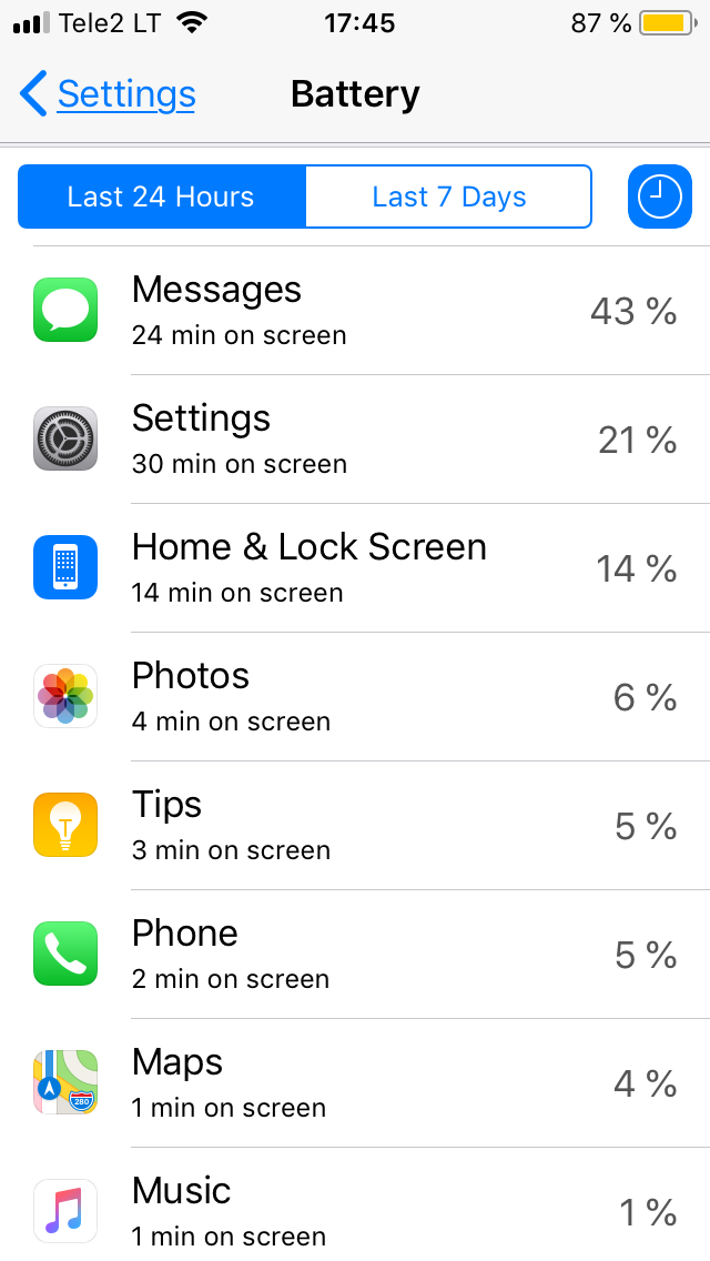

OK, I'm returning with some observations of mine after not a single full day of using iPhone SE 128 GB. Applying a screenshot (the second one) of the batter preferences with, presumably, "detailed" breakdown of power consumption. For starters, the phone IMEI checked on https://iunlocker.net. I'm not sure about the legitimacy of the site but it returned the following data:
This appears to be OK and matches the model and the support status I've been informed of by the seller. I think the phone was in a very light use because the box was unsealed and it has iLife/iWork apps installed. Not sure how bad is that and what to think. Other than that - perfect condition.
Now on to the main topic. Here's the screenshot of the power consumption statistics after 1 h 10 min of the reported active usage:
I enabled location services,iCloud, kept iCloud Drive, Siri disabled. I refrained from updating it to 12.1.4. I also turned on Power Saving. I set the brightness to 40-50% as well as Night Mode and Do Not Disturb. I charged it to the hilt, used a bit (opened apps, tested the behavior), let it slip to 99% before I went to bed.
Awoke after 6 h to discover the charge at 91% (or 94% - can't remember but my heart speaks in favor of the former number). As I resumed playing with settings and apps, messaging my contacts, I noticed I had left plenty of apps open because the way multitasking works is not pretty obvious in iOS so I had to waste my time finding out how to use it. I also noted the staggering 1% loss per half an hour of usage. I then quitted these apps except of Messages. The percentage on the screenshot is by the time I closed other apps and also disabled Location Tracking while using the phone. What is striking about these statistics is that Messages contributes most to the draining. I feel unrest. How do you do without the most actively used app? That's insane.
Awoke after 6 h to discover the charge at 91% (or 94% - can't remember but my heart speaks in favor of the former number). As I resumed playing with settings and apps, messaging my contacts, I noticed I had left plenty apps open because the way multitasking works is not pretty obvious in iOS so I had to waste my time finding out how to use it. I also noted the staggering 1% loss per half an hour of usage. I then quitted these apps except of Messages. The percentage on the screenshot is by the time I closed other apps and also disabled Location Tracking while using the phone. What is striking about these statistics is that Messages contributes most to the draining. I feel unrest. How do you do without the most actively used app? That's insane.
[doublepost=1550770432][/doublepost]To add, I had an Android old Xperia V and can state with certainty that the battery drain occurred at slower pace when brand new.
As of now which is 1 of my original post the battery is at 84%
The best way to check that everything is ok regarding the coverage of the iphone, date of purchase, etc., is visiting https://mysupport.apple.com/.
As I have been able to verify, iLife&iWork apps come pre-installed on iphones and other ios devices.
Regarding the performance of your iphone (battery consumption), it's pretty difficult to say something as of now because:
- you are on your first day of usage
- not even a full battery cycle has been completed (the battery needs to settle down)
- you have used your phone with Low Power Mode activated
- you have not used auto brightness, which is more battery friendly
Keeping all of this in mind, I would say that everything seems normal to me, except the 1% loss per half an hour of use. That is amazing! (except if it's the draining from 100% to 99%. Then it would be normal).
Here's latest results: 2nd charging cycle. 1st one was discharged completely (intentional decision). This time charged to the maximum, left in a sleep mode. Activated after 5 h to 97%. As I started using it (Messages, apps such as Twitterrific, Tweetlogix, System Preferences, Mail, no internet browsing whatsoever) it began dropping the charge at 1% per several minutes and fell down to 84% before putting it to sleep after 1 hour of usage. I woke it up after some time, the % still where I left it but nevertheless it's supposed to withstand more intensive load - I'm not streaming games, TV shows or using it on heavy YT HD 4K videos! Heading to the nearest AARS.
