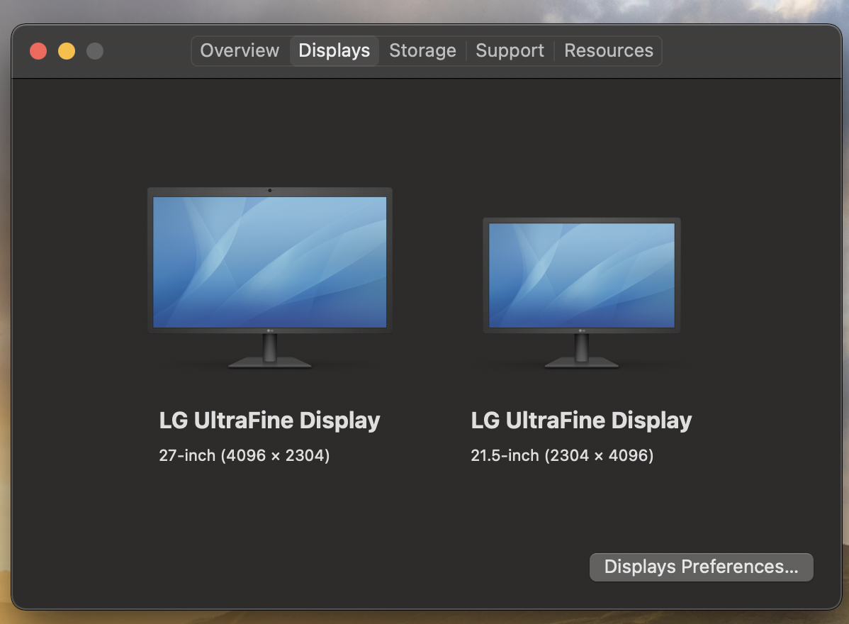

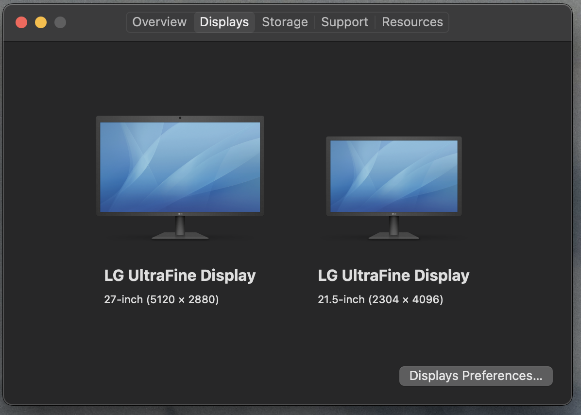

I just received the Sonnettech Echo 5 thunderbolt hub which claims to support dual Pro Display HDR's and various combinations of 6k/5k/4k monitors. I have both 5k and 4k LG Ultrafine monitors, but the dock seems to not recognize the 5k properly when both are plugged in to the thunderbolt hub. It thinks it's a 4k - I'm hoping it's just a Monterey issue...
First pic is with both plugged into the hub, second is with one plugged into the laptop.
