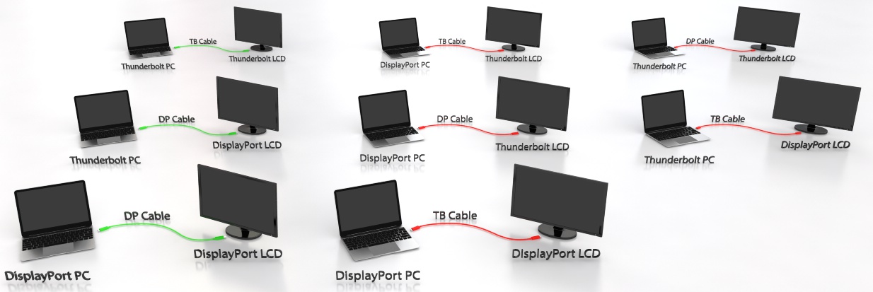

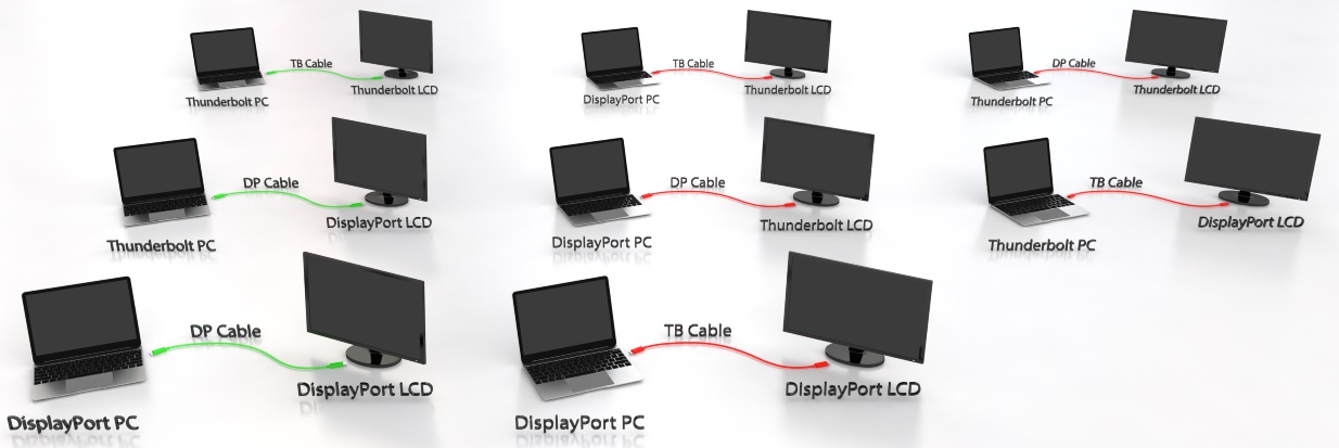

Your DELL U2715H has DisplayPort Out, why not daisy chain both externals and save your thunderbolt 3 ports for other accessories?
