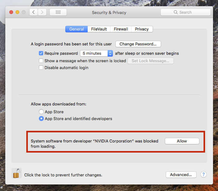

I did some Googling and found the answer to my problems.... I had SIP disabled. I never thought this would be a problem but it was, at lease with High Sierra. Both the web driver and the CUDA driver will not install properly with SIP Disabled. Two Gatekeeper exceptions need to be added (Security & Privacy - Yes Allow) then both drivers install perfectly, without the errors.

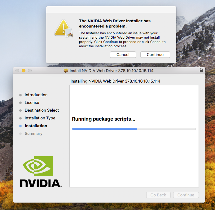

This was the error I was getting half way through the install. If you continue the install looks like it finishes but Gatekeeper has blocked needed extensions.

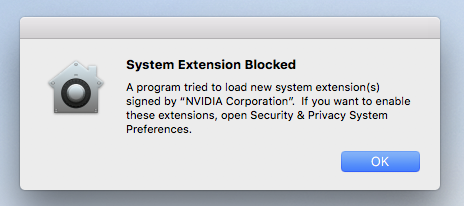

If you enable SIP and run the installer again you will get this....
Then you just go to (Security & Privacy - Yes Allow) and everything works fine !

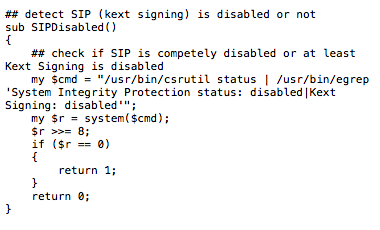

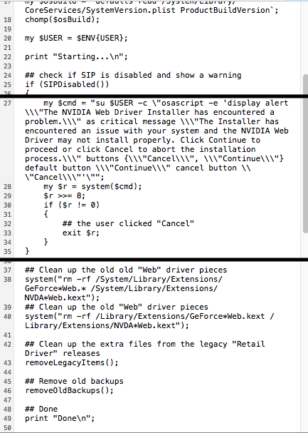

The real thing is the Package NVIDIA 10.13 HS haves a flag for the SIP in the preinstall script
see this is the same message in the Popup
End of script
Reactions: splifingate
Right, it very clearly looks like the installer needs SIP enabled for it to work correctly. Gatekeeper appears to do something to the binaries to make them allowed to be loaded when you hit "Allow" in the Security preferences. If SIP is disabled, that step is done done by the OS, and thus the driver might not load properly.

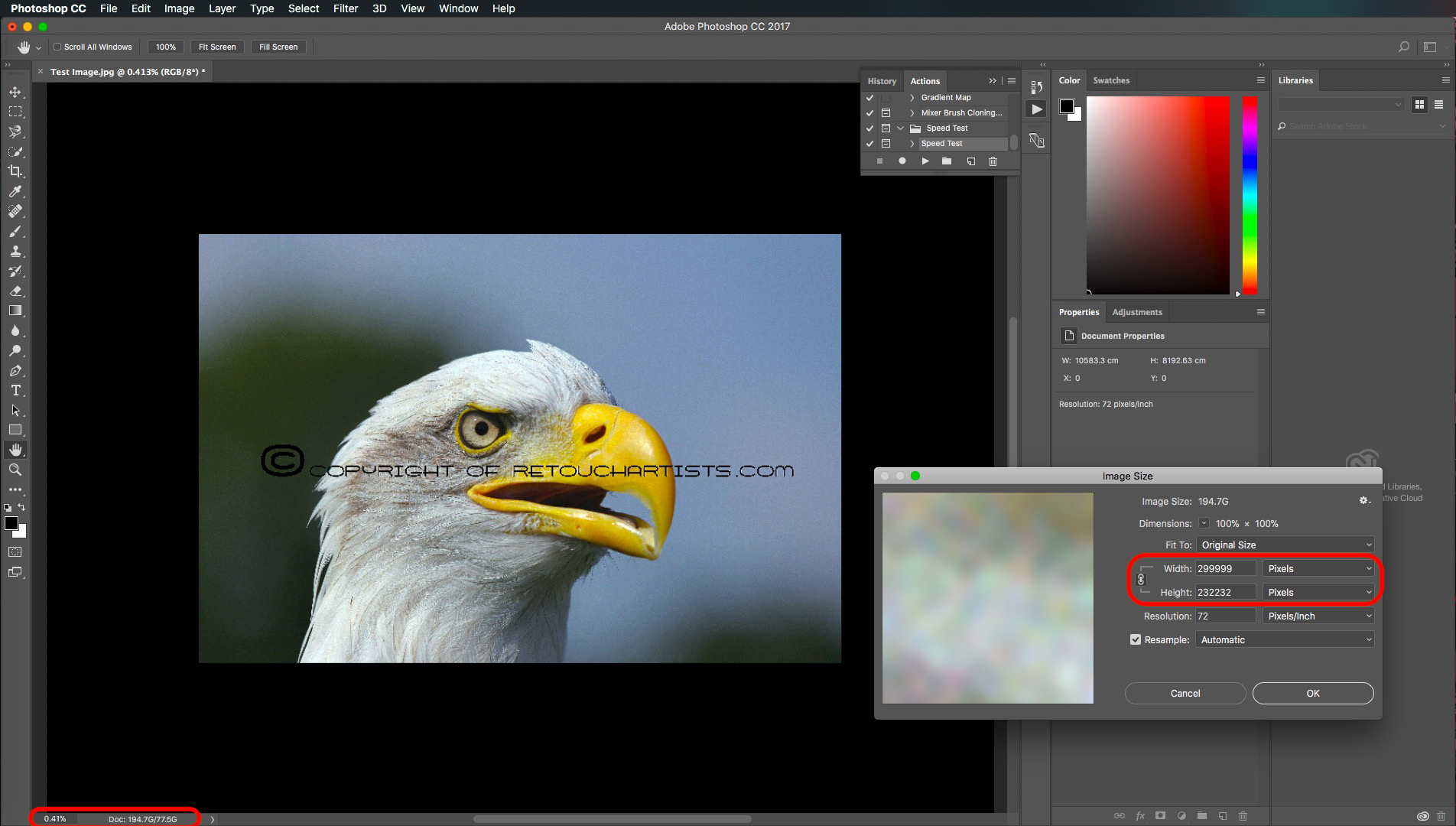

Run a large resize image action in Photoshop with OpenCL turned on. Does it crash or result in some errata?
May I know the details on how to reproduce any bug? The iBook one seems fixed just before I buy my 1080Ti. And I tried to resize an image in Photoshop to a ridiculous size with OpenCL on (see attachment), but still no error / crash / bug.
