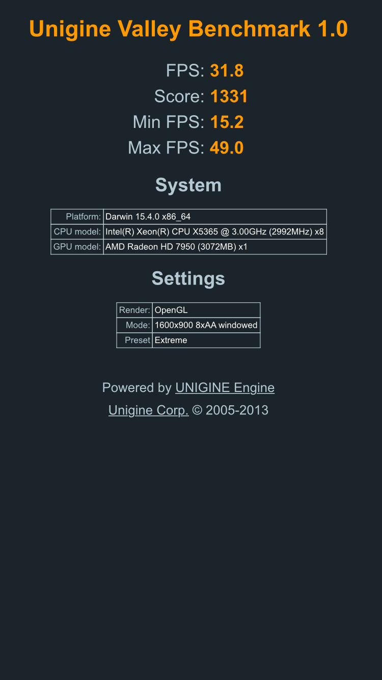

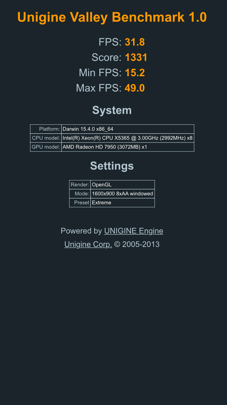

Just for you, I thought I'd have a look. See the attachment.
The answer to your question, for this specific benchmark that pushes cpu and gpu, is... Quite well actually. 1.3 fps difference to a 2010 Pro. I'll take that.
To preempt your next arguments, no I won't test a GTX680 even though I do have one and no I won't test any other benchmarks. It's pointless.
Do newer Mac Pro models outperform a 2006? Of course, in every case. Is it by a massive margin? Not always.

Btw, didn't you say your card is heavily overclocked? So you need a heavy overclock to perform 1.3fps worse...

And yes, it's overclocked. Your point is? I could run the test again and come out 1.3fps higher. Do you understand what "margin of error" means?
Fact is, my FREE 2006 Mac Pro that I've put no more than £150 into performs as well as a 2010 Mac Pro for my needs.

Of all the tests they did, you conveniently chose the one where there was little to no differentiation between any of the machines. Then, you did so with a heavily overclocked card. Convenient.
Right... Like I'm going to waste time (and money, in some cases) to keep proving you wrong.
The only thing those benchmarks show are that a 5,1>4,1>3,1 in every case. So yes, you can expect a 2,1 to underperform. Figuring that out is hardly rocket science (or, is it?).
Show me Valley benchmarks, Extreme preset, for non-Pro machines.... you know, like the iMacs you were talking about. Better yet, show me the solid 60fps, High settings Fallout 4 on a non-Pro.

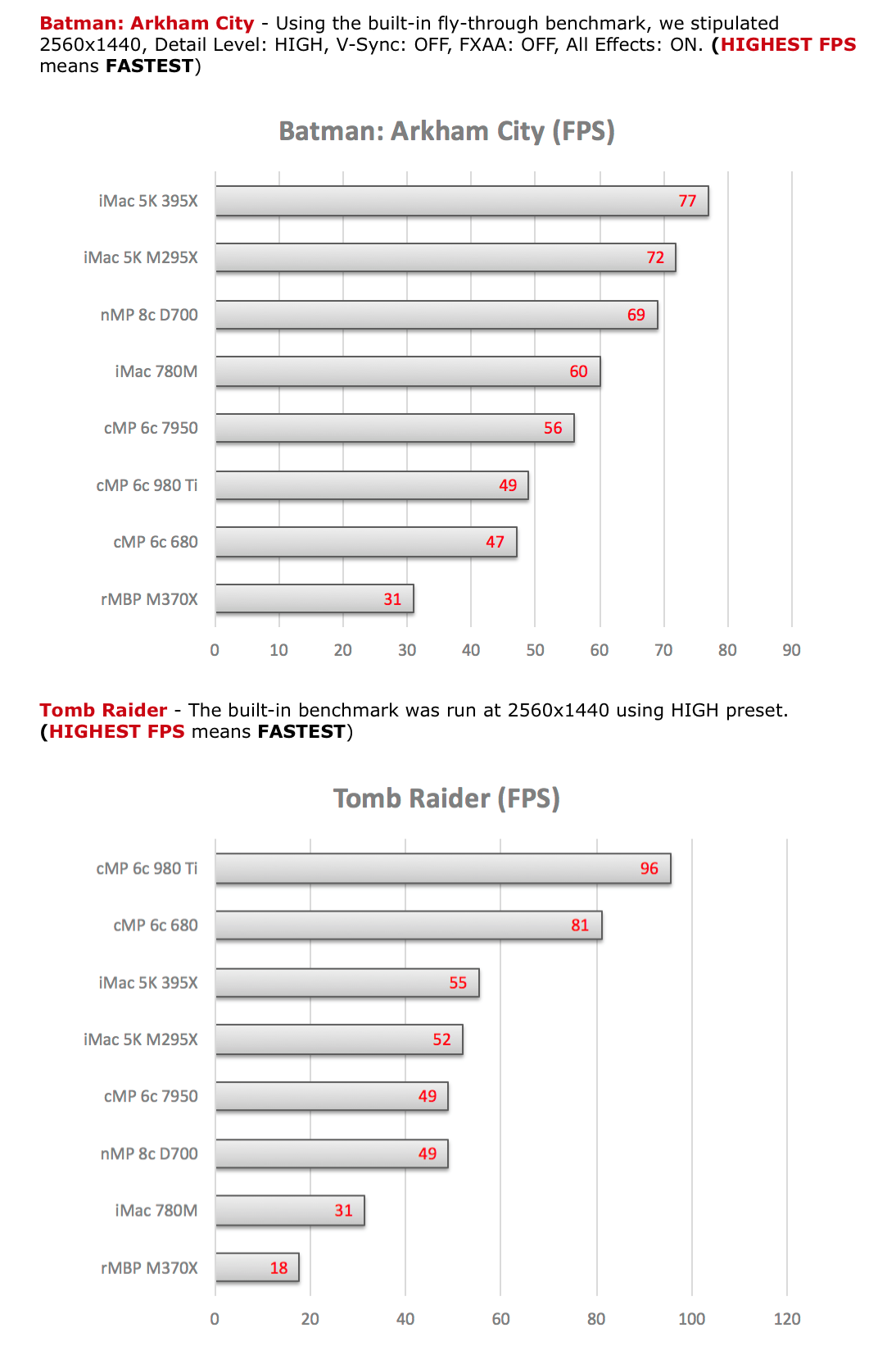

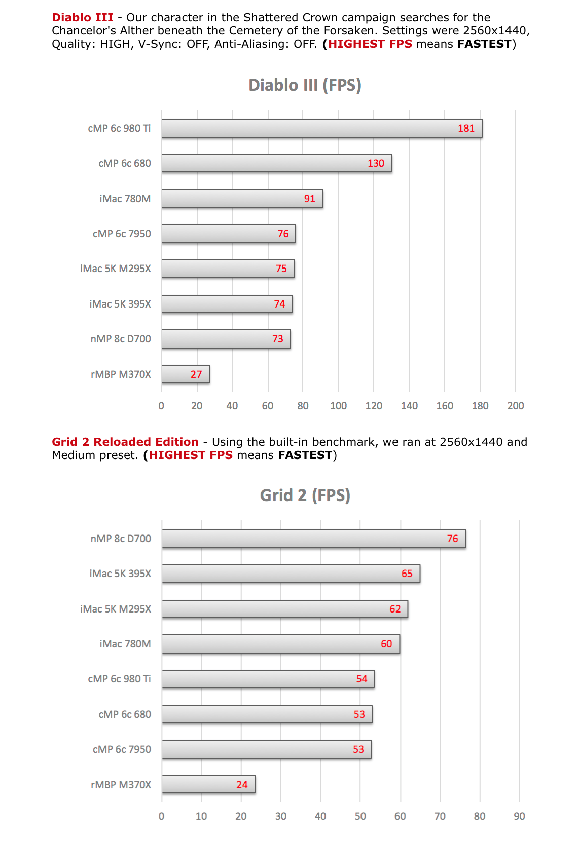

Unfortunately, most of the benchmarks for the current iMac were done in 5K. However, here are a few that compare it to a Radeon HD 7950 in a 5,1:
Source: http://barefeats.com/imac5k20.html

In that thread, all unigine tests were done in medium preset. The barefeats.com tests were done in extreme preset making for an impossible comparison.
