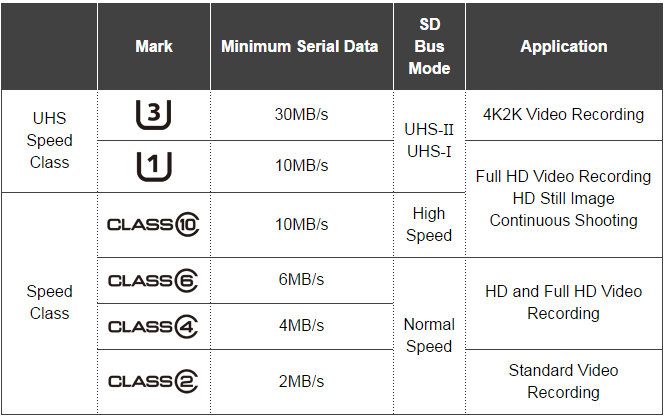

Yeah, SD cards are bitterly slow. Which Sandisk one did you get? The standard ones transfer about 2MB/s to 4MB/s. Even the 'Ultra Line' start at 10MB/s and can be up to 80MB/s, though you'll rarely be getting those sorts of speeds, especially consistently. The 'Extreme Pro' line can say up to 90MB/s, but take that with a pinch of salt too.
You'd be much, much better off with a SanDisk Extreme USB drive. They're around the same price as the SD cards and they do transfer very quickly. We actually use one at work as an OS X boot/diagnostics drive, and it's practically as fast as an SSD when running over a USB 3 Mac (2012 models or later).
Here's nice little chart the details how fast (or slow) a given SD card will be
