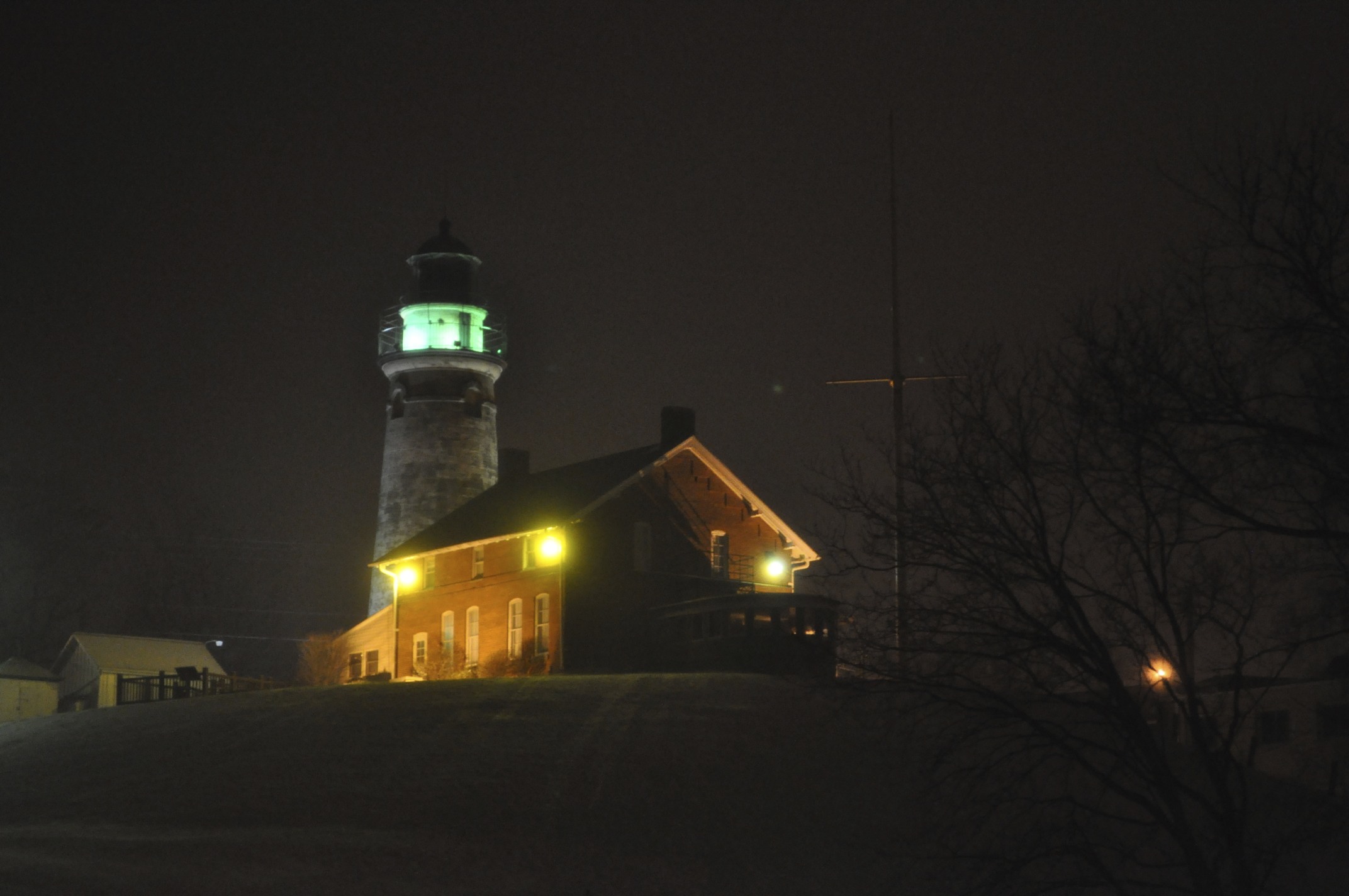

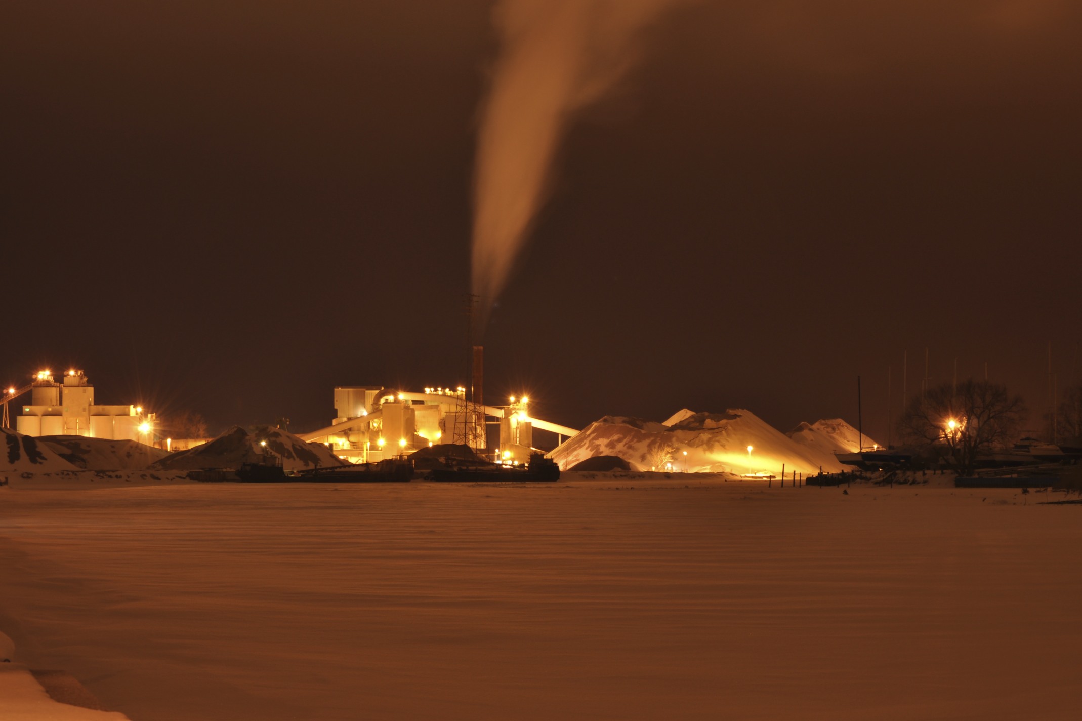

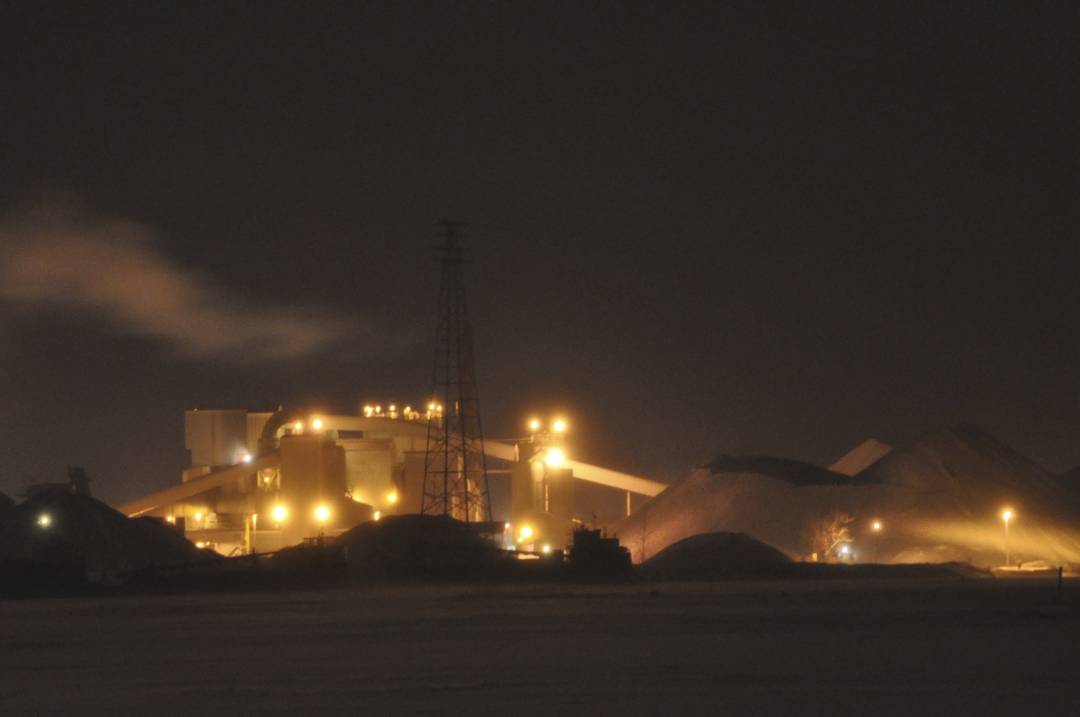

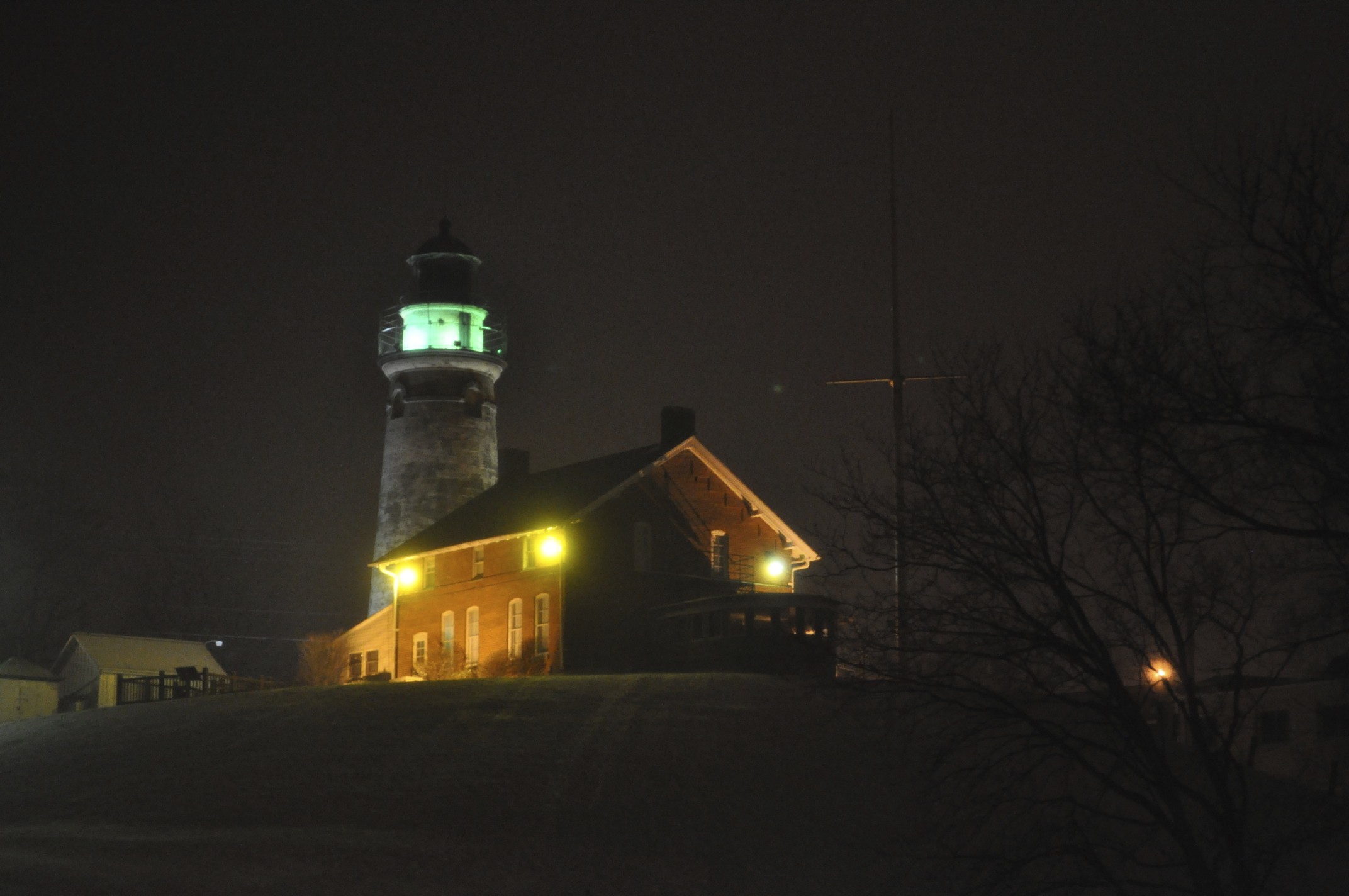

1st Night Shots
1st night shots able to take, good tips on here, still need to work on decreasing the noise.
These are direct from the camera, no photoshop.
Top picture: Morton Salt mine.
Bottom picture: Fairport Harbor Ohio Lighthouse and Museum.

reduk300:
excellent subjects to shoot lowlight..
now, tripod and F11 or so, ISO to the lowest you have and in Aperture Priority shoot. Should be several seconds (best guess about 15? :))
You will get amazingly clean images of both subjects with no noise (if you shoot ISO 100 or even lower??).
But a tripod is essential here... Also try delayed exposure. so you push the shutter and it fires a second later to avoid camera shake.
Very good subjects both though...
to FlosseR
Thanks for the input. I was driving home the other night from bowling and I passed both these places and figured these would be great shots to try for my first night shots. Especially since they are only 10-15 minutes away and I can shoot, see what I don't like and then go back and try different settings and see the difference.
I did use a tripod, but we also had 15-20mph wind gusts last night, so I tried to use a high ISO, for quicker exposure, F11,and used my delay button of 10 secs. I knew I would get some noise, but not that much.
I was worried about a long exposure with too much camera shake due to the wind. I am going to back in the next few nights as the wind is supposed to be less of an issue and hopefully be able to go to the lowest ISO with longer Exposure.
Was this a compact camera or a dSLR? I like the shots in terms of composition (especially the second one), but I was a bit surprised when you said you used a tripod given the relative lack of sharpness - even accounting for the wind.
As an alternative to using high iso - and since you're going to go back and experiment anyway - try dropping the aperture down a stop or two and focusing hyperfocally (assuming the distances work). Every full stop doubles the amount of light you're collecting. So if, for example, you shot at f/8 you could cut the ISO in half (or cut the exposure time in half).
You could also try weighting your tripod somewhat.

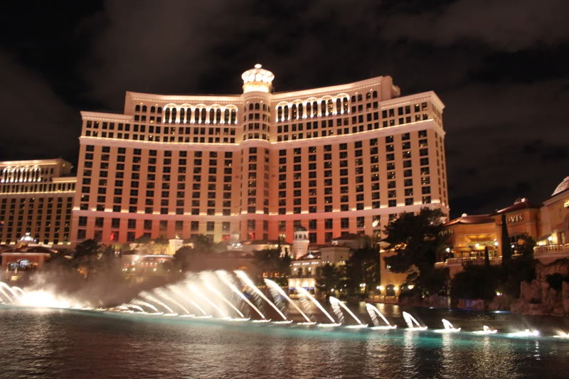

i was out shooting some night shots last night, it was my first time shooting out at night in city streets. i don't know if i should put the F/3.5 or sometimes at F/11...i want everything in the picture to be sharp, but just cause its in F/3.5, that doesn't mean things won't be as a sharp will it?
i was in manual mode all night, didn't have a tripod though, sooo i couldn't make the shutter speed as long as i'd have too, but actually there seemed to be soo much light around me that everything was almost overexposed anything over 3 seconds..soo any tips comments on these pictures here please!!!!!
and do to do the trailing lights effect, especially in the this bright city, i'd have to turn the aperture really high, and that's how i'm going to be able to make the shutter speed longer correct?
would it be best if i left my camera in AV mode? so i can just change my aperture myself and trusting the camera would make good judgement for the shutter speed? thanks!!! :confused::confused::D:D
Wow.. those shots have excellent potential.
tip (purely to try if you want to),
dial the aperture to f11 and ISO to the lowest you can do and leave in AV mode.
Then find a stone pilar or a pole to lean and steady the cam against. I use trashcans as well and push the cam down to hold it firmly in place. then release the shutter and hold it absolutely still until it clicks :D
then watch your results...
Oh and if you can, focus manually first (hyperfocal if possible but I think Infinity would be a good start. Those belaccio pics with he water fountains open for 15 secs should make amazing pictures.
Enjoy

haha, thanks. i usually leave the iso on AUTO, but i'll start trying to put it at 100.
now i'm curious to try the 15sec shutter speed at bellagio, cause the water dances, and moves all over the place...soo i'm wondering how that's going to look..hahaa.

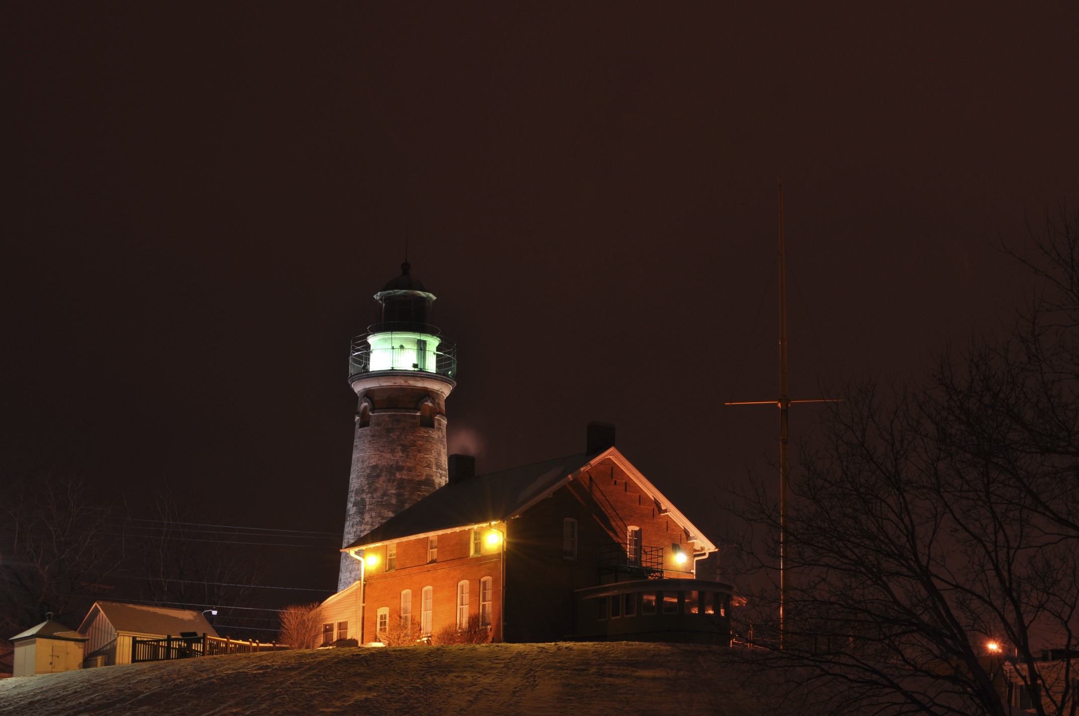

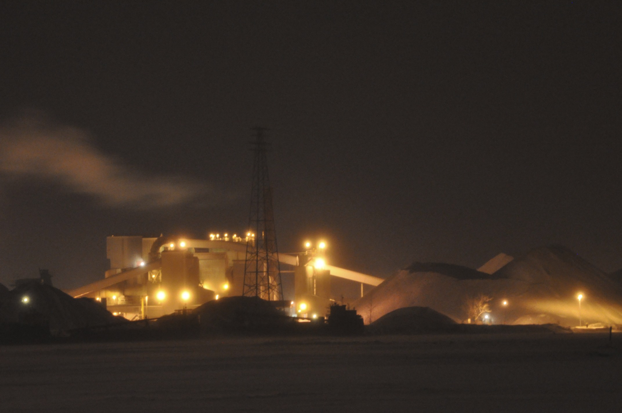

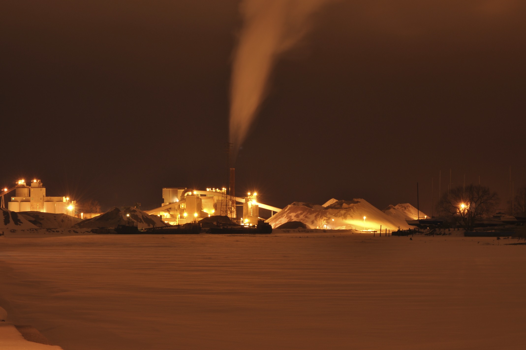

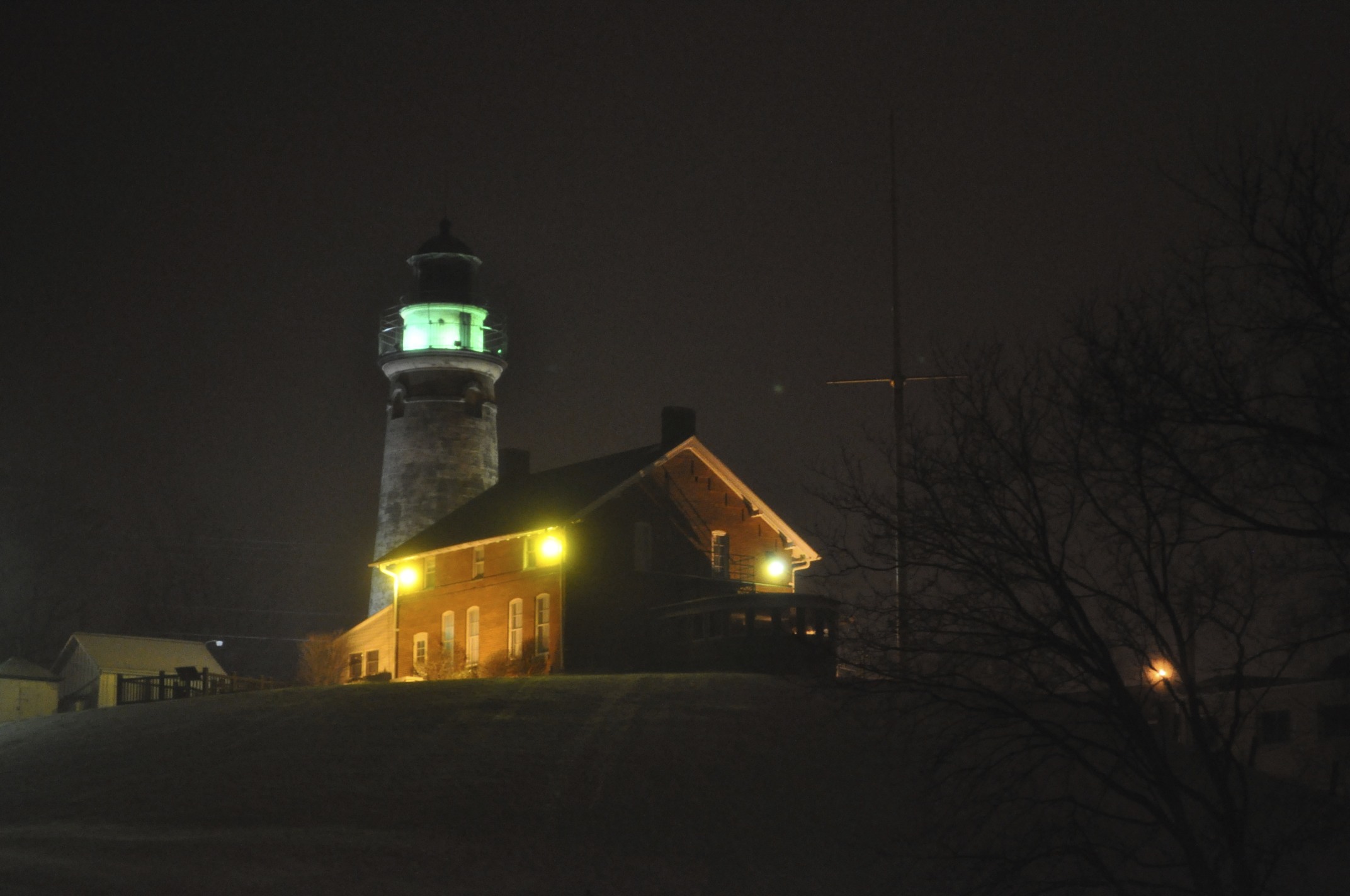

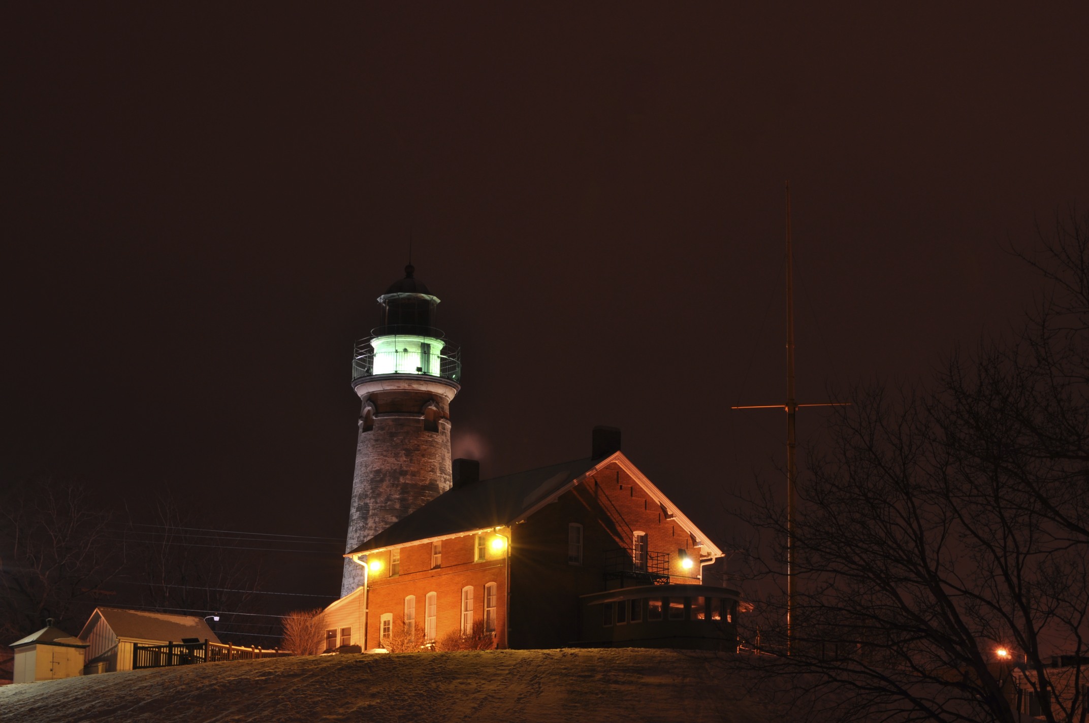

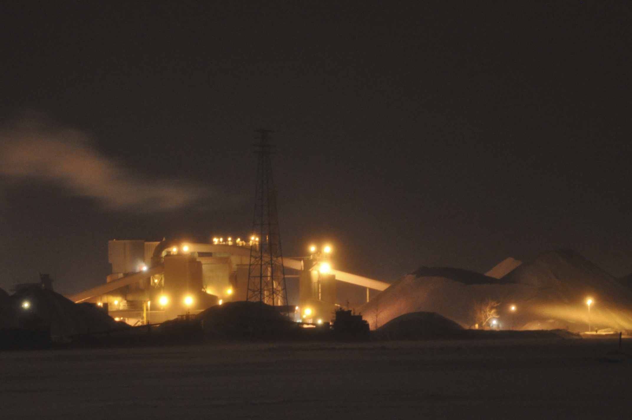

Much Improved
Finally able to get back to the night shots I wanted to retake. With some good criticism, I think these improved very much.

Oh yes, very much :D Much nicer.
Now adjust the photo to make the sky dark or shoot in pitch black night and you have a winner :D
Well done.
