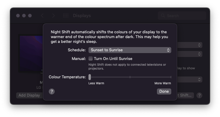

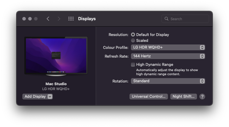

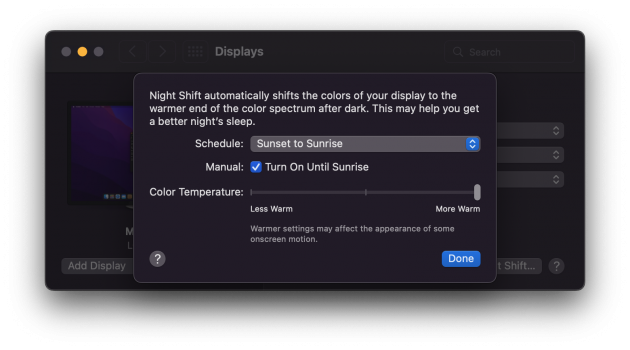

Hey everyone, I'm using an LG 38WN95C-W with my Mac Studio via Thunderbolt and I can see the Night Shift settings, but enabling them doesn't take effect and the colours don't change. After configuring it and going back, I can see that the temperature automatically goes back to the far-left on "Less Warm". I've tried disabling and re-enabling it. I've seen other people having issues, but those were mostly cases where the option wasn't available at all. Is there anything I can do before resorting to f.lux? Using different picture modes in the monitor didn't make a difference. Thanks in advance.

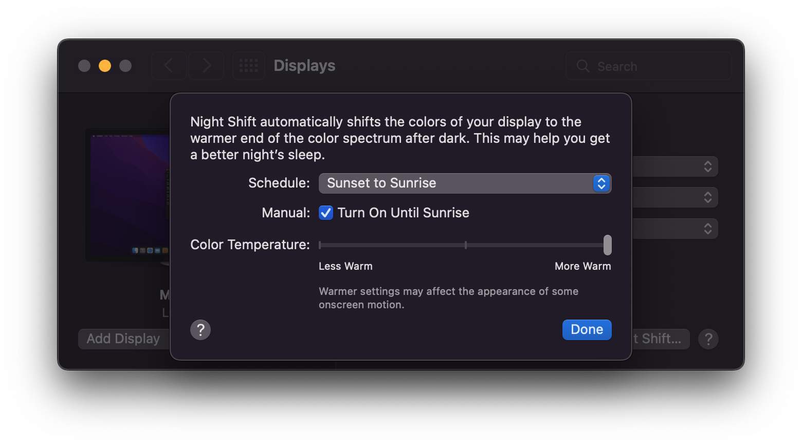

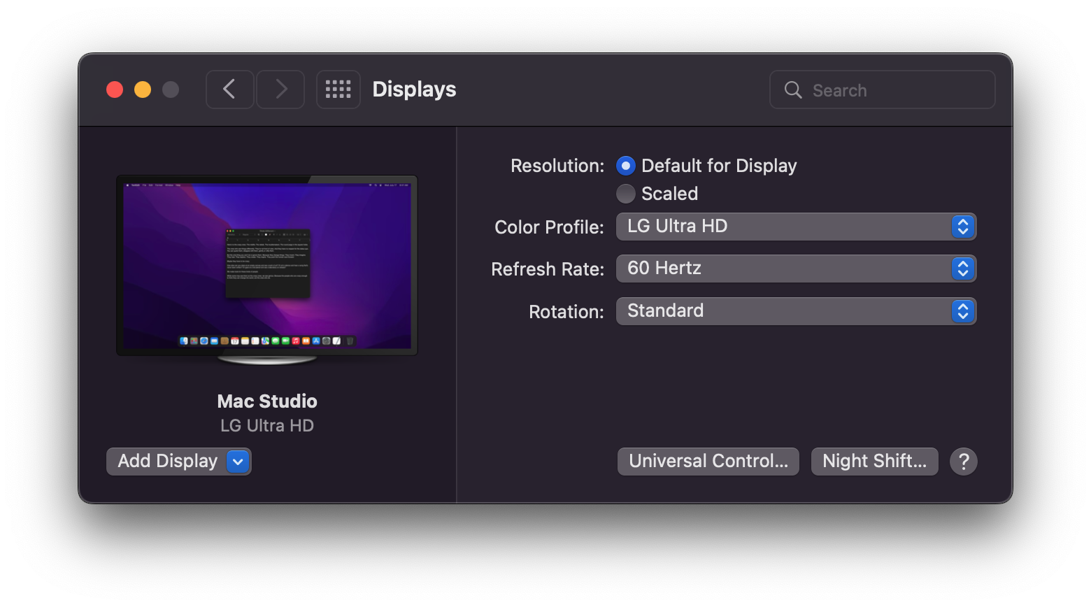

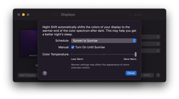

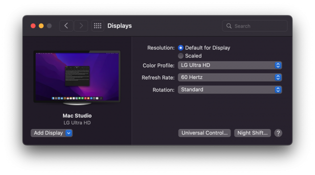

that's weird. I have a basic 32" 4K LG monitor that I connected to my new Mac Studio last night via HDMI, it Night Shifted no problem. just did it again to confirm.
Model # 32UK50T-W

Yep, that's what I've been using, it's just frustrating that I can enable Night Shift in PBP mode, but when I switch back, the slider is all the way down and moving it up doesn't have any effect like it does in PBP

Don't see a solution posted for this so thought I'd share mine with a LG 38.
MacOS sees some monitors as a TV. I found the easiest fix is to use BetterDisplay to change the monitor identification to a Computer Monitor. You can change the setting in trial mode and it sticks even if BetterDisplay is not running.
Thanks so much for this valuable tip!
