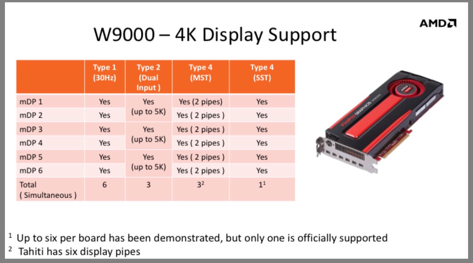

The number of 5K monitors on the nMP with a D700 should be theoretically similar to this chart (which is outdated since we know the nMP does support more than 1 SST 60Hz 4k monitor):

That's all we've got. Source unknown. System Info will also tell you which GPU your displays are connected to. And it's consistent. There's no reason to believe this is not official or at least accurate.
