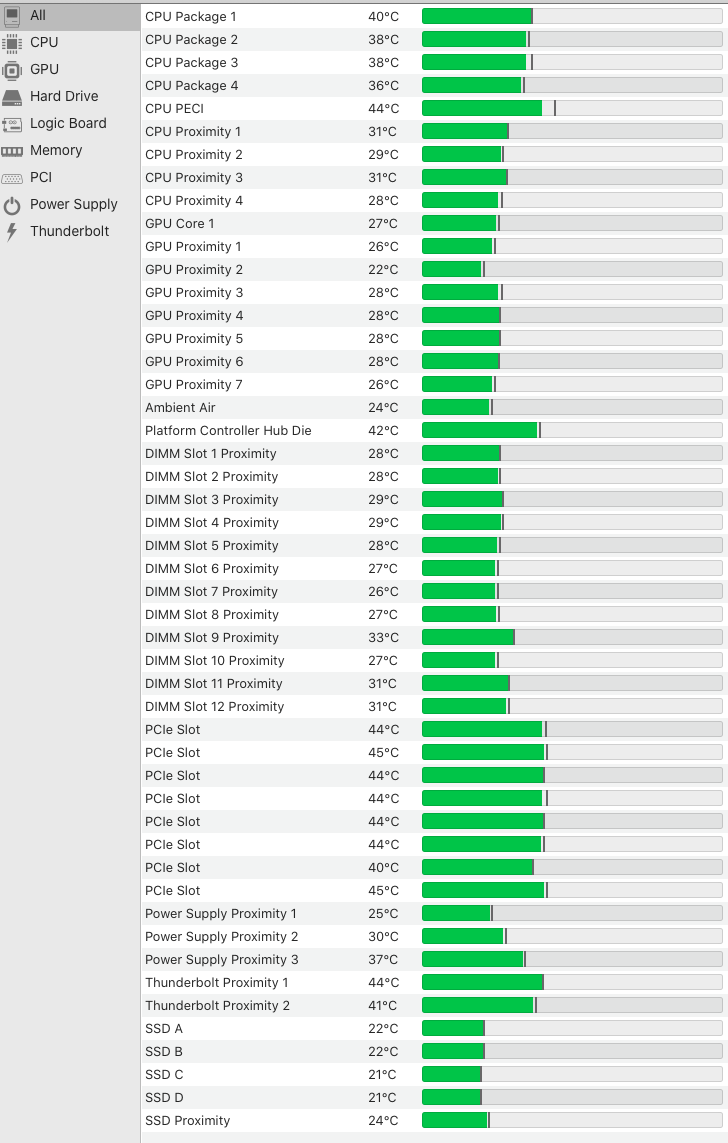

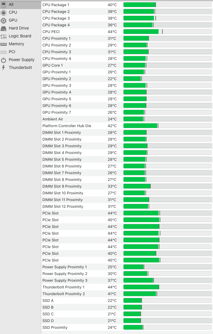

How did you manage to see all that sensor data in iStat? On my 2019 MP I only see a couple of sensor readings
Sorry, I meant OP's list of temperatures, it is nowhere to be found in my copy of iStat.

Thanks. Its strange but I still can't see it, this is what is being displayed:
Might be that the new 2019 MP does not have a PCIe switch diode as an available sensor.
(not missing, just not a part of the new hardware!)
And, none of your posted temps are particularly high.
Anything that you might be concerned about?
I see, thanks. No, I think its all looking good, but was just wondering where my PCIe switch diode temp could be found :)
But it is indeed probably not a part of the new hardware
