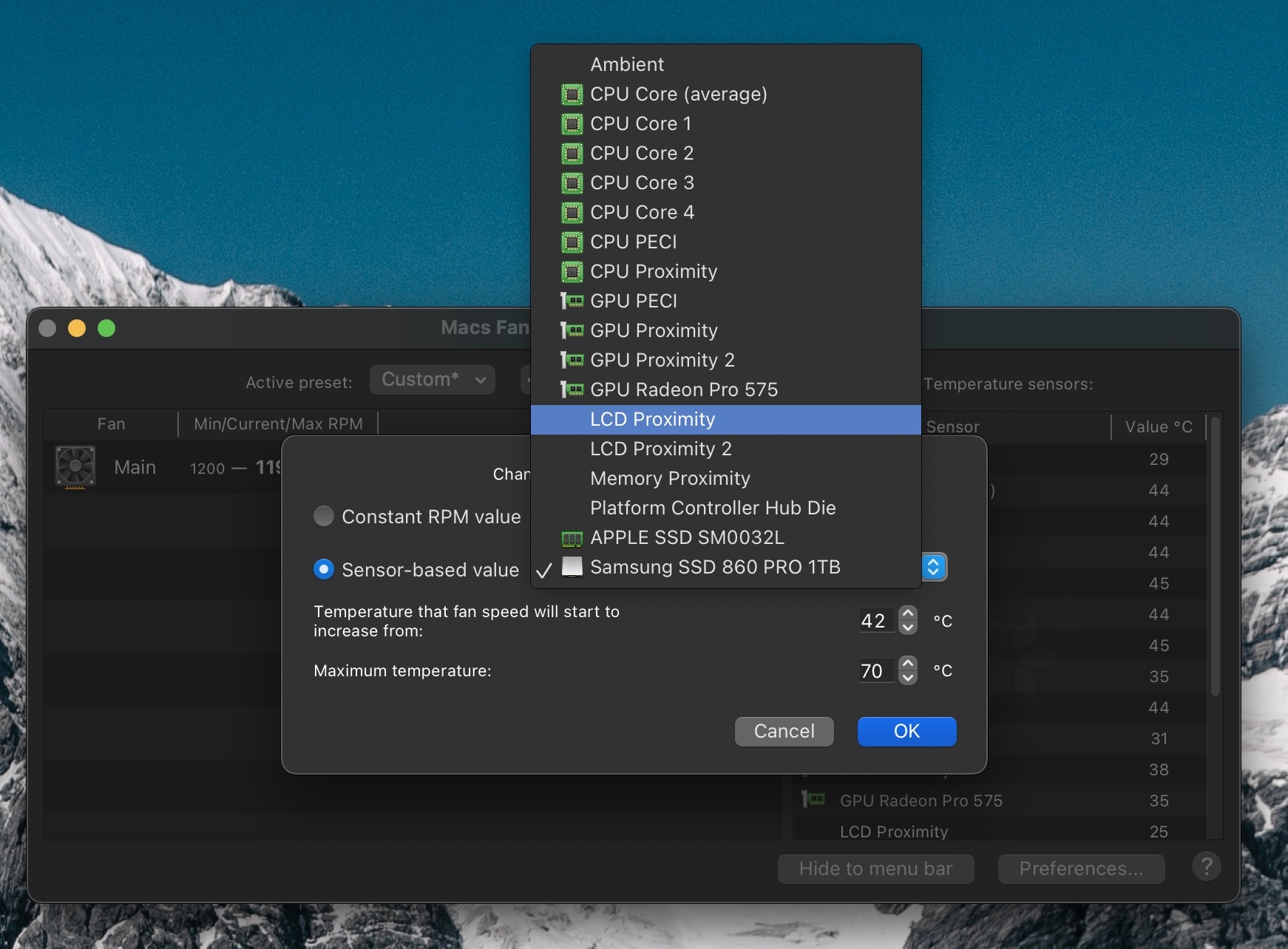

I am not sure if its the OWC in-Line Digital Thermal Sensor because I had the Samsung EVO SSD prior to installing the PRO version and on that one, I didn't have the OWC sensor installed. It didn't make any of these noises but when I installed the sensor along with the new SSD it makes these noises look like as @komatsu mentioned its coming from the fan

First, I would remove the OWC Temp Sensor as it's not needed, and then use the Fan Control app to keep the fan at system set value.
If it appears things are getting too hot, (they shouldn't) you can always set the fan to follow the sensor reading.

I use Macs Fan Control on my iMac (same as yours) but my machine came with an Apple 512GB SSD, no Fusion drive. I keep the fan at system set. (normally around 1200 RPM)
Reactions: Medic28
MacsFanControl lets you increase the speed manually.
Try that, and you may find out the fan is your issue. The sound should change with the fan speed.
I also wonder if something is caught in the fan blades, maybe even a wire just barely touching the moving fan, and making that noise. Again, changing the speed of the fan manually should make sure that the sound is actually coming from the fan. (I don't see any other possibility, but, it's good to pin down the source of a mechanical noise!)

Yes, you're right because when I increase the fan speed, the noise merges with the other fan. But as soon as it comes back to 1200 rpm, it makes that noise again. Not sure if there is anything stuck or hitting the fan because I checked everything before closing it.
