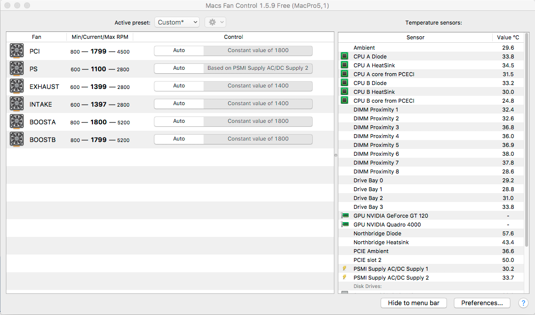

How long has your computer been on in that picture? Assuming the room you're working in is somewhere around 20-25c, how are all your components around those temps too?
Running idle for about half hour. But i should mention it is about 2 feet from AC unit. My other PC's in room are usually about 34 celcious in summer time.
Use Noctua NT-H2 on both CPU's and Northbridge, and use this setting on Mac fan control:

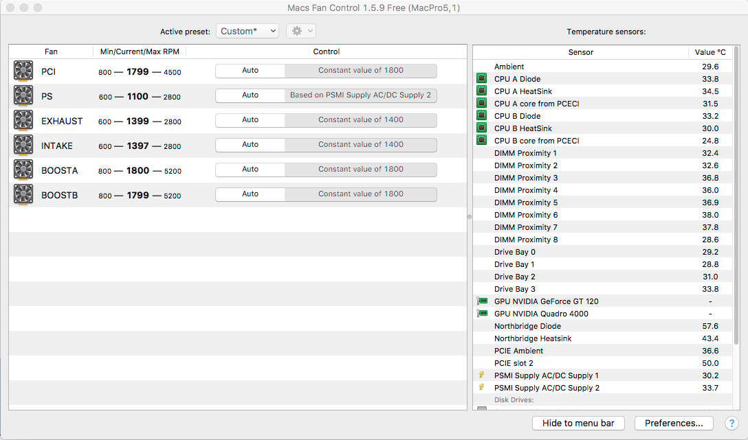

Macs_Fan_Control_1_5_9_Free__MacPro5_1__and_Northbridge_Temp___Page_2___MacRumors_Forums.png
1590667469936-png.919371
I think you can expect to get your delta lower on your Northbridge Diode / NB heat sink.
I did a little mod with my 2 x 3.46 Mhz 6 Core and a Full PCI Bus.
Ended up tuning the Mac Fans like this
And added an AIR Shroud for the NB Heatsink

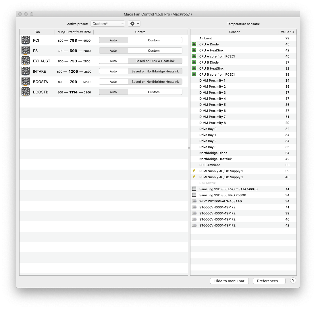

Then you never used all cores for calulating for a longer time. I had a setup like you for around three months.
The problem: When all cores are working, CPU-Pack-A is getting hotter, but not the Northbridge. The fans does not react to this situation, the CPU-Pack-A goes up to over 90°C and start with throttling.
Meanwhile Mac Fan Pro is thinking: Oh, the Northbridge is pretty cool, Booster-A can stay at 799 and Intake at 1200. Ok, the Exhaust speed up, but this is not good like Booster-A and Exhaust together and i would say it is much louder.

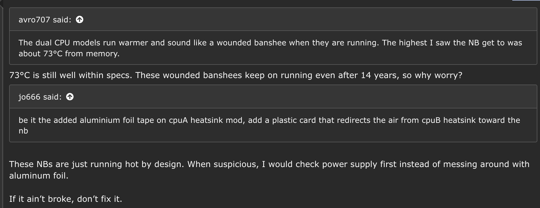

What is temperature is considered “normal” for a dual cpu setup?
My north bridge sits at about 78c
IMHO this scenario is quite easy to avoid by either:
- set the Boost A fan more agressively and the Intake less agressive .
In my setup (both fans at NB diode=sensor and min T=55 maxT= 75 ) the intake is between ~800 and ~ 1200 rpm.
The Boost fan is at ~ 1100 at idle and increases with NB T (and indirectly with the CPU load).
At least in my setup the NB Temp is directly related to the CPU(s) load so both are controlled this way.
Or:
- Intake fan set as above and the Boost fan set to "auto" it will spin at ~1100 at idle and respond to the CPU load as the SMC dictates.
This should keep the CPU A at safe Temps (but we know the way Apple weighs noise vs Temps may lead to high Temps before the fan(s) really ramp up).
If not:
- set Intake to NB diode=sensor as above and Boost A as CPU A= sensor min T= 55 maxT = 80
Based on loads of tests the Exhaust fan can be left to auto (=min rpm) as it mainly adds noise and not lowers significantly any Temp .
For a dual CPU , running at idle, fans all at "auto" and not being in a tropical climate this is more or less "normal" IMO.
Note that the NB heatsink and die should have good thermal contact , indicated by a Delta NB diode vs NB heatsink of ~ 12 Celsius max.
75°C is a common answer. So your machine is ‘normal’. However, most of us having started looking at this weak spot in the design have taken steps to
1. Replace retaining pins
2. Repaste the heatsink
3 clean the heat sink and the fans
4. Put some more ‘modifications’ in place
Here’s my journey.
I run at mid 50°C now
Post in thread 'Cooler Northbridge on The Mac Pro 5,1 Dual CPU'
https://forums.macrumors.com/thread...he-mac-pro-5-1-dual-cpu.2173519/post-28485488
