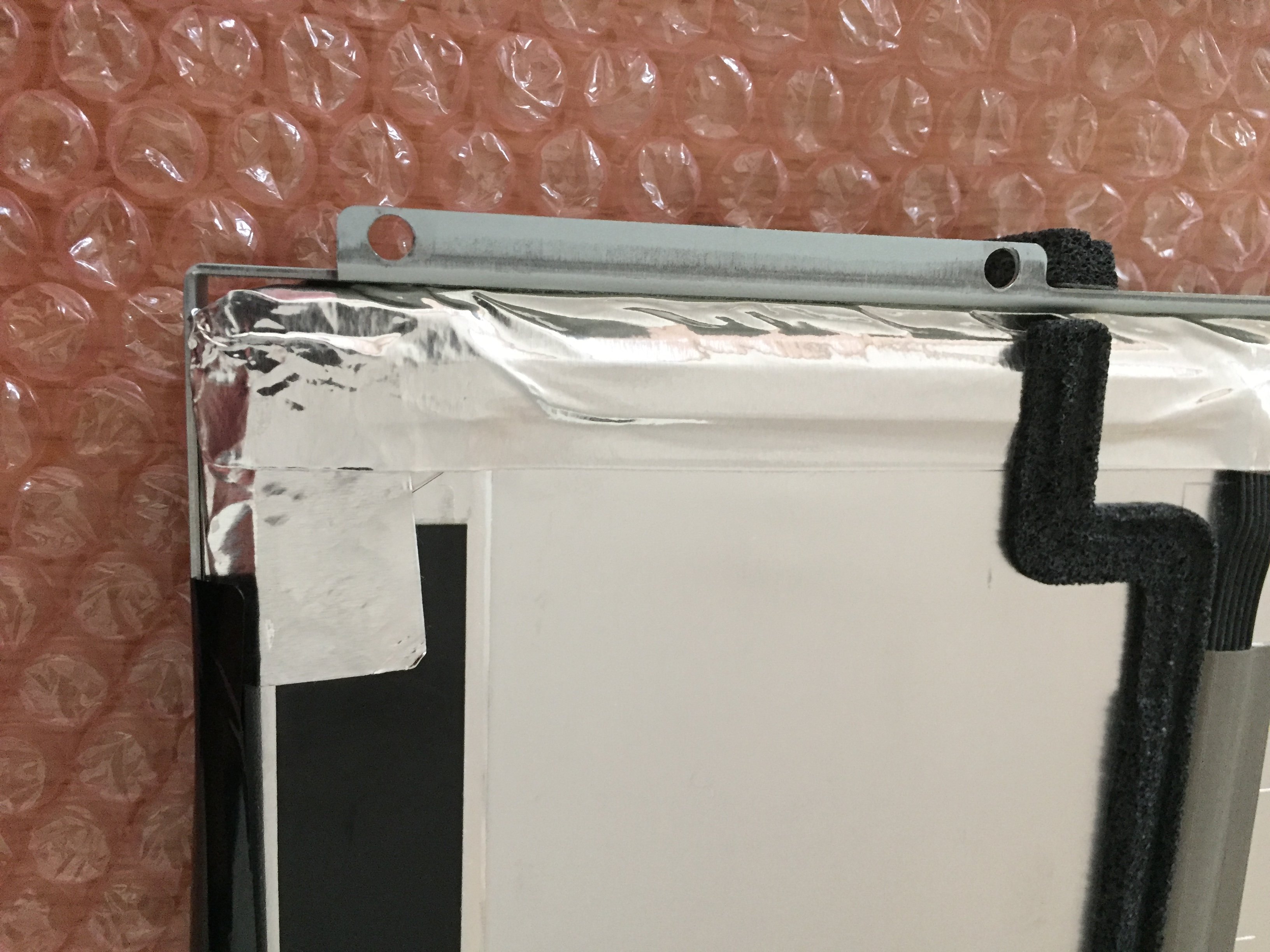

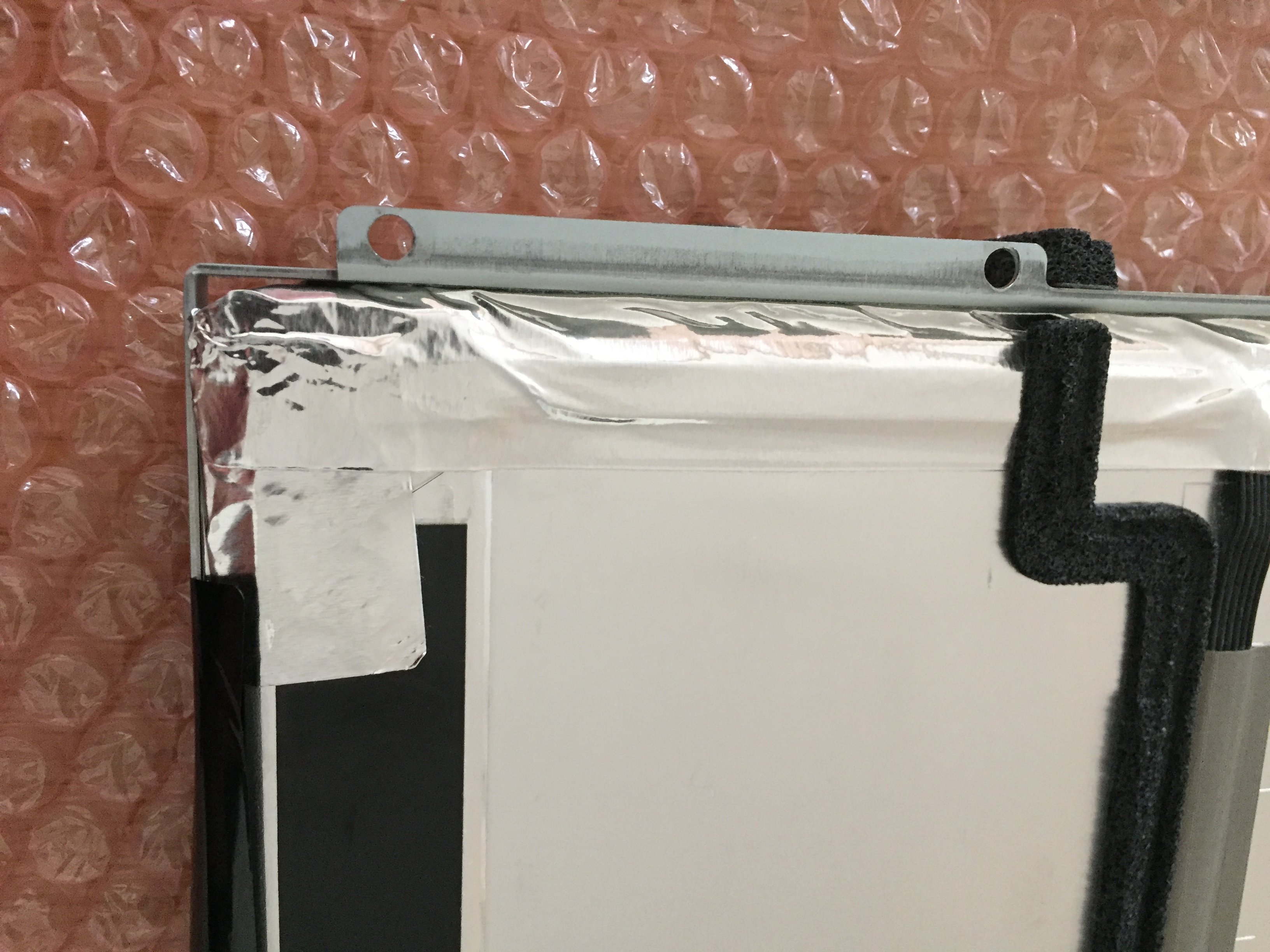

Secondly I had to move all adhesive tapes from old LCD screen to new one except aluminium tape which i didnot had so I am not sure if I am going to get some issues beacuse of lack of aluminium tape on the edges of the LCD screen and loose old adhesive tapes.
Further i had to disassemble frame from the broken LCD panel and this was difficult beacuse the frame is glued on the LCD panel and I banded frame :-(.
Nevertheless to reassemble banded frame with lot off glue on it to the new LCD screen was even more difficult beacuse all magnets had to be aligned with the LCD panel and rear housing of iMac.
After all I have done the jobb and iMac with the new LCD screen and glass is working!!!
I couldn't find the adhesive tapes set for the iMac mid 2010 but aluminium tape is to find.
My question is: Do I have to get some issues without aluminium tape and others loose adhesive tapes from old LCD screen on the new one?
Is it safe to use the iMac without sluminium tape and others loose adhesive tapes?
