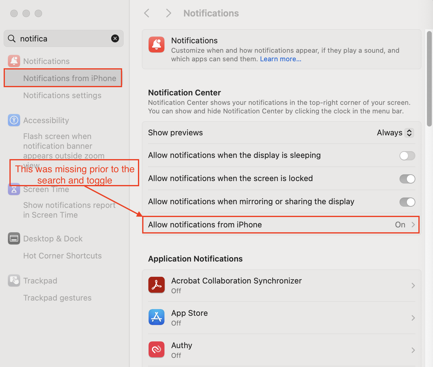

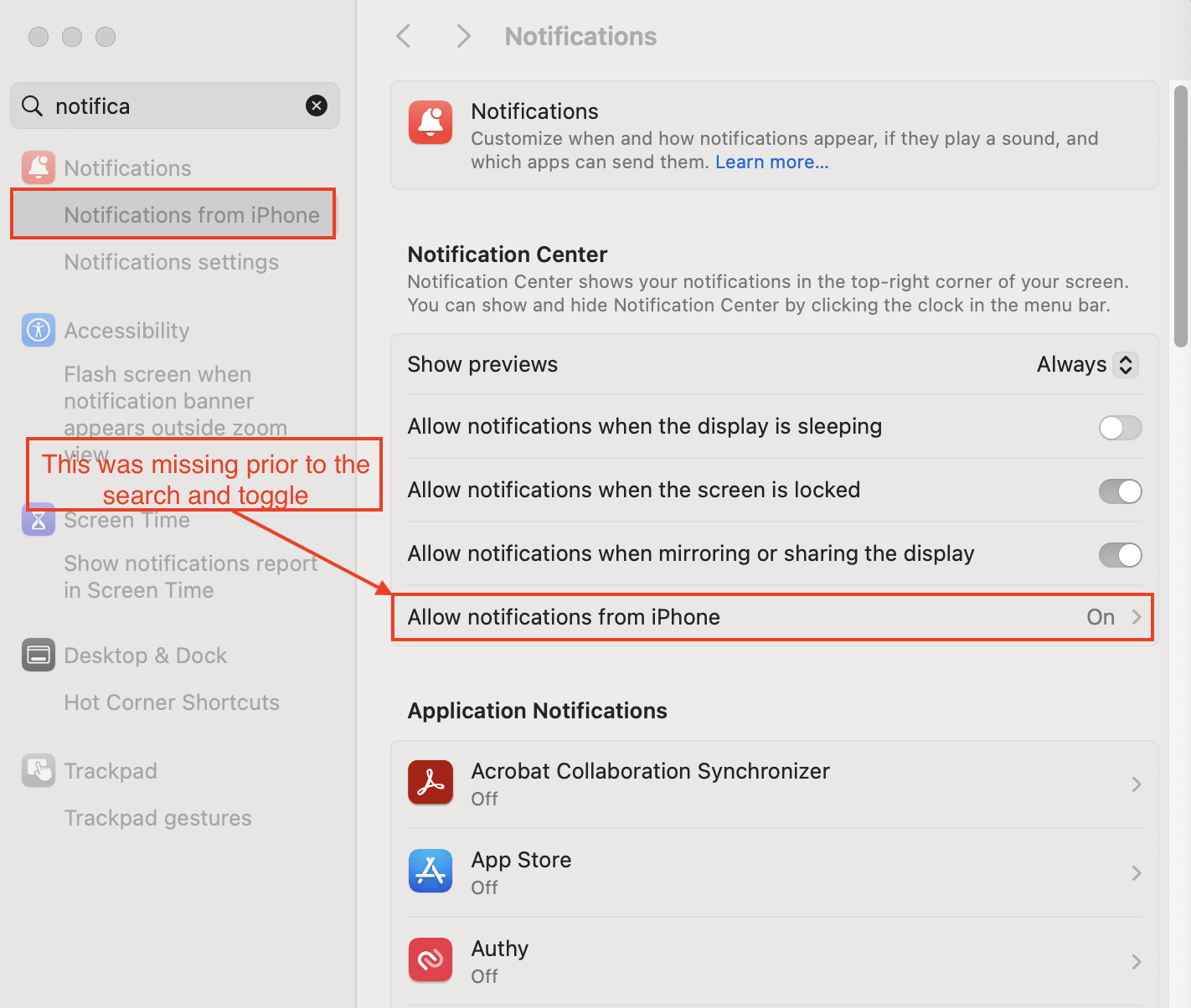

I hope this helps someone else:
I couldn't figure out why I was not getting notifications from my iPhone. Under systems settings>notifications, there was no option to "Allow notifications from iPhone". So I did a search in system settings, found it somehow (I guess the bug is that it is just not appearing, and may be related to migrations as well). I toggled it where search found it, and now it shows under system settings>notifications.
Note: I haven't recieved a notification since doing this, so I am just hoping that it has solved the problem
Sorry to inform you that it is simply part of the same bug. Your hunting it down and turning it on is unfortunately meaningless if you have the same issue as others (including myself) noted above. You'll find that it simply turns itself off again, most likely OR it says it's on but does nothing.
Sorry to inform you that it is simply part of the same bug. Your hunting it down and turning it on is unfortunately meaningless if you have the same issue as others (including myself) noted above. You'll find that it simply turns itself off again, most likelty OR it says it's on but does nothing.

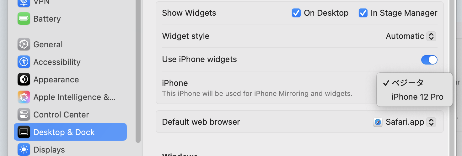

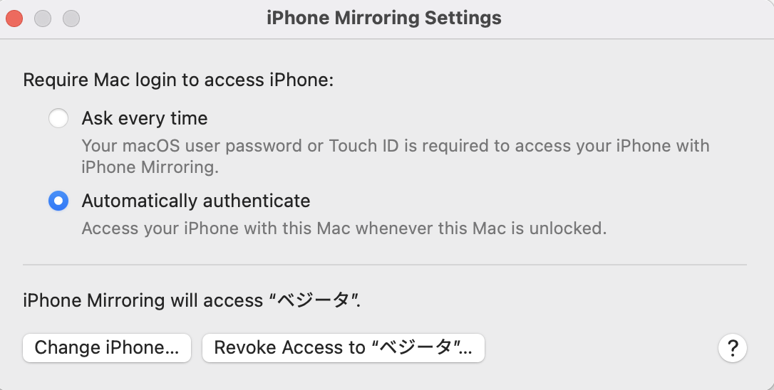

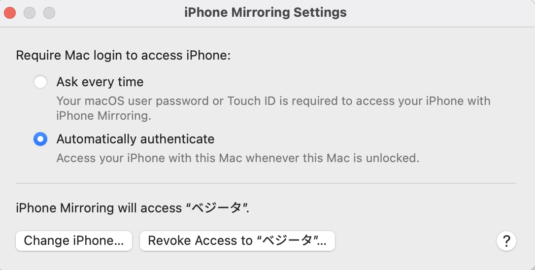

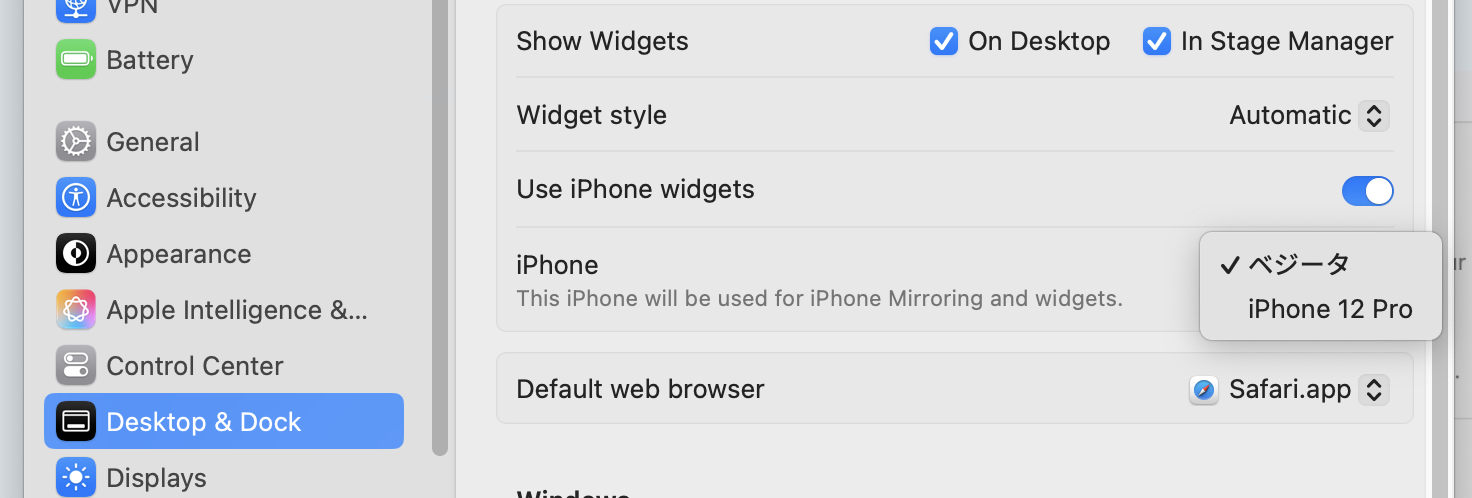

OK. So I stumbled into a possible solution (at least for my two M4 Macbooks) when buying a new phone. It appears that if you "revoke access" and/or add a new iPhone (possibly re-add existing) that notifications will once again work.
This "fix" has stuck for several days on one Macbook, and for a couple of minutes so far on the other. 🤞
Note: it is still buggy (still lists my old iPhone in Desktop & Dock). I suspect the phone must need to be present to fully remove????? I will try later for this.
Reactions: ocdeal
View attachment 2483810View attachment 2483809
Definitely wasn't working for me with the same iPhone, but anything short of having to set up a new Mac user like I had to do is certainly worth trying!
