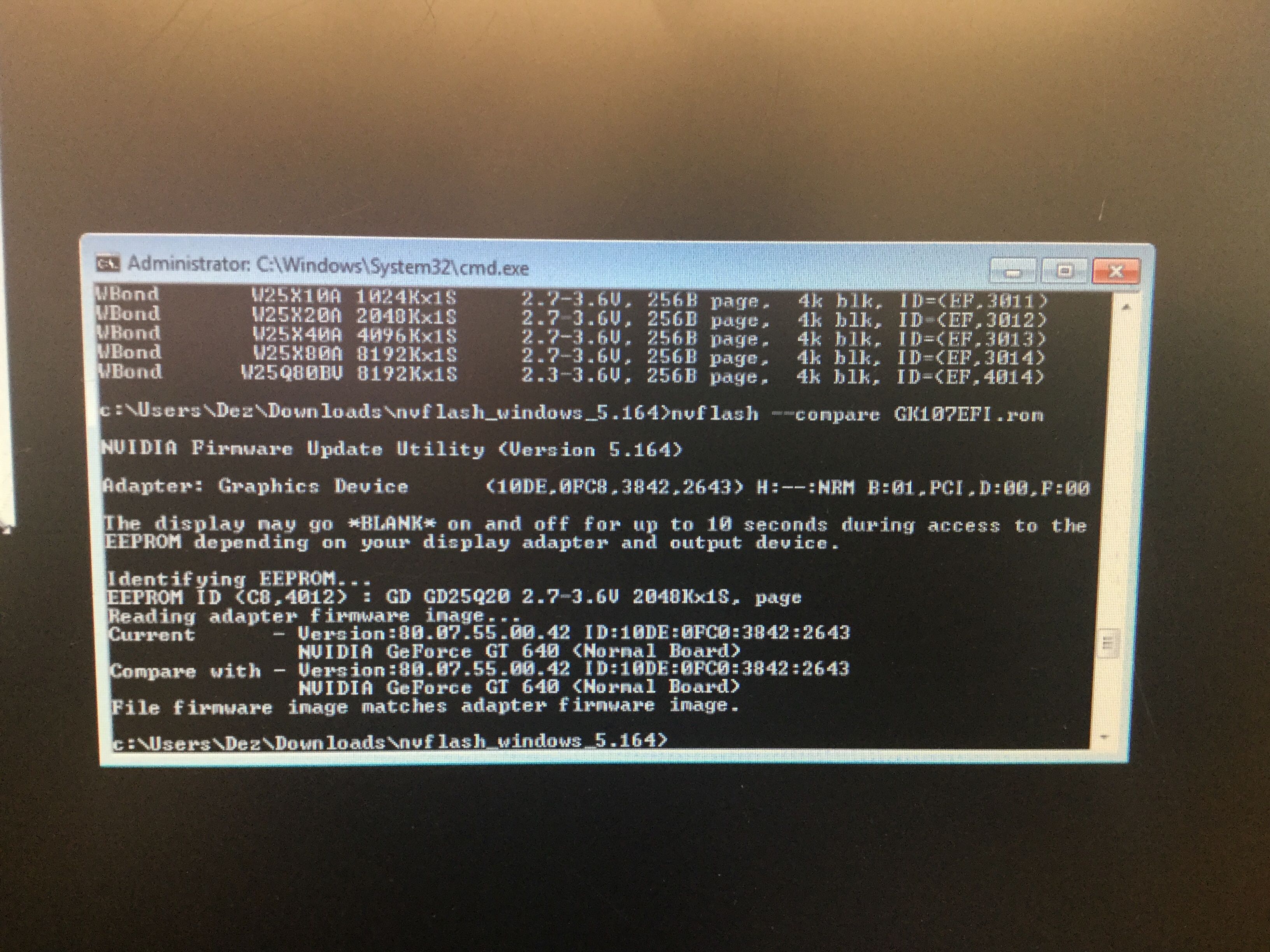

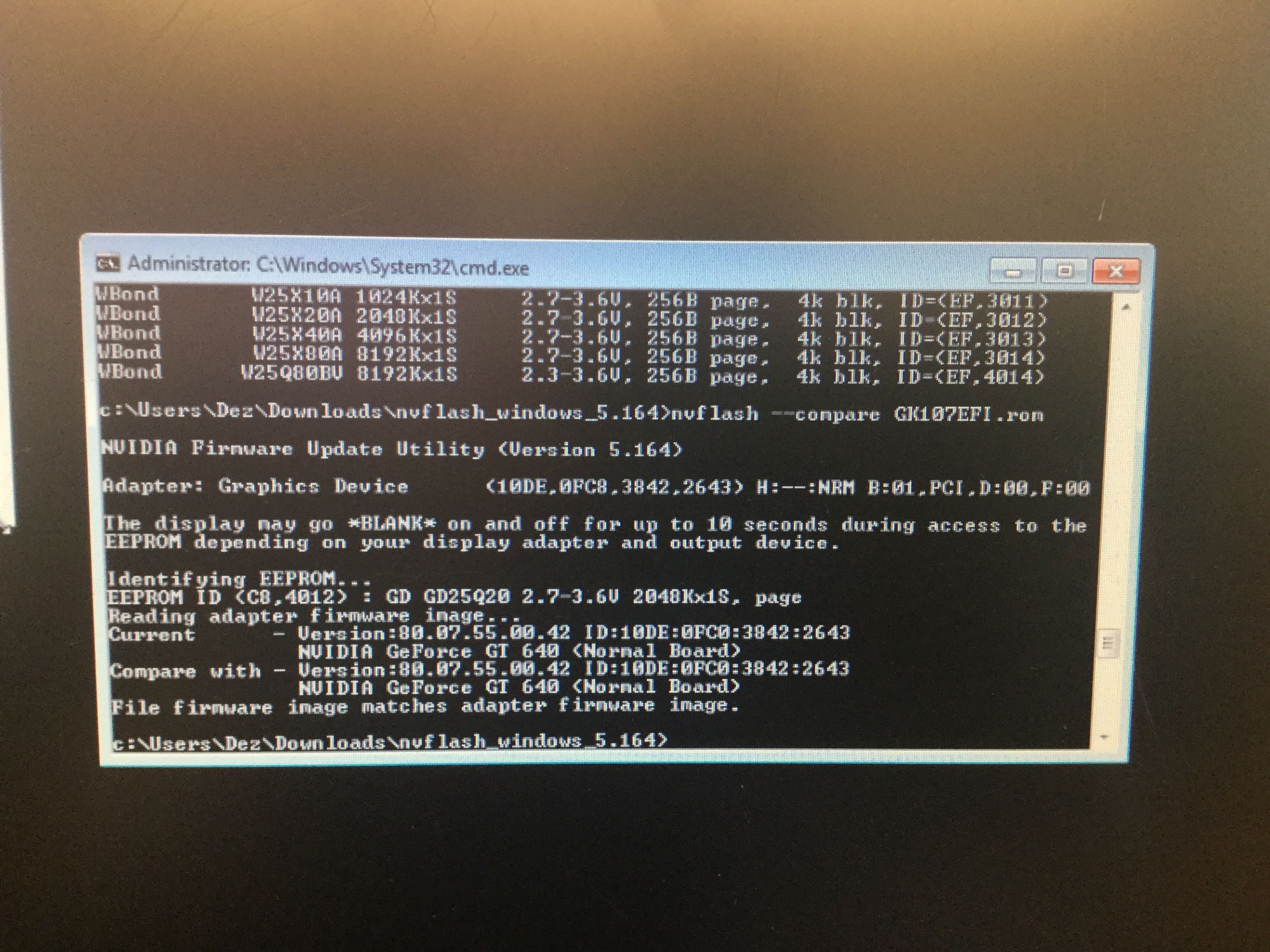

Did you do a comparison of the ROM on the card and the BIOS you used for flashing? Those old versions are funky. They don't throw an error but if you compare both bioses they show difference (in the ID at least)
umm I didn't, dump the ROM again after flashing and compering, but I did try flash again
where NVFLASH showed the ROM had indeed been flashed onto the card
but it still complained about the device ID miss match of course (the Device ID is set by hardware straps, which you can sometimes override in ROM and sometimes you cant, sadly in this case it seems like i cant)
(I see in the zip file of ROMs theres another GT 640 ROM, which ill try at some point for giggles)
but I also see theres EFI32 9500 GT ROM, quite happy about that as I can finally flash my 9500 GT for use in my MacPro1,1 and Xserve1,1 which will be very handy :)
although my 9500 GT is a 512MB GDDR3 card and I think the ROM is for a 1GB DDR2 card if the pictures are anything to by, so it will be interesting to see how that goes

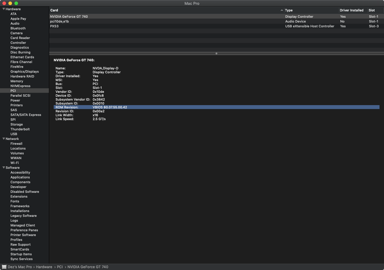

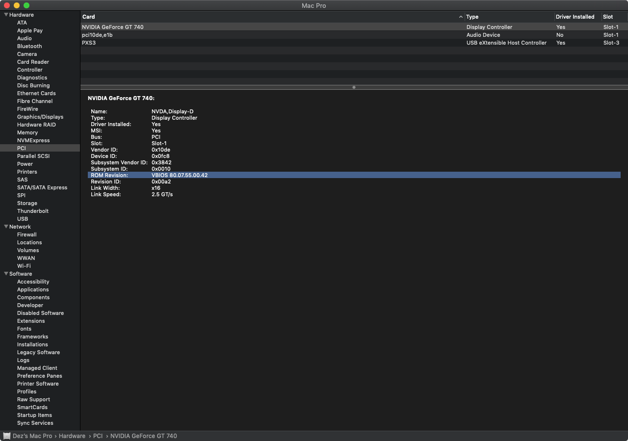

sadly? in my case everything does match up, sadly the ROM wont work because of my GT 740s hard coded Device ID, I wonder if anyone has a GT 740 Mac ROM or knows how to edit a Kepler VBIOS's device ID? :)
the actual legacy VBIOS does not care about the device ID, but it seems like the UEFI or in this case the UGA EFI portion of the Video ROM does care hence why I get no boot screens etc (note that the VBIOS version did change to match the GT 640 ROM, but the device ID did not)

because I dont see how my results proves or disproves that flashing with an external SPI programmer is whats needed, it just proves that the GT 640 ROM wont work on a stock GT 740
as I showed I did a compare, and the ROM on the card matched the GT 640 ROM, so NVFLASH was flashing it properly without modifying it, but as noted it did not work
(probably because of the Device ID hardware straps which you can read about here https://www.eevblog.com/forum/chat/hacking-nvidia-cards-into-their-professional-counterparts/ )
